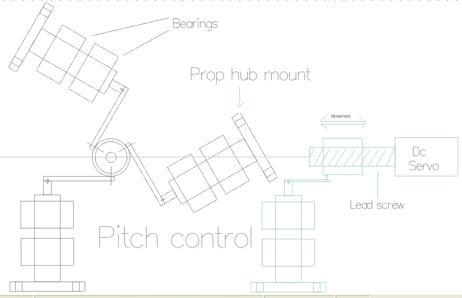

I'm really stuck on this idea , cant get it out of my head.
http://www.otherpower.com/images/scimages/2965/pitch_control.GIF
the servo could be PIC controlled and powered by a small set of spinning coils rotating against a fixed set of magnets .
i got the idea for the connections to the blades ,from the picture below .but i've added a third blade. thoughts?
Flux i would really like to see a photo of your pitch control mechinism.

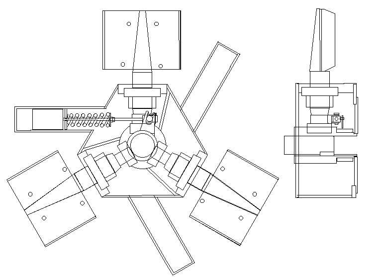

I didn't take any photos of mine, but I did save an early drawing that will give you some idea but it will be difficult to follow the mechanism to synchronise the blades without knowing something of the Elektro hub that I based it on.
Should be details on the net of Jacobs, Dunlite, Aerowatt and similar ideas, many tried it.
Not sure how it will come out on the screen but if you look in my files you can find it as a gif or jpg and if you load them and look at it bigger it should be ok.

I see how that works, although they use three actuators..  when all you really need is one..

How do the blades pivot ?
How does pulling on the blades change the pitch?
is there a wire in the blades? are they hollow?
sorry for so many questions.
« Last Edit: January 11, 2006, 08:12:36 PM by willib »

  It has a steel rod through the center of the blade, cast into the composit.  Both ends of the steel insert has a 90 deg bend, the motor uses the lever to pull or push on one end of the steel arm which inturn twists the outer 90 flexing the blade to change pitch.

willib, if you are referring to my drawing, the things that you think are actuators are just weights. They look like pistons on the drawing but the thing is weight operated, there is no active servo.
« Last Edit: January 12, 2006, 01:38:24 PM by Flux »
Re: Pitch control diagram
« Reply #12 on: January 12, 2006, 03:33:58 PM »
Yeah i see that now , thanks
