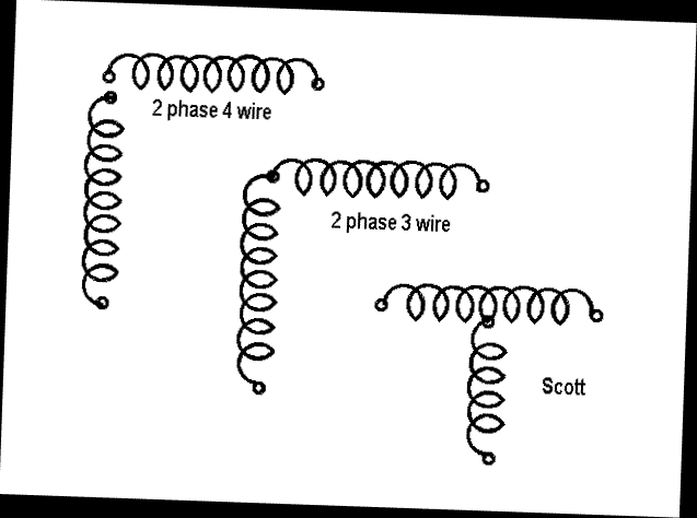

Can someone direct me to some more information on the Scott T connections for a 2-Ph alternator.
Or is it just connecting both phases to their own bridge, and joining one AC connection of one bridge to one AC connection of the other bridge?
« Last Edit: January 16, 2006, 08:21:28 AM by ghurd »
Re: Simplified star - delta switch
« Reply #8 on: January 16, 2006, 08:49:40 AM »
I wouldn't get too excited about this, The Scott connection is a way of converting from 2 phase to 3 phase or vice versa.
One winding of the 2 phase is centre tapped and the other phase has one end joined to this centre tap. To work properly the windings have to have a ratio of 1: root3/2
This will give a balanced 3 phase. It was commonly used as a bodge to run a 3 phase motor on 2 phase and in that case none of the ratios work properly and it is not balanced but it worked well enough.
Two phase can be rectified with 2 single phase bridge rectifiers or one end of the 2 phases can be commoned and this and the other 2 ends fed to a 3 phase bridge, it saves 2 diodes and seems to have the same effect. If the commoned point is removed from the rectifier, the thing operates as single phase with the 2 phases 90 deg apart as compared with 3 phase with one lead missing where the single phase vector angle is 120 deg.
If the winding was wound for the true Scott ratios then it should work with the rectifier as true 3 phase ignoring the common ( star) point.
Seems to me that you use 2 phase warts and all or make it true 3 phase.

what about a simple wire diagram...:]
« Last Edit: January 17, 2006, 03:53:12 AM by hiker »
« Reply #12 on: January 17, 2006, 04:47:26 AM »
See if this helps.
4 wire needs 2 single phase bridges, the other 2 can use a 3 phase bridge.  Ignore the star point on the Scott
« Last Edit: January 17, 2006, 04:47:26 AM by Flux »
