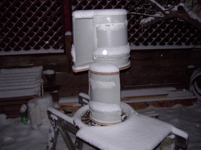

I been kinda thinking about making a small
savonius one that would look real nice easy to
make...maybe cut a few plastic coffee cans in
half lengthways, put the tops together end to end
tape the seam together with some nice white
duct tape, so with that in mind...done that to
6 cans taped them together. Then should I overlap
them about 1/2 way?...just a 1/3 ? Put it on the
shelf for a couple of weeks ...months... then
yesterday or so fixed the neighbors little
ornamental windmill (3ft. on an 8 foot tower....
sitting out on his front lawn...
  I guess he only tied it down with one stake
   Spinning real nice and purty !
......Gee Whiz...I just gotta get somethin
spinnin !...I know ...I got those coffee cans
...that square pole doesn't have to be round..
I'll just take it, round the edges, paint it,
screw some bolts in the end going thru bearings,
screw some of those cans on the side of the pole
after I get it painted so everything will look
real nice....well that's how my day went....
planed the two square edges of the sawed in half
lengthwise 2x4, sanded it ....fantasy of a 2or3
kw mill..in everyonce in awhile for coffee and
warm up my feet....
   Neighbors little mill quit spinnin'
after the tower tipped over...(maybe he
should have had 2 stakes to hold it down ??)
  Well it was getting late so you know what
usually happens....slapped it all together....
put a little pin and screw in top and bottom
a la Picoturbine and it worked and took a pic of
it in the shed and wrote this post...so here 'tis
   Had it spinning about 200 rpm. planning on
using a front fork and bearings from a bicycle
to support it....then put it to work maybe charge
a 4 amp/hr battery to light up a few night
lights ?
   According to my combination water and sewer
bill if I had a windmill that could pump about
an average of 10 gal.of water an hr. I could save
$60 a month ...etc.
                   ( :>) Norm
BTW Cans represent about $40 or so worth of coffee.

Looks like fun Norm. If you had an old dowel or broom/shovel handle sitting around you could use that and offset every row under the 90 ­degrees you have now, making it look more like a helix and probably get more power out of it and also get away from any surges.

If the bike wheel is part of the device, some of that 'linked' type fan belt will ride where the tire was, making a very high speed output to a alternator pulley.

Humor me, take the stepper off that DC motor, hook this onto a bike wheel , use the rubber tire on the wheel to spin the DC motor and see what kinda output you get.

  Well for now I'll just use the bicycle wheel....rubber band tensioner to hold the motor drum against the bike tire?

I'm wondering if you would get better torque with the mags spaced 45 degrees instead of 90.

They sure are easy mills eh Chris? This one is a 50% overlap and I have the plywood cut for a 25% overlap, just need to cut and mount the buckets so I can do a side by side comparison. It sure goes against the grain though, cutting a perfectly good bucket in half!
