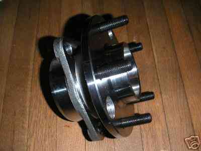

« Reply #9 on: January 29, 2006, 08:04:07 PM »
 this is what i was thinking about , you can see the spline in front , and the mountin the back .what really kills me is i could have got one with the spline hole when i got the one i have ,if i was thinking about doing this,at the time..
flux, being sealed units these are pretty tight, and the forces on it wont be that
great any way .
i just need something to spin and hold the parts at the same time
« Last Edit: January 29, 2006, 08:04:07 PM by willib »

Re: Making a lathe
« Reply #12 on: January 29, 2006, 10:02:29 PM »
The one in the pic is $85 on ebay but i have seen them in the $40 dollar range for brand new ones..
this is a link to the list , scroll down the page to the less expensive ones..
if you do your own search be sure to just look in ebay motors ,for' wheel hub bearing', otherwise you get a lot of other stuff in your search..
http://search.ebay.com/wheel-hub-bearing_eBay-Motors_W0QQcatrefZC6QQcoactionZcompareQQcoentrypageZse
archQQcopagenumZ1QQfromZR10QQfsooZ2QQfsopZ3QQftrtZ1QQftrvZ1QQmppfqyZwheelQ20hubQ20bearingQQsacatZ600
0QQsaprchiZQQsaprcloZQQsbrsrtZd

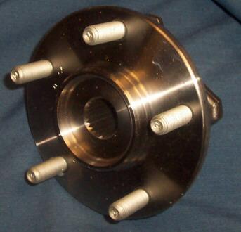

Re: Making a lathe
« Reply #23 on: February 05, 2006, 11:09:56 AM »
Thanks , great explaination and timely too..as i just recieved my new Hub on friday!!
this is the ebay pic of it.. its brandy spanking new.. lol
« Last Edit: February 05, 2006, 11:09:56 AM by willib »
