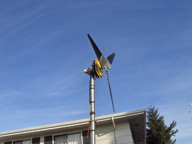

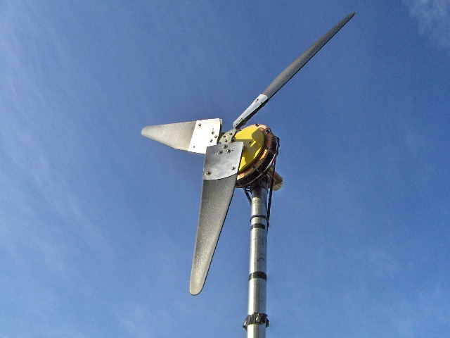

This has been a fun project. Allthough way more time consuming then a motor conversion.
The goal of this project was to gain knoledge on the dual rotor desing and find a alt desing that would have a symular power curve as the Garbogen.
The Garbogen does a couple amps at 5 to 7 mph and hits 650 watts at near 30 mph. It also has my 49" 3 blade Jerry blades.
This dual rotor disc alt is 8" with small wedge NEOs. Paterned some what after EDs kit 8".
I think Ed sugjest a 7ft blade and it has larger magnets. For this reason there was no reason to expect this genny to come close to Eds rated 500 watts.
There are a couple things in my 8" alt that is not done as standard practice. I didn't go totaly by the book.
1 this was to wind my coils of 22 ga. wire and at 250 turns per coil. Next I did not use either the accepted or standard delta or star 3 phase conection.
I used a fullwave bridge rectifier per coil. Each coil has its own (9 each 6 amp bridges). Then all the DC outputs of these bridges are wired in perelell.

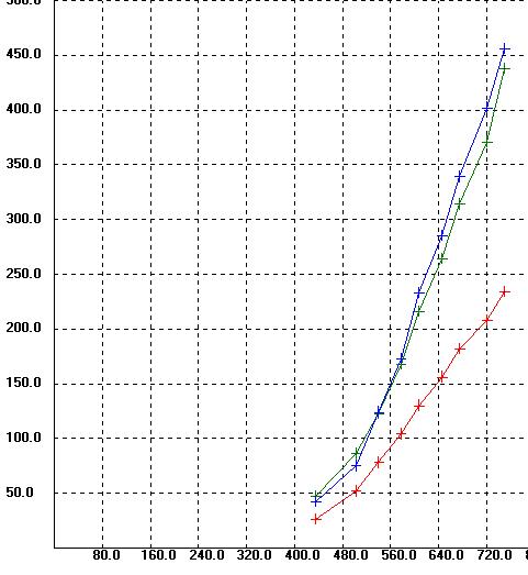

With a spin of the hand I can get around 18 volts no load dc. On the lathe at 500 rpm 44 volts no load.

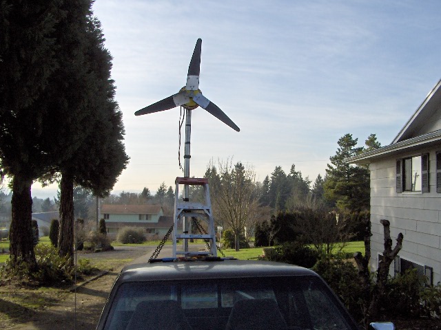

On to the wind test. I new from lathe testing that this genny is best suited for 24 volt use.
But I did a 12 volt wind test anyway. I had to go 30 mph to even get 10 amps at 12.6 volts. It seemed as though the brakes were on the blades just wouldn't spin up. Bad blade stall. This was disapointing, I thought it might do better with a blade then it did on the lathe?
However the 24 volt lathe test yeilded 283 watts at around 400 rpm and I knew my 49" blades had done 650 watts at 500 rpm.
So I rewire the 2 new Optima red to batteries in sires and went back out on the hiway for a 24 volt test of this genny.
What a diferance. At the turn around point I had stoped the truck, I was hearing a sizeling sound, I got worried, I didn't smell smoke? I came to find the Optimas were complaining about the 35 amps and 35 volts I just put to them for a short time.
Heres the mph and watt figures.
  5 mph....36.75 watts.
 10 mph...130  watts.
 15 mph...280  watts.
 20 mph...450  watts.
 30 mph...726  watts.
 35 mph..1020  watts.
 40 mph..1225  watts.
I couldn't belive what (watts) I was seeing. I never thought this littel genny with these littel blades would come any where close to these #s.
My thoughts were I build this littel 400 watt genny then biuld a larger version to equal the Garbogen specs but this littel unit follows it very well and even a littel better.
Its surprizing to see these #s from a 49" blade? But I'm luvin it.

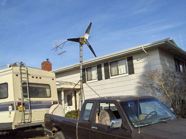

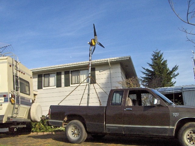

Here a few pix. Hope you don't mind. I'm just rather excited.

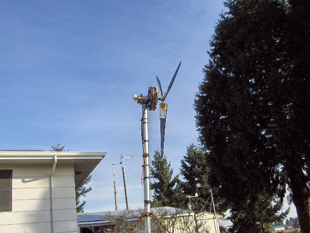

You can see from the pix the blade is shaft mounted about 3" in front of the rotor.
That close proximety worried me some what. The root of the blades are only 3" apart. I thought that closeness to a 10" stator just a few inches behind the blade might have a bad effect on the root portion of the blade. Gues I was wrong. The blades are 23 degrees at the root and just a few degrees at the tip.
Another thing surprized me. At 1 point I thought the blades went missing. I stuck my head out the window while driving just to see if they were still there. They were extreamly quiet. Even more then normal for these very quite blades.
Also after returning from a 1200 watt test with the Garbogen(motor conversion) it is quite hot. On my return from testing this littel dual rotor 8" at 1225 watts the stator and coils were stone could. However after doing the math each coil was doing less then 4 amps (3.8888a) each and the same for each 6 amp bridge.
I figure I'd have to see around 1620 watts befor things start to heat up. That 6 amps per coil and bridge at 30 volts.

I guess Im puzzled.  Not sure how you are measuring the output but you are reporting outputs that seem to be impossible for a 49 inch prop.  See my comments beside your numbers.
  5 mph....36.75 watts.    Betz limit: 5.0 W, you get 7X higher?
 10 mph...130  watts.      Betz limit: 40W, you get 3.25X higher
 15 mph...280  watts.      Betz limit: 136 W, you get 2 X higher
 20 mph...450  watts.      Betz limit 323 W, you get 1.4 X
 30 mph...726  watts.      Betz limit 1089 W, your number is high but possible if
                           your alternator is running 95% effecient which Im sure
                           its not.
 35 mph..1020  watts.      Betz limit 1730 W your number still high but possible.
 40 mph..1225  watts.      Betz limit 2582 W, your number possible
As you can see there is something wrong especially below 35 mph.  Not only do you exceed Betz substantially but Im sure your alternator is not more than 100% effecient.  Maybe the speedometer on your pickup is way off (reading 5 to 6 mph lower than real speed makes the numbers make more sense) or something else is wrong.  And by the way in theory rectifying each output individually then adding in parallel cannot be as effecient as a Wye connected 3 phase unit with the same number of magents and same coils used.
Nice looking unit, but you might want to check out your speedometer, you might get a speeding ticket in a school zone.

It could be a speedometer issue - it could also be the fact that the machine is mounted in the back of the truck, maybe the air over the top of the truck is moving a bit faster - or it's denser (or both)...

Part of these discrepancies may be due to the effect of the truck cab on the airflow.  Most people don't realize it, but the air disturbance that an object creates actually extends a considerable distance (many multiples of its basic dimension) from the object.  The air passing over the windshield and cab is sped up.  This effect can extend quite a distance above the truck as this speed up drops off relatively slowly with distance.  Because of the truck's complex shape it also could vary with the speed of the truck.  Those wishing to use a vehicle to test their wind mills should mount the mill in the front of the vehicle so as to guarantee a uniform air flow at the vehicles speed past the prop.
One effect of the fast moving air coming off of the cab of the truck is to cause a vortex to appear over the box of the truck.  This will then affect the air flow over the wind mill.

Even a small head-wind would account for the discrepancy.  You could increase the confidence in your figures if, the next time you truck-test, you drive in multiple directions.  Take the average between, say, 20mph northbound and southbound.

Testing in both directions helps rule out local wind speed boost.
Wind turbine needs to be above the influence of the vehicle.
Measure the wind speed without turbine, find how high up to remove vehicle influence.
Measure wind speed just before going into wind turbine, many simple devices around. Any body that built that beautiful turbine can build one.

Hi Dan B.
Yes I noticed during installation of this genny on the mast in the truck that the blade started turning even though it was off axis to the wind. There is a lot of weight in a dual rotor but the startup is very easy.

Re: Jerry's new dual rotor wind test.
« Reply #22 on: February 09, 2006, 09:36:28 PM »
Thanks to every one who has responded to this story. I do appriciate all the input.
The purpuse of this test was ofcourse to learn something. All the great input also helps in the learning prosses.
Also the purpuse of this test was to see a compairison of the Garbogens wind/truck test results to the exact same test proceedure of a small dual rotor with the same blades.
I do agree that my test results do not reflect a real world or tower mounted preformance.
But I did what I set out to do. and that was to compair 2 diferant alternator designs with the same blade and same conditions.
I have room at my store for both of these machines to be tower mounted at the same hight and load.
This should show real world results and a good side by side compairison.
Even with the very flawed testing I did not expect the #s I was seeing from this littel dual rotor. I thought I would have to build at least a 10" dual rotor with larger magnets?
I concur that my location of the genny on the mast in the truck bed is subject to increased wind speed over the windshield and cab. Also the varying prevailing winds through things off conciderble.
However the Garbogen was tested under the same conditions.
I posted last year about building a wind tunnel. I still want to do this for more acurate testing but that is still some time out.
To respond directly to a few of you. Hiker yes it is still 3 phase. There are still 12 magnets per rotor and still 9 coils.

Electrondaddy1 yes this is the same test truck I've allways used. Not sure if theres an improvement with my coil diode scheem but I'm convinced its better than either delta or star. I intend to go into great detail on this subject on another post or diary.
Flux as usual you are right on. As you pointed out this was a compairison of 2 alt under the same conditions.

Here are some results of a test I did several years ago.
Red is output, green is input for delta, blue is input with individual rectifiers.
Hope the gif works.
X axis is rpm  y axis is watts.
I didn't persue it at the time, seemed near enough to be within experimental error.
Both worse than star, but I dont't have a direct comparison with the 1.73: change in turns needed to be fair.
form your own opinion, I'm with Dan on this.
« Last Edit: February 10, 2006, 11:32:11 AM by Flux »
« Reply #27 on: February 10, 2006, 11:34:37 AM »
Sorry, my mistake, lets be fair to the thing, blue and green should be reversed from what I said.
« Last Edit: February 10, 2006, 11:34:37 AM by Flux »
