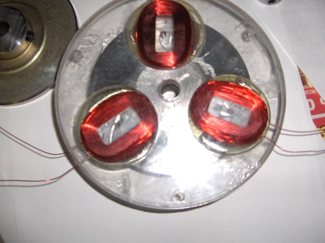

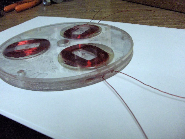

I wound 3 coils 200 turns of # 24 gage wire. I placed them in the stator and glued them inplace with epoxi.
I also wound a 100 turn coil of 21 gage wire. Its surprizing how much larger 21ga. is then 24 ga.
It was dificult to get the 21 ga. coil to fit the same hole as 24 ga. but I think I can make it fit.
Heres a few pix of the first test alt stator. 2 more test stators to build.
You can see the wires come out some small holes I've drilled in the side of the plexi stator forms.
The glue is still wet. I'll take the clamps off tommorow and take another picture then.

"The glue is still wet. I'll take the clamps off tommorow and take another picture then."
It seems many on this board are stuck on epoxy. Not criticizing but just wondering why more people don't weld when using plexiglas and acrylic. I use to prototype with plexiglas quite a bit and love the near instantaneous bond and clean look.

Hi Zap.
Sorry about the epoxi thing. Unfortunetly I have very littel knowledge of plexi or other plastics in terms of fabrication or bonding.
I wanted to build a small test alt in a short time. This littel unit is only for testing and not for outdoor or long term use.
So I've simply used materials and skills at hand that would make this littel project hapen as soon as posable.
If you could expand or elabirate on plastic welding this information would be very usefull in future projects use plastics.
Thanks for shareing the knowledge.

The first stator (#1). is done. Now to wind and glue the other 2.
The center hole in these coils are the same size as the mangets. I now there has been some discsion on coil center holes relitive to magnet size latley but I think this sizing is acceptable.
Heres 2 pix of stator #1.

Jerry I apologize, like I said I wasn't criticizing by any means and I apologize for taking attention away from you ongoing experiments. Your workmanship always comes across as very professional and make mine look like child's play. Most of my projects would be deemed unacceptable for the Red Green show.
Solvent welding basically dissolves a little of each piece being joined, the polymer chains mix together, the solvent evaporates and the polymer chains stay mixed together.  If you've every glued PVC pipe together then you've done solvent welding.  For plexiglass, styrene and ABS something like Ambroid PROWELD http://www.ambroid.com/Ambroid.html#110 will produce a bond just slightly slower than superglue.  I think I got my last bottle for $3 and unless you leave the cap off, it lasts and goes a long way.  A plus is the ability to fix many plastic items and sometimes have the repair barely visible.
Hobby and Craft stores usually carry some type of plastic welder also many sign shops carry similar products although the sign shops I've approached usually charge an arm and leg for the stuff.

I wound the second stator today. Its the 21 ga. twice the circular mills of the 24 gage.
I was able to get the 116 turns you've sugjected out of the 21 gage. You sugjested 21.5 gage and since thats hard to find I thought I'd try to get the 116 turns with the 21 gage and it was tight but the stator is cast and all look well.
I think using the 21 ga. rather than the 21.5 will be a benifite to the star stator.
Help its amperage out a bit.
I may still wind the 100 turn 21 gage stator. 100 turns should be the exact amount copper as 200 turns of 24 ga. So those 2 stators would have the same amount of copper.
116 turns of 21 gage I think will have a slight edge ( handycap, cruch, head start , cheat) or what ever you want to call it.
Just another thought here. there has been some discusion here about the isues of blade and requiered touqure and such.
At this point I'm not concerned with the blade only the alt.
My disire is to achive the highest power output of the magnets, copper and space I have available.
After the alt is maximized and power data harvested then the blade will be designed to acomidate such an alternator.
I know wind speed is also part of the equasion but so is an alt that doesn't  waist magnetic flux and copper and coils not delivering all the power there capable of.
