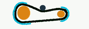

« Reply #7 on: February 24, 2006, 08:37:40 PM »
NTL, I disagree with the ones that say there is
a small amount of wear,
 If designed properly ...
when the idler pulley isn't tightening the belt
slips into the c-shaped parts surrounding both
pulleys  something like this  BR>
 A little bit exagerated but basically it works
like that.and the belts aren't touching the
moving pulley...of course the other pulley
doesn't really matter but when adjusted properly
all belt driven lawn mowers are designed this
way ...
            ( :>) Norm.

Thanks, that drawing is kinda how I had it figured also.
Another thing with this type system that I dought I would try, at least not right now, is a way to change the ratios. I never can remember what the pullies are called, but it is variable, like 2 pullies together but the center section slides. So when pulled towards one pulley that belt loosens and the other belt tightens, this causes one belt to ride higher in the groove and makes a larger pulley basically while the other belt rides lower and makes a smaller pulley. Those require 2 shorter belts and more work to set up. But this variable pully is used to change the ratio between the engine and the rearend on some mowers. I don't think that is real common, but I have 2 junk Craftman mowers here that use that varible pulley as the way to drive faster or slower without changing engine speed.
Another way can also be setup sort of like a ten speed bike. An idler pulley on spring tension and a type of derailer to guide the belt. Slide it one way to get a larger pulley on the engine and smaller on the DC motor, or slide the other way for smaller pulley on engine and larger on DC motor.
Either of the two systems would let you choose between a ratio best for idling rpms or for highway speed rpms. The advantage is you could spin the motor faster at low rpm when idling if you needed to charge batteries while parked remotely, then change ratio to prevent over speeding it at 60mph rpms when driving and charging.
Dis-advantage, more to break and alot harder to setup correctly.
 I won't be doing that myself, at least not now. Far to many other things to do, but it could be done either way.

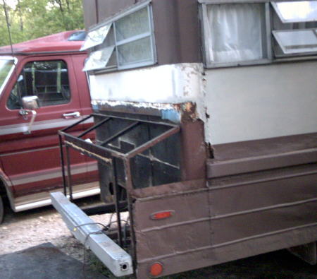

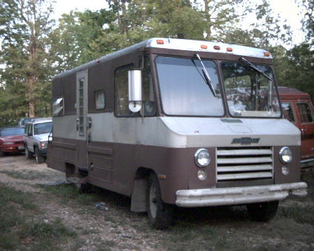

« Reply #12 on: April 22, 2006, 01:19:49 AM »
Well I had lots of things keeping me tied up and slowed down.
Here's a couple pics of the Old 66 Chevy I am working on.
Had to take off the rear add on section so I can put a hitch on it. Only 2' square tubing from the body to the bumper. I would not trust just that for towing a trailer and car. Once I rebuild the rear section the propane tank goes back in and that's where the batteries will be for a 24V system. As I rebuild the rear I will also run 2" tubing or 2" pipe across the back at the lower body for tower base mounts. I have a couple things in mind, not certain which way I will build it yet. I also plan a pipe rack on top for storage and hauling extra stuff. I will fly 2 small gennies on the rear.
