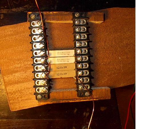

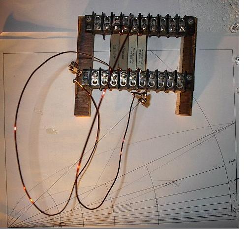

mini dump
« Reply #6 on: March 01, 2006, 07:48:16 PM »
its funny , i had just built a similar device , although its alot smaller !
http://www.otherpower.com/images/scimages/2965/resistor_bank_2.JPG 55KB
http://www.otherpower.com/images/scimages/2965/resistor_bank.JPG 43KB
i needed a  low resistance load , this one is 0.25 ohms .
made from four 1 ohm resistors  connected by some # 17 wire.
do you know the resistance of you dump load?
i suppose it would work well as a water heater..

Re: mini dump
« Reply #7 on: March 02, 2006, 02:59:50 AM »
Thanks willib, going by the figures above I'd say a tad under 0.1 Ohm (~12v/130A=0.092 Ohm)
