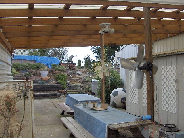

I was able to do a few wind tests today. First My grand daughter and I tested her small science fair dual rotor. This Is the alt with 2 stators. One stator (delta jerry riged) is wound with 200 turns #24 gage and the other stator is wound with 116 turns of #21 gage (star with extra helper turns).
I also tested the 6 pole 3 coil, 3 phase motor conversion test alt.

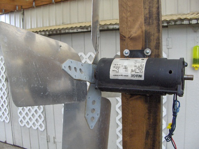

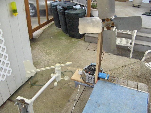

I used a 2.5 hp tredmill motor with a 24" air mover blade to provide the wind. The tremill motor gets its DC power from a fullwave bridge of 4 25 amp top hat stud type diodes mounted on a heat sink. To smooth the DC  a 3,000UF/350 volt electrolytic cap is used.

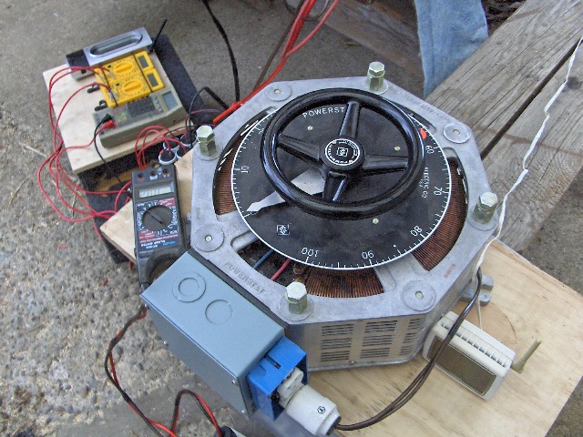

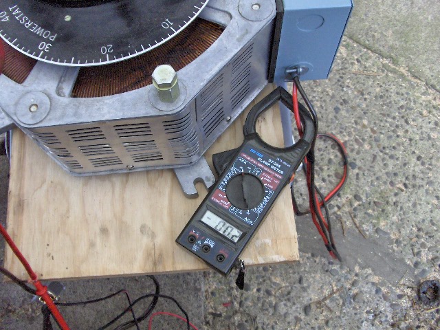

AC is supplied to this doide package from a 4,000 watt, 120 volt variac. The variac provides 0 to 140 VAC.

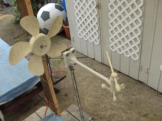

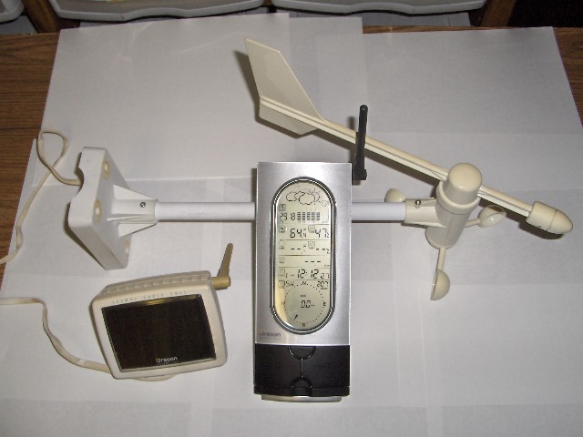

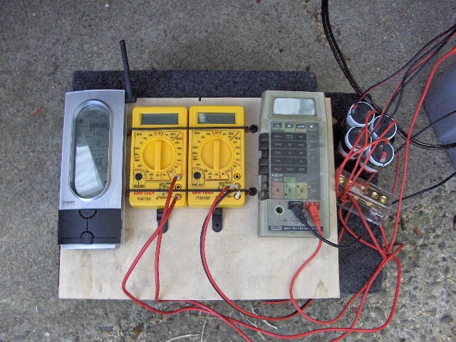

I'm useing an Oregon Scientific amamometer for wind speed measurement. Voltage and amperage are tracked by a Fluke true rms meter plus 2 small HF meters for voltage and amperage readings.
Heres the anamometer.
Here are the meters and the small batteries used for the small dual rotor disc alt.
Here is the variac and an AC clamp on amp meter to track amps going in.

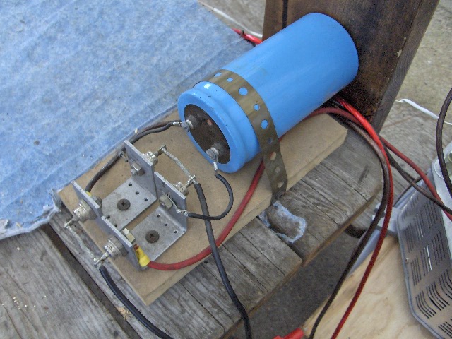

Here is the diode group and cap.
Heres another shot of the variac, meters and the anamometer transmiter.
Heres were all the wind comes from, tredmill motor and blade.

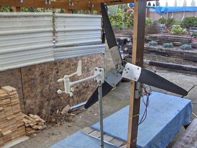

I tried several blades on the small disc alt. This blade from a 20" box fan was the only one fast enough for any measureable output. You also see the amamometers wind cups sensore generater thingy.
This is looking the other direction.
Heres a glimps of the covered area. Its sorta walled in on the sides as well as a roof. Its a fairly closed in area accept for the wind entrance and exit.

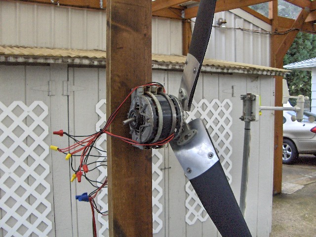

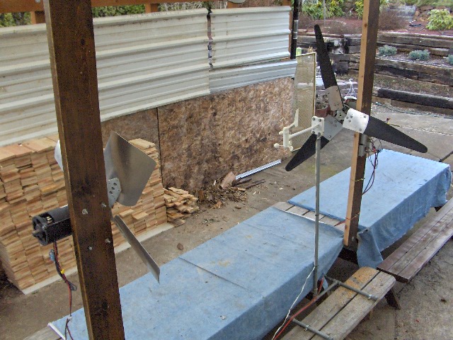

Now time to test the 6 pole, 3 coil, 3 phase ac motor conversion. This is the back side. I'm using 49" 3 blade, Jerry blade on this one.
This is from the front side.
Heres the complete setup.

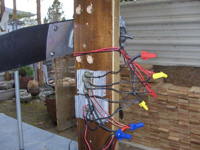

Here are the doide groups for either star or delta/jerry riged conection.

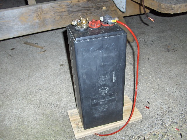

Here is the large 2 volt cell I used on the 6 pole 3 phase alt. It measures 5"X6"X15" and its real heavy. During all the testing this battery went from cold 2.05 volts to 2.15 volts. Its a big load for these small amp readings so it was a vary stable test load.
Test #s on the small disc alt. I could only get a good reading at a littel over 20 mph on this one. Things were starting to shake abit.
Star at 23.3 mph .29 watts. Delta/jerry riged at 23.3 mph .71 watts.
Test #s on the 3 phase, 3 coil, motor conversion.
The anamometer gives an MPH reading every 60 seconds so it was a littel hard to track mph #s so I took a reading over a 3 minute period each.
Star 15-16.8 mph, .4944 watts. Delta/JR 15-15.9 mph, 2.03 watts.
Star 17.9-20.6 mph, 3.1 watts. Delta/JR 17.4-18.3 mph, 3.36 watts.
Star 23.3-24.2 mph, 9.576 watts. Delta/JR 19.7-23.7 mph 10.0405 watts.

Normaly I wind test with my S-10 truck. However on the last alt I tested that way some board members were concerned of inacurate readings from the wind excellerating over the truck cab and the influence of prevailing winds.
I thought this impromptoo wind tunnel with the anamometer just ahead of the wind genny would resolve this concern.
The time intervales between readings is troublesome but both star and delta are subject to the same conditions.
An anamometer with instant real time reading would help. I've thoughts of the home built wind gage with an analog meter for an instant reading. Also making vidio tape of the meters during testing. This could make better way to track #s and get more acurate measurements.
Some will sugjest a computer and data logging. Thats another art form for me to learn and as it is I don't get along with computers.
My time is allready streched beyond limmits. Puter logging would be nice though.
I've wanted for a long time to build an inclosed wind tunnel with 4 of the 24" air mover blades and 2 of my 100 LB 2 HP DC motors. This tunnel was to be 12ft long with turbulance defuser tubes in the center and doors on the exit to act as a flaiered opening for blades up to the 8 ft. range mounted a short distance from the exit.
Truck wind testing has allways been a pain. The tunnel could make things much easyer and hopefully more accruate?

That's some serious power dissipation equip you got there.  I'd put a lid on a capacitor that big (I must admit judging proportions in the photo are misleading - relative to your soccer ball, it's tiny.)

The socer ball is one of those 3ft diameter soft type. The grand kids have a great time lonching over and knocking each other around with it.
