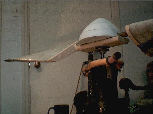

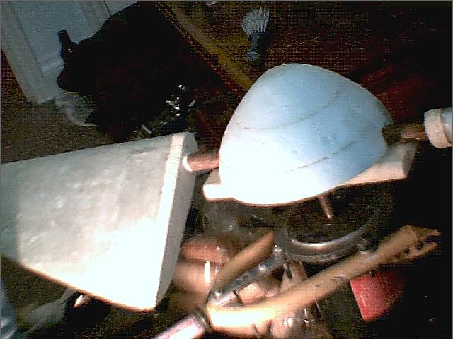

Had a lot of fun making some small blades out of 1.5" 3m blue foam; 9"/28 degree root, 1.5"/0 degree tip. Fiberglass and epoxy have made these blades very strong and light. The entire unit including hub is 3lbs...52" from tip to tip. I can actually lift the enitire unit by the tips, hanging the 45lb PMG from the center...any give is barely perceptible. I'm hoping to get 150 watts in a 20 mph wind.
I'm hoping to use this wee mill to top up my future electric bike. They're going to be legal here this spring. The mill should be small enough that I can use it without alerting the building inpector...lol.

Nice set of blades. What kind of wood are those attached to or is that pixel distortion?

 Like the blades!!! How about some info on how you carve them.

Hi there,
The dowels and hub-plate are both knot-free Oak. The begining of the root is 1.25" marine ply cut to the airfoil shape and drilled through so the dowel extends 4" into each blade...two chopstix extend as well! The dowels are positively connected to the blade skinsuntil they end and adhered to the foam with lots-o-epoxy.
In this case I only used one wood section on the end.

Very simple. I shape with a file (rounded/flat) -the kind fiberglass layers use. This sucker takes down large-rolly-bits! I finished with a flat sanding board...the red kind (aluminum oxide?) of sandpaper...yields a very smooth finish yet can still removedlots of material easily. To give you an idea how easy this stuff is to sand...my nose-cone started square and I hand carved/sanded it in about 10 minutes (one smoke and a few mins more))

 Thanks for the info. Went to HD yesterday and found the foam pretty affodable. How about the glassing? Do you cover the styro before you do this to avoid meltdown?

DO NOT USE GLASS! You'll melt the foam no matter how you try to protect it. Epoxy works perfectly. I use the 4 hour kind. Coat the foam well and wait about 30 minutes, apply the fiber material and smooth really well. I resmooth a few more times in the next hour. Next layer of epoxy (next day) is painted on after a light sanding. I used quick setting epoxy to touch up certain areas and build up the edges. I recently painted everything with plastic paint. :)
