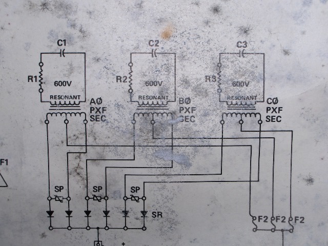

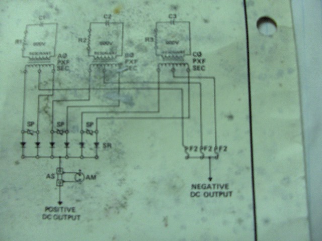

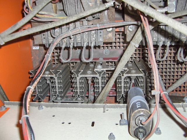

This is were the "Jerry Riging" comes in. I never thought about it at the time but it just hit me last night. Each phase had its own very big variable transformer. Each transformer had 2 wires comming out these wires went to 2 studs on the big selenium 6 AC studs all together and just 2 DC studs.
The big selenium is basicly 3 sperate fullwave bridge rectifiers with all its DC outputs wired perelell (HMMM jerry riged).
I'm thinking OK the manufacture wanted this welder to work efficiently, without eccess heat and get all the power out for the copper they put in and they didn't use star or delta? And this unit is changing 3 phase AC to a common DC power (HHHMMM just like wind generators HHMM).
Heres a couple pix.
I'm sure they don't call it jerry/riged. And I know I'm not the first to use this wireing sceem.

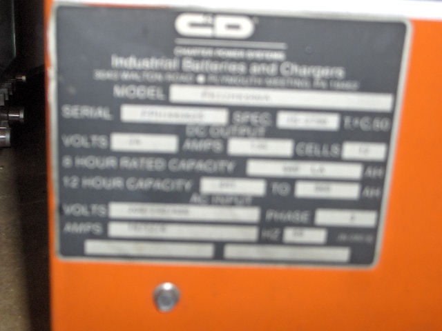

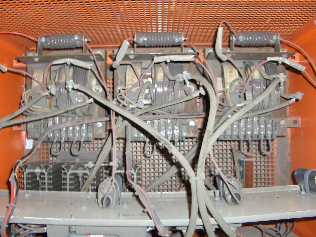

The other piece of equiptment was a vary large battery charger. Its used for electric fork fift trucks and such. It is way newer and I didn't tear that one up its still all complete. Memory also served me on this one also. So you guessed, I got up all fired up this morning, went out to the shop and poped the cover off.
This unit is built by Charter Power Systems, Inc. Specs are 208v, 230v, 460v at 14a, 12a and 6 amps. output is 24 volts at 135 amps. I think this thing only weighs about 250 LBs. It measures 32" X 22" X 24".
Just like the welder its powered from 3 phase AC and has one DC output and in this case is a battery charger( HHMMM wind generator).
It also has 3 seperate transformers, one for each phase and the secondaries of each transformer go to there own and seperate fullwave bridge rectifier and the DC outputs of the rectifiers are the perelelled (HHHMMMM Jerry/riged).
OH well I don't mind not being the first at least I'm in very good company useing this wireing scheem.
This is just a couple examples I'm sure there are many more.
Here are some pictures and the schimatic.
Thanks for the chalange guys. When its sugested that you may be wrong it makes for very good insperation. The can of worms is still there I just havn't dumped them all out yet. LOL

Re: Industry uses "Jerry Riged".
« Reply #3 on: April 02, 2006, 05:48:50 PM »
Hmmm interesting ..
but the output ( low side ) of the transformers are center tapped.
did you center tap your coils ?
i think not. sorry jerry the jury is still out..
nice try though..
« Reply #4 on: April 02, 2006, 06:54:10 PM »
I can't work out why you feel that this makes a difference. It just a cheaper more reliable way to achieve full wave rectification of each phase ...ie. jerryrig.
Jerry's circuit is essentially the same.
............oztules

« Reply #5 on: April 02, 2006, 07:09:58 PM »
This charger is set for full wave DELTA rectification.
It is standard way and also the transformers are FERRO-RESONANT transformers to keep the output regulated -- the whole affair NOT loaded is 85 to 90 % efficient -- because the Ferro-resonant that saturates the intermediate core shunt.
So it needs accurate AC frequency for proper operation, the primary independent and isolated from the resonant side and the rectifier.
You can separate them and have 3 chargers each capable of 135/3 = 45 amps
The plate photo with the specifications is un-readable.
It has 460 volts, so the primary is dual winding with low voltage tab.
You may remove the capacitor and even supply AC voltage to that winding -- but since I do not know the transformer characteristics I can not tell you what to do.
Nando
« Last Edit: April 02, 2006, 07:09:58 PM by Nando »
« Reply #7 on: April 02, 2006, 09:32:09 PM »
Jerry,  I think it is jerry rigged
I think the use of the ferro-resonant transformers, precludes the use of proper delta configuration. If the secondaries had AC currents able to circulate throughout the secondaries, then the circulating currents set up by the variable "Q" resonant circuits would generate more losses.
I think that this is three independantly rectified systems precisly because this (jerry rigged) system stops any AC circulating currents from further degrading the transformers efficiency.
I wouldn't consider driving the resonant windings (600v secondaries) direct if you intend to use it for Battery charging, as it is a tight magnetic coupling, and this is exactly what you don't want for battery charging. The resonant circuit between the primary and resonant secondary is what gives the flexable magnetic coulpling in normal operation.
In practice, changing the capacitor to different values will give different charging characteristics....I think it detunes the resonant circuit. Can be useful.
Some may call it  delta, but by your defintiions, I will call it Jerry rigged.
..............oztules
« Last Edit: April 02, 2006, 09:32:09 PM by oztules »

I almost made coment on the 2 doides with center tap transfomer secondary being fullwave in the post.
I knew some one would call me on this one. It is as full wave as 4 doides in the bridge configuration.
It could as well been the convetional 4 doide full wave bridge. If the transformer was left the same but the 2 doides were replaced with the 4 diode fullwave bride and center tap was not used the voltage would be twice as high. If the center tap and one transformer secondary lead was used the volage would be the same and the amperage would be half.
However in either case this power supply would still be wire jerry/riged and not delta or star. However it is equal to delta without slight diferances between phase causeing that unessary current to flow.
HI Nando. I'm thinking of useing 2 of the supplies in the charger to keep my 48 volt battery bank topped off during are frequent and some times long no wind spells here.
The ferro resonat transformer is used for regulation. However even if the transformers were of standard type this charger would still be jerry/riged.
About the center tap thing. Wind generator alt coils could be wound with center taps. Or a coil center tap in a coil can be created by winding coil wires 2 in hand.
Indeed this is what I did when I wound the 3 coils in the 6 slot 3 phase motor conversion test alt.
With center taped coils 2 doides could be used rather then a 4 doide fullwave bridge.
Its not common practice because its rather bulky and clumzy but the preformace results could be the same.
« Reply #11 on: April 03, 2006, 01:17:20 AM »
As far as I can see the drawing shows a 6 phase half wave rectifier.
« Last Edit: April 03, 2006, 01:17:20 AM by Flux »

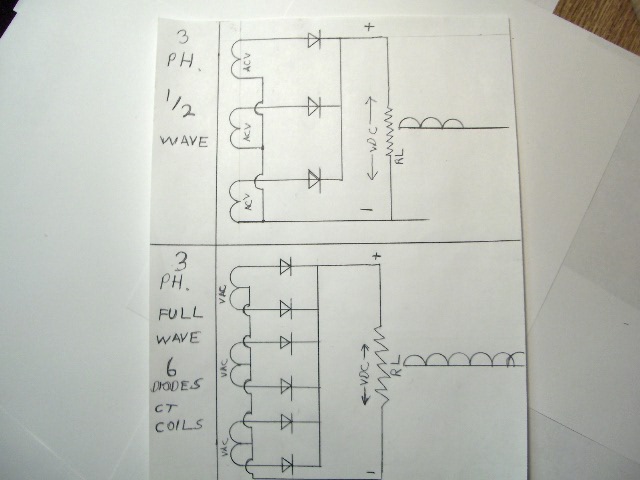

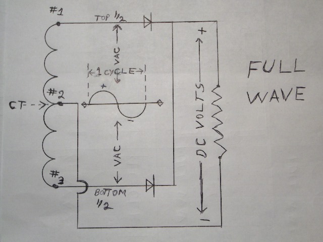

I drew a couple schimatics to help you grab the center tap 2 doide fullwave idea.
I coppied some diagrams from a big 1756 page tech book but the no reproduction warning in the front of the book scared me off. So I've drawn up my own version.
This picture show (TOP) a half wave using one diode, the middle picture is 2 doides conected to a center taped transformer secondary, this one is fullwave and the bottom picture is the standard 4 diode fullwave bridge (no ct).
The middel picture is what this big 3 phase battery charger is using.
The next picture is 2 diagrams. The one on top is 3 phase 1/2 wave and the bottom is 3 phase fullwave as in the big 3 phase battery charger.
This last picture is a fullwave setup using 2 doides and a ct transformer with a littel more detail.
There are 3 of these in the big 3 phase battery charger and there DC outputs are wired in perelell (jerry rigged).
If needed we can discus in more detail the function of this last schimatic?

Yes I agree that a single phase centre tapped transformer gives a bi-phase or full wave rectifier.
Your circuit diagram showed a 3 phase version with a 3 phase centre tapped winding which turns out to be 6 phase. Diodes conduct in sequence and it does turn out to be a half wave 6 phase rectifier.
The waveform is the same as a 3 phase bridge so the net result is the same as a 3 phase full wave but the actual diode conduction is 6 phase half wave.
