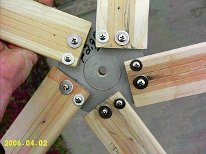

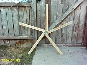

Hello all-
This weekend
I
Also got a "Trim Blade" 5 blade version finished
for the "Servo" motor.
This would turn a bit in the very light breezes tonight
put the "Servo" motor will take a lot or RPM's to get any
power going. It would only show about 6 V DC with cordless Drill
spinning it. I checked when I had to see what way I wanted the
prop to turn to keep the wires as colored: Red = Pos with black = Neg.
This one is set-up as a counter clock-wise.

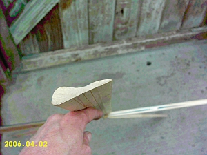

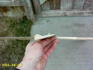

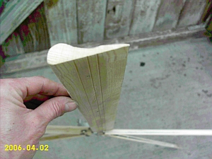

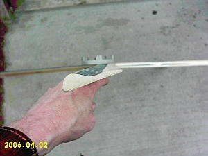

Trim being 2 1/4" wide full length of 26 1/4".
Being the Airplane wing type profile I tried to sand to
and then mounted to a flat surface they get about 19-20`
Pitch full length.

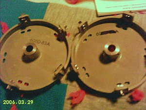

A the "Servo" motor is the only one I've got being 3/8" shaft
and that size being pretty easy to come by, with the plate,(Lock coller based)
I used being one of two I got last week,
I might go ahead and open this one up to 1/2", for use on the conversions.
These are the hubs I found at Army store $2.99 each
First one done
The "Trim Blades" So far.

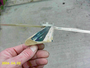

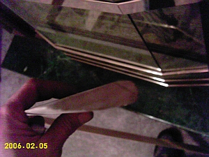

I had salvaged this wood from heading to the dump
And one day was looking at them for use in a "Solar Panel"
Water heater I'm building and saw the Airplane wing profile
that could be made with a bit of sanding.
So far have done two versions
First was a four blade and it turned a "Tread Mill" 2.5HP
motor with ease but not enough RPM.
This is the second version-
This one has a larger bump and flatter trailing end than first one
Also on a smaller motor.

Hi Coldspot.
Was the tredmill motor 3000 rpm or 6000 rpm.
I've found the 3K motor will work with direct blade the 6K doesn't.
« Last Edit: April 03, 2006, 11:59:03 AM by Jerry »

Saw some wide baseboard( I think it was) at Home Depot. Thought it might make good airfoils for turbines as it already has the shape needed. Curved on one side and flat on other. Good for mini-mills?
It doesn't have a twist to it so don't know how efficient it would be. The curve was on one side narrowing to thin edge
« Last Edit: April 03, 2006, 12:29:13 PM by jimjjnn »
coldspot
  • Posts: 843
Re: Trim Blades
« Reply #3 on: April 03, 2006, 03:53:51 PM »
Jerry-
Tread Mill
  1. 5HP @ 120VDC
  2. Amps
  3. RPM
Jim-
The Version for the Tread Mill was
like that and the same width as above.
« Last Edit: April 03, 2006, 03:53:51 PM by coldspot »

« Reply #5 on: April 03, 2006, 06:40:56 PM »
Jim-
Yea
As you can see by the pictures
I have sanded a lot from these.
On the other type,
sanding is less but still required.
These turned the 2.5HP Tread mill Pernament Magnet Motor
« Last Edit: April 03, 2006, 06:40:56 PM by coldspot »
