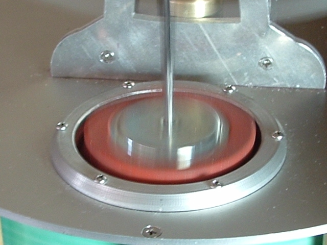

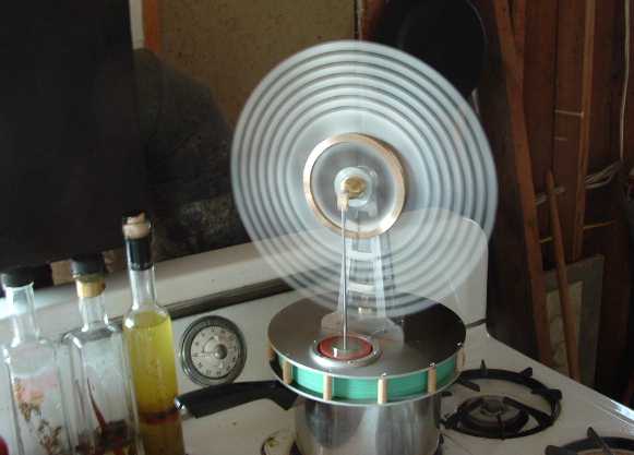

I built this Stirling Engine from an old vcr head assembly, and a few other parts. It worked even better than I thought it would.BR>
Here placed on my gas stove, over 2 quarts of boiling water, it achieved 300 rpms. and ran for 3 hours after the gas was shut off.
A close up of the power piston. Made from a Ford ERG valve.

'By the way what is a "ERG valve" I don't have a thourough
knowledge of auto parts.'
It may be "EGR" valve. - But - does your ISP not allow you to use a search engine?

The valve is an Exhaust Gas Recirculation valve, it is used to lower the combustion temperature by allowing some of the exhaust gasses into the intake to reduce the oxides of nitrogen emmissions from the engine.

Very nice indeed. one question, with it going so fast what if any amount of force would it take to stop it from turning? Can you simply put your finger on it and stop it or is there some decent torque coming along with the RPMs?

This Engine is running on a modest 1/500th of a horse power, estimated of course.

may I ask about the conection of the
rod from the "EGR" to the flywheel
or prop?
Is it like in an engine, con rod to crank?
The picture makes it look like not a off-set
crank type set-up?

WXYZCIENCE
  • Posts: 355
Re: Emission control valve
« Reply #9 on: April 04, 2006, 08:44:37 PM »
I don't know if this is the name for this part, so I got a picture of it, let the 1000 words I don't have to post tell you what it is.
« Last Edit: April 04, 2006, 08:44:37 PM by WXYZCIENCE »
WXYZCIENCE
  • Posts: 355
Re: EGR Valve
« Reply #10 on: April 05, 2006, 12:33:07 AM »
Thanks Darren, I Posted a Picture of another EGR valve that is still together.
« Last Edit: April 05, 2006, 12:33:07 AM by WXYZCIENCE »
