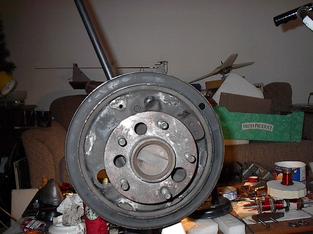

Testing seal drag
« on: April 23, 2006, 12:29:28 AM »
        part         grams      Oz    radius    radius cm    oz/in    g/cm
Timkin    471750    123.00    4.34    1.24    3.14    3.51    39.21
       w/o spring      94.00    3.32    1.24    3.14    2.68    29.97
Timkin    32x50x82 186.00    6.56    1.24    3.14    5.31    59.29
    w/o spring        155.00    5.47    1.24    3.14    4.43    49.41
Dexter    stock       124.00    4.37    1.24    3.14    3.54    39.53
Testing rig
Procedure - spindle shaft where seal was to ride was polished. Bearing was nylon on steel and oiled.  Seal was installed in holder, seal contact area was lubed with 5-30W oil between each test.  Water was added to bucket until it started to move, bucket and water was weighed. For each condition this was repeated at least three times.  The weights were recorded.  There was little deviation in the weights.
Conclusion - "It ain't worth it." If oil can be used as a lubricant, the seal drag is in ounce inches.  The spring adds some.  After 'running the numbers' it is apparent the standard seal which does not have a spring is about as good as it gets. Foot pounds are .021 to .042.  A horsepower is 550 foot pounds a second. At 600 RPM the seal drag is still less than .01% of a horsepower.

You're testing static friction, though. You should have given the bucket a push to see if it would continue moving -- that force would be more indicative of the drag that the seal causes.

was there a test with no seal?

Yes, there was such a test. It would spinup with an empty bucket and would spin with just the bail. Would not move with line and "hook" only. By using the Nylon and Delrin as a bearing and seal holder I was able to get inertia very low.
I did give the holder a slight spin with a finger as I added the water.  One or two grams of water difference and just the rocking of the bucket would cause the seal holder to turn. I was amazed at the repeatability of the weight needed to rotate the seal holder.  I had to borrow the braided line off my plumb-bob as I could not find my spool of regular braided line.
I plan on using this for a cap:
http://www.etrailerpart.com/prolube.htm
I will use thin synthetic oil as a lube. I will also make sure the oil is lower than the seal but deep enough to keep the bearings lubed.  I have seen a "water thin" oil they use in racing engines and know where I can get enough at the proper cost for a few hubs.
