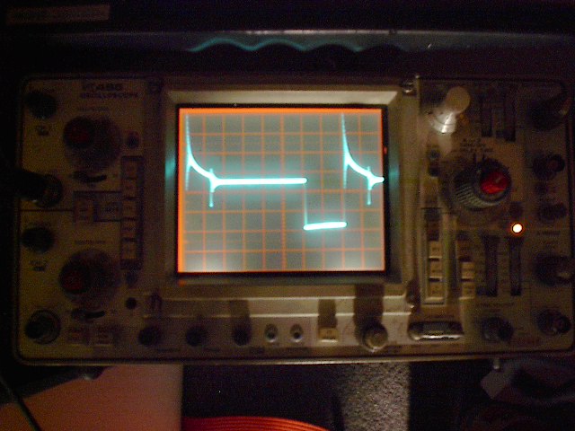

this is the voltage across the FET, not exactly a nice looking wave yet
http://www.otherpower.com/images/scimages/2965/IM002047.JPG

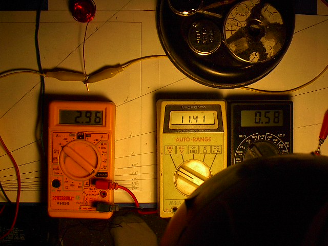

left meter input current= 2.96A
middle meter input voltage 11.41V
right  meter output current 0.58A

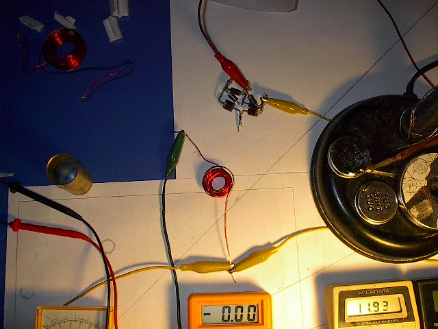

this is just after  i let some smoke out of that green wire there, not a problem.
the input battery has allready recovered to 11.93V
thats my coil/inductor there and diode
the fets did get warm but the coil did not , the wires didnt fare as well though

what air gap? i'm not getting what you mean by air gap , if this was wound on one on those inductor cylinders where would the air gap be?
« Last Edit: May 07, 2006, 09:40:49 PM by willib »
Re: 300w boost converter ..take 2
« Reply #40 on: May 07, 2006, 09:48:45 PM »
My uneducated guess is that if that is the coil (aircoil) then this is why you will only have any efficiency at very low current. You will probably get a vast improvement just by putting some steel in the middle....even a screw driver..... move it in and out and watch the meters, that should give you some clues to follow.
At the freq you are using, that inductance will be very poor. So there is plenty of room for improvement... that is a good thing, coz thats where the learning will come from.
It is worth looking at the waveform at the fet input as well, if it's good, then fiddle with the inductor until the output one is as good at the loads you want.
At least it worked, now for the improvements.....
.............oztules
are we a happy puppy or what:)

just did what you sugested , i stuck a socket in the middle and wow..
the output current stayed the same @ .51A But the input current went down from 1.42A to 1.0A.
it also dimished that  ringing (after that tall spike ) , down to a little blip

the wave looked a lot  better , the only thing out of place , was that very high spike and a little ringing right after ,i was all set to take a photo, but the camera batts need recharging :(

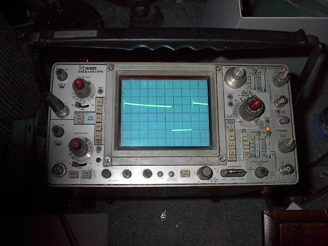

this is the improved wave at 1.0A output and 1.57A input, the coil has about 200 turns of 17 ga. wire, with a socket in the center
same wave , no flash

Now we are seeing some results from experimentation. You always learn more when things start out bad.
Remember, that at some stage you will loose more in the winding than you gain from the extra turns. This is where you will start to use coil designs with less turns but better core material. The same rules apply to the magnetising effects as apply to the coils in your windmill.
Remember when everyone used steel strips to increase their magnetic fields in their stator design.... it was to concentrate the flux.  Now its time to do the same thing. Using an E core ferrite, you can magnify the effects dramatically, and leave the socket behind.....but it proved a valuable point.
The cross sectional area is important (assuming the freq stays the same). It will be a product of cross section by turns (on a given ferrite compound) that will give you the inductance.
The reluctance of the socket former is probably helping spike the wave form unnecessarily, but your on the way.....keep testing .turns, former material, shape, etc
The meter leads will cause you grief as the current rises, and will distort the waveform as well. You may have to make short leads or use analogue meters, or a .1R resistance and measure the voltage over it to calculate the amps or some combination of each.
At some point, you will decide that more power is best done by thicker wire (or litz thicker) on a smaller former at a higher frequency....Plenty of variables for you to work with now....

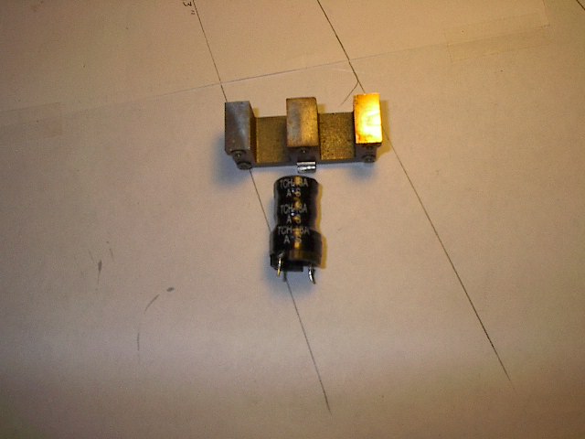

Inductor cylinder??? what is this? The E cores are two pieces of ferrite in the shape of an E  if the E's face each other and press together we have the usual transformer shape. We wind a cylindrical coil on a coil former (plastic) and slide the central E' arms into it. If they meet in the middle there is no air gap seperating the two E's. This will lead to a condition of saturation if we push decent current into it.
So we pull them apart just a little bit (approx 2mm for a start), and this allows us to not saturate the inductor at the current loads we intend.
So the inductance (turns and cross section) and the airgap give us our best output.
Do as Commanda suggests..hoik  the biggest tranny from a computer supply.
(don't laugh) I boiled the transformers in a pot of water on the stove  for 5 minutes and unglued them that way. (Wife wasn't home that day..didn't think of the stripper)
Wind a coil on the former and put it together so that you can slide the E's in and out. Turn on and see what happens. When pressed together, the input current goes up but the output doesn't. The coil is saturating.
As you slide them apart, the efficiency improves until as you go further, it degrades again. This will give you the best airgap for your best current transfer. (at least that how i did it).

Yes it's a cylindrical ferrite core wound with litz wire and found in some old pc monitors i've come across
« Last Edit: May 08, 2006, 09:24:22 AM by willib »
« Reply #53 on: May 08, 2006, 09:38:26 AM »
Sounds like a choke... open at each end.
litz in a monitor..... probably fairly light capacity. ?
You will want fairly heavy for any current capacity.
Go for a transformer design. that way you can close the magnetic loop totally and then work back with an airgap.
Because the freq is so low, it will be a fair sized inductor, which will limit your current somewhat. but depends on how much your aiming for.

above is a small choke and an ecore that i could possibly use , the ecore is laminated , the slots are around 1/2" wide
the choke ? is about an inch long with two terminals
« Last Edit: May 08, 2006, 10:45:35 AM by willib »

Use the e-core. The choke will work for lower power levels, possibly 20 watts.
What you could do is up the frequency on the pic, and use the choke; that'll get you several steps closer to where you want to get.
« Last Edit: May 08, 2006, 03:08:42 PM by commanda »

The thing to remember is that at 3khz I used about 54 turns of heavy (1.8mm) wire, and put it on a core slightly bigger than the e core you have there. The wire fills the winding area. (and I feel it could do with more.)It is just a learning tool but can easily do in excess of 300W with 1 coil.
To emulate that at your frequency, you would want over 150 turns of heavier gauge wire just to come close.... this is where your problem lies in getting any more efficiency at higher currents.
At 100khz, you may only require 5 turns of fencing wire to achieve the same thing on the same core. this you can fit..... but these frequencies bring their own bag full of problems..... most notably the layout.
The choke is a no starter unless your going to shoot for very much higher frequencies, and then your current capacity will be governed by the wire thickness and it's ability to carry current without significant R loss. If you have too thin a wire on the inductor, you will start to develop phase shifts in the coil which will lower your efficiency again. The more resistance, the higher the phase shift will be. (This effect is what you use to start split phase induction motors.... the start field is wound with different thickness wire, and so phase shifts are introduced to start the rotor moving..... (and then there is the cap start where the shift is effected by the capacitor).
So the long and the short of it is that at your frequencies, the ecore with at least 150 turns will (at an uneducated guess) get you close to good efficiency, but this will deteriate quickly as the wire size to achieve this may hold you back to 100W or so.
The choke will give you low power outputs before it gets very lossy.

One last thing on the frequency/inductor issue.
I went out to the shed and put a pot in place of the 10k timing resistor. I then turned the input up to around 120w and twiddled the frequency to try and match whatever the inductor was, to the best output and so by definition best effeciency for that setup.
So try this:
If you check the figures on the meters, you will find that within a messy range inaccuracy, the efficiency appears to be very high.
You will also notice the air-gap.... it's overlarge, so the extra frequency had to compensate for this and so a match was obtained at 18.4khz.
The E cores are held apart with 3/16" plastic disks pushed down the inside of the former, holding the coils apart.
So it works just as we discussed.... nothing like testing it out.

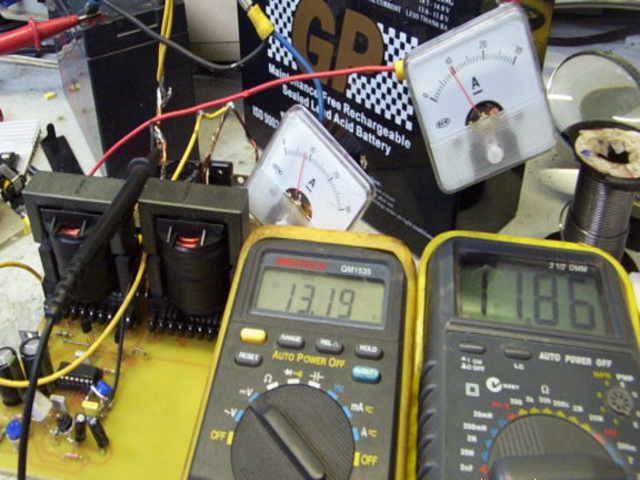

1.8mm is only 0.0709" hmmm thats about a 13 ga. wire..
your fets are on the other side of the board ?
how many amps is that reading?
looks like 10A on the right one?

The input is about 9.5Ampish @ 11.86v=about 113w
the output is  about 8amps @ 13.19  = about 105w or around 93%
The fets are as per the overlay . Here I'm only using one fet on the board only, so testing doesn't blow up too many at once. It has no heatsink, and after a few minutes at this power level there is only a luke warm feel to the fet. So it must be efficient. Some losses will be in the wiring (pretty flimsy for 10A), some in the meter shunts, some in the coil and some accross the single fet. When the six of them are in the resistance across this junction will be very small, with only 1 fet it is quite high for these 100v 28A units.
So by arbitry  opening of the air gap, we can find a frequency which best suits it. These dumb systems are very flexible.
Most sensible people wind the inductor to suit their calculated parameters I guess... but I haven't been accused of being sensible recently.
