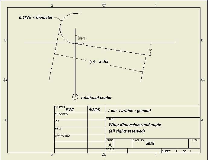

  For some reason the dimensions don't appear right in the vid.   Looks like its moving fairly well.   Do you know what the wind speed was ?   In a 10 mph wind it should make in the area of 4.5 watts and at 15mph about 15 watts.
  The wing width should be 3.375" wide and from nose to trailing edge should be 7.25" long.   Just looks like you have to much empty area in the middle.
  I have noticed after building a small one ( 12 x 12 ) that the wing angles play a big part in making them work properly where the larger ones are a bit more forgiving.   You might change the wing angle from 9 degrees to about 14 degrees or somewhere inbetween.
  Did I send you a wing drawing for size and angle?

The dims are straight from your postings. I have read them all dozens of times.
3.375"(wide) x 7.25"(long) 8.5" from center shaft to center of the wing (17" total ). I got tunnel vision at 9deg tail towards center for the angle. I will try turning in some and see what happens. You didn't send me anything but I would love to see anything you are willing to share.
The wind was really gusty. Weatherbug was saying 10 to 25 mph. (using a 5 second timer I was getting between 7 and 8 turns most of the time)running about 85 to 90 rpm. Hooked to a 9volt Dewalt battery. I ran all afternoon and the battery only gained a couple volts. And it still won't turn the drill.

« Reply #9 on: May 04, 2006, 10:27:33 PM »
   Being close to the ground with lots of obsticles you were most likely getting winds much less than weatherbugs readings.   They usually take samples at 30ft or higher.   It may have been actually running in a 5-10 mph wind.  Your coil layout is most likely in the range of 18 ohms wired in star using the high turns of 23 wire so if it was making 3 watts over a 5 hour period you didn't actually put much into the battery ( it is rectified right? ).   I calculated it would run at around 90 rpms in a 6 mph wind with a load.  Sounds like its in the ball park for speed.  Your dimensions sound like their right on the money.
    I uploaded a dimensional drawing that helps explain the wing angle as well at http://www.otherpower.com/images/scimages/15/wing_dimensions_and_angle.JPG
