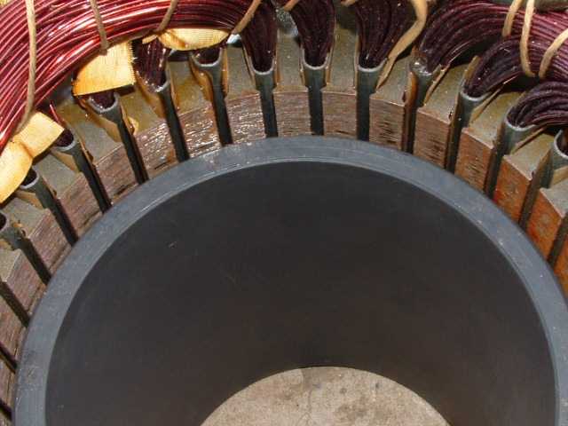

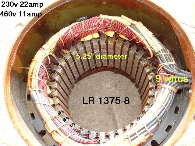

Can this type of motor be converted to a 3 phase genny?
Are there arc magnets to fit it? Joe.

Looks like a 3PH 4 pole ~5kw/6.75hp motor.  I think it would make a good generator. Will take about 6M or so blade set and associated tower.
Of course our resident expurt is zubbly.  I feel sure he will chime in.

« Reply #2 on: May 11, 2006, 04:34:53 AM »
hi WXYZCIENCE!
that is a perfect motor to convert. the arc segment magnets we see for sale form an outside diameter of 3.8 inches, so i am pretty sure they are out of the question for your 5.25 inch stator bore.
on conversions that size i have found the 3/4 round by 3/8 thick mags to be the most promising size for a conversion that size. you have the standard 8-10-12 coil spans and basically your magnet pole will be the width between the coil legs of the 1-8 span. you only need to locate the star point in the connection and add 3 leads to it to give you the full connectability of star and delta (1 and 2 circuit).

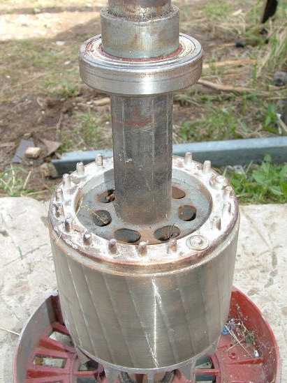

did a 3hp conversion last year with a bore diam of 4.25 inches. you rotor would likely need one more magnet wide on the rotor. this one took 15 magnets per pole.
Do you have any specifications available of that conversion?
How much did you pay for the magnets?

« Reply #5 on: May 11, 2006, 11:20:59 AM »
hi hvirtane!
that was the genny i made last fall. the shaft got bent like a banana when i was attemting to raise the tower and dropped it. so never did get any performance figures. an currently working on re-erecting the tower and am making a new genny.  the shaft can be replaced, but i will do that some other time.
you can view the conversion process from page 15 and on in the gallery.
http://www.anotherpower.com/gallery/zubbly?page=15
i honestly don't remember what i paid for the magnets.  it took a total of 60 magnets for the rotor (3/4 round by 3/8 thick)
rotor diam-4.222 inch
rotor lamination length-4.322 inch
stator bore-4.254 inch
36 stator slot
aluminum cage-4 inch OD with 1/4 inch wall thickness
outside dimentions of magnetic pole made from 15 mags-2 .375 wide by 4.332 long
mags were spaced approx 22mm on centres for length and width
face of rotor turned to 3.390 inches

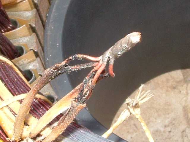

« Reply #6 on: May 11, 2006, 02:12:11 PM »
Thanks Zubbly, Here is the star connection, looks like they are dual wound, am I correct?

« Reply #7 on: May 11, 2006, 04:49:43 PM »
often what you will see is motors done with 2 or more wires in hand. its just a combination of smaller wire which makes it easier to feed into the slot, but has the same effect as 1 large wire.
