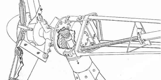

I have been looking at the Jacobs Variable Pitch Prop system.  Today I decided to cobble together a quick model so I could study with my hands and eyes. It starts with the blades fully retracted and as "flat" as they get. The blades slide out and twist on the hub. A collar with ball joints controlls the tail of the blade on the later model Jacobs. Springs hold the blades in retracted mode - "Flat"
As the speed goes up, the centrifigal force pulls the blades out. This pitches the blades more coarse.
If the mill speeds more the blades pitch even more.
Well - that's about all for "Just looking".

Re: Modeling teh Jacobs VP system
« Reply #1 on: May 19, 2006, 08:32:10 PM »
I don't wish to deride your explanation, but for me it still is mysterious.
Does the blade retreat from the hub radially...and ... at the same time do something else.
The black cylinder appears to move out of the white pipe whilst the blade moves up and rotates around ... is that it?
Are two systems working in tandem, or is one system(blade outwards movement) controlling the twist, as well as the black cylinder with the "ball joints" (which appear slightly adumberate at this stage.)
Before I was just ignorant, now I am confounded as well.
Can the black cylinder moving out of the white pipe do away with the radial movement, and so get rid of one more variable (dynamic blade length and tip to tip balance) - radius change of the blade.
Please keep up the good work as it will help me design a variable system for over here one day.

Here is the best image I have found
I'll try the explaination again. The blades moves out radially.  As they do, the (reference new drawing) spider twists and causes the blades to rotate to a more coarse setting.  The balance of blade radial position and "Spider twist" controls speed and pitch.
Easy - RIGHT?
« Last Edit: May 19, 2006, 08:51:02 PM by wdyasq »

« Reply #3 on: May 20, 2006, 02:25:42 AM »
Here it is for real. I can't remember the name of this unit ( I believe 3kw and 14') but the auto pitch sure looks the same as the drawing.  Dave B.
« Last Edit: May 20, 2006, 02:25:42 AM by Dave B »
« Reply #6 on: May 20, 2006, 05:16:41 AM »
Now that makes sense, thanks Dave B
