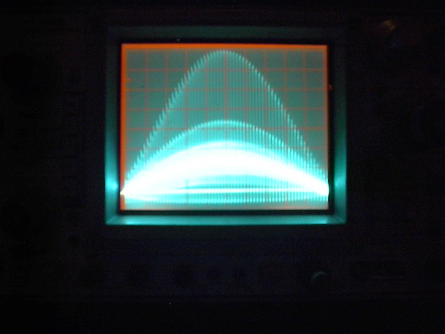

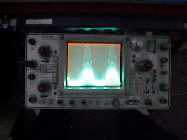

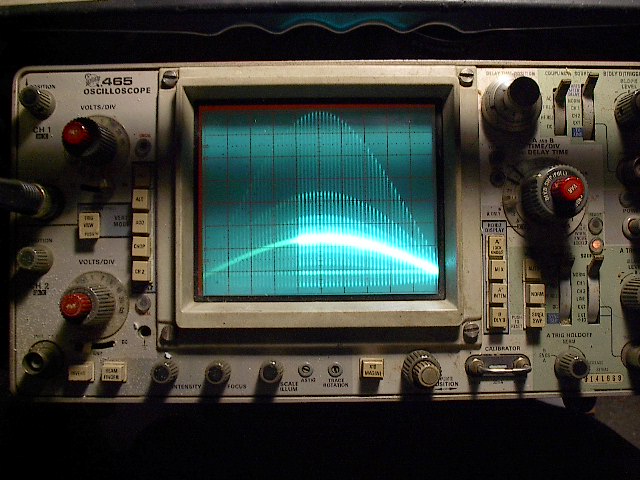

oz , let me discribe the circuit, i have the scope attached across the FET( pwm ),
the input to the circuit is the output of one phase of mini gen, the load is a 1157 taillight bulb
i think what is going on is the coils in the gen are acting as the boost inductor in your circuit, but i'm not sure
it certainly is different !

it looks like youre trying to make a true sinewave inverter from a calculus inspired waveform.
I assume the second half of the wave is flat as it is short curcuit on the neg waveform from the body diode.
It appears to be acting as a boost converter on this half of the wave.

yes its flat
here i've slowed the sweep rate
« Last Edit: May 26, 2006, 06:17:32 AM by willib »

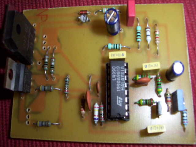

from the data sheet...
"Duty Cycle Control
Duty Cycle DC is externally programmed by setting
a voltage between 1V (0% DC) and 3V
(100% DC) at the DC pin. The programmed voltage
is compared with the oscillator CT capacitor
charging waveform to determine the maximum
ON-time in each period. This function gives a fine
control of DC.
If this pin is floating the maximum duty cycle depends
on DC-LIM status."
so you have yourself a  varible pwm
nice!
i tried to find where flux mentioned using the coils in the alt for boost , but alas i could not find it , if you have that particular post could you maybe point it out to me
« Last Edit: May 26, 2006, 07:35:36 PM by willib »

http://www.fieldlines.com/comments/2006/3/17/185646/194/35 should do it.
The pwm width can be controlled from either two error amps . It's max width is set from the duty cylce control. Could be handy to shape a modified sine converter.
