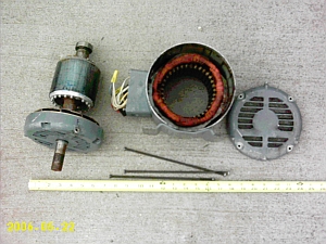

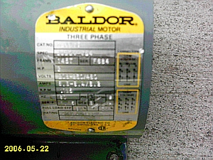

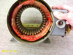

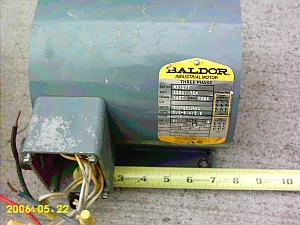

2 HP 3 Phase For Induction Conversion
« on: May 23, 2006, 05:23:10 AM »

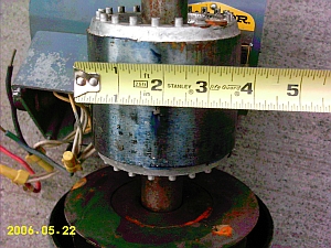

Trying to please the wind gods
I'll kill this motor and try to made a gen out of it !
36 slot's
About # 19 or 20 size wire inside
Mount bracket is stamped but welded on not just spot welded.
More to come after more is done and # 29's that were shipped to me
last saturday get here, :)

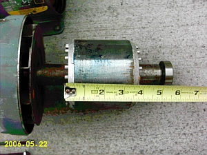

hi coldspot!
you got one of my favourite motors that i like to convert. just a note, when you turn down the rotor (if you plan to use 3/8 thick mags) the laminations will fall apart because you end up turning through the depth of the aluminum bars which hold it together. the depth of the aluminum bars in the rotors of baldor motors is not very deep. using the #29's should be fine as they are 1/4 inch thick.
i can see from the photo that the laminations on the rotor are 3 inches long. i think the #29 mags are 1 3/4 inches long. you could use 2 per pole (in line with each other) and just divide up the  excess evenly on both of the aluminum end rings.
cogging will be an issue with the mags as they are not skewed and the stator laminations are not skewed either. i suggest you try an offset in the alignement of the 2 mags per pole by approx the width of half a stator tooth. you may have to try slightly less or more and check for cogging after each different position.
be extremely carefull when insering the rotor and do not put yourself in the position of having a finger in the way of the rotor going in. the rotor goes in with lightning speed and terrible force. i suggest drilling and tapping a 5/16 hole in the end of the shaft. it will be good for mounting a cross bar to assist with insering and removing the rotor and also for mounting the prop to the shaft.
good luck and let us know the results!

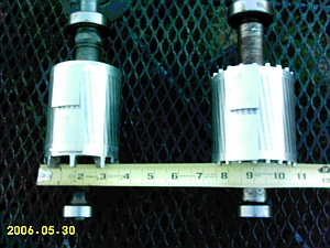

Did get to machine shop today and now have rotor ready for magnet glue
On the right is Baldor one.
Hate to waist trip to lathe,
so we got an extra 2HP 3 Phase done while there.
The one on the left

Are you using the same arc magnets on both?

Dr.D-
I'll probebly be using the #29's
on bolth
If I can get enough money to order more
(getting paid for last couple jobs that is, lol)
