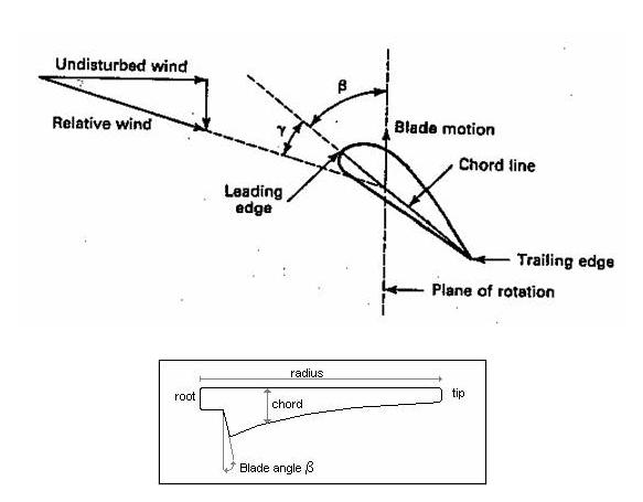

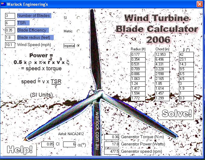

if these have a 6 degree angle of attack,does that mean the tips are  0.3 + 6 degrees?
or should the tips be 0.3 degrees ? when done
i'm a little confused on this point.

In the diagram I used 3 degrees instead of .3 degrees (just so it
would be visible)  6 degrees is the angle that the wind will appear
to approach the blade when operating at designed TSR.
I included a second diagram to show what drop and thickness
mean because I was a bit confused by these terms for a while.
Hope this helps.

As I've pointed out previously willib, the Cl (Coefficient of Lift) and AOT alpha (Angle of Attack) are derived from the measured polar plots of a given airfoil. They are taken from the point of maximum L/D (lift to drag ratio). You enter these values into the calculator. This is why it's necessary to use a documented airfoil for good results.
Beta is the actual AOT relative to the plane of rotation. In your example, .3 degrees is correct at the tip.
Unfortunately, SmoggyTurnip's upper drawing shows a negative 3 degrees AOT. Although it can go negative at the tip for certain airfoils depending on TSR, it's usually a small positive angle.

I need to correct a couple of things I said.
After looking at the calculator again, I see that Beta is not the actual AOT but the blade angle.
Apologies to willib and SmoggyTurnip.

Re: angle of attack ?
« Reply #5 on: May 28, 2006, 10:58:46 AM »
GoeM thats a lot to digest , and i shall try to take it all in , in the comming days .
http://www.otherpower.com/images/scimages/2965/resultant.JPG
shouldnt you be using the chord line , instead of the flat surface? or is that what you ment?
is the apparent wind the relative wind in the .JPG ?
and what is the angle  gamma in the .jpg?

Gamma is the AOT at max L/D. Usually 4-6 degrees.
« Last Edit: May 28, 2006, 01:21:43 PM by SamoaPower »

« Reply #10 on: May 29, 2006, 08:33:06 AM »
I looked at the drawing.  Gamma is the angle of attack.  The sum of gamma and beta is the angle between the apparent wind and the plane of rotation, which is the angle you get for a zero angle of attack.  The amount of attack angle you introduce reduces this to the angle beta, which may become quite small or even zero.
The drawing shows the situation near the root.  As you approach the tip, the blade speed will increase until it is TSR times as large as the incident wind.  In order for the blade to work properly in that case it must be rotated clockwise from the position shown.  That is, the angle beta must get smaller.
The chord would be the proper line to use, and may be known for NACA airfoil profiles.  For a home brew blade assembly it may not be known.  The back side of the blade would certainly be known.

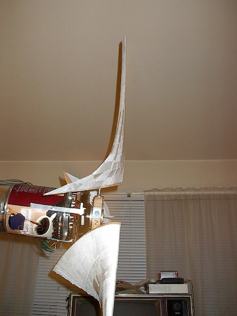

in the first pic the blades are actually spinning , but with the flash it stops action..

its an sg-6050

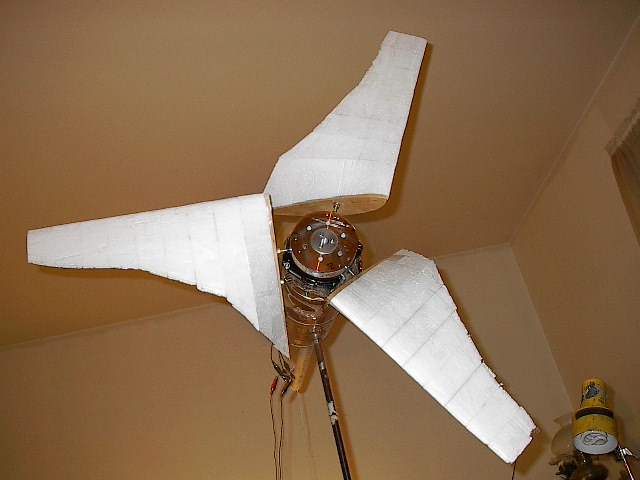

just a little update , the larger blades are now 7.5 feet dia.
and i still have one more section to make.at this point they will be at least 101 inches in dia
since i can swap out sections , i'm thinking of redoing the root , since that is the one  i started with , i can do  better now.
the hight of the origional root is 3.5" , and three  sections are 5" , three are 4 3/8 " and one is  5 3/4" , but dont tell anyone , because looking at them you would never know.
the reason for the variations is simply availablity of  foam.
the first foam i started with was 7/8" thick , then i bought the 1" thick blue foam , which sucks because its warped around the edges , it must be the extrusion process , then i bought 2" thick white insulation foam which is really 1 7/8 " thick .so three glued together is 5 3/4"
so if i make the root 5 3/4 high and the last section the same they will be 106" in dia , which is 8.83 feet..
some background : they a tsr 6 blade set
 the root chord is 21" long at 42 degrees and spans 19 degrees to 23 degrees where  the chord is also 21 inches   ,
the next section chord length goes from 21 to 18" and  spans from 23 degrees to 14 degrees,
the third section goes from 18 inches to 13  and spans from 14 to 9.5 degrees
fourth goes from 13 to 9.75 " and spans 3 degrees from 9.5 to 6.5 deg.
fifth  goes from 9.75 to to 7.3 inches  , span is 2 degrees from 6.5 to 4.5 deg
six  goes from a chord of 7.3 " to 6.0 " and spans from 4.5 to 3 degrees
seven goes from chord 6" to 5.15 inches and spans from three to 1.9 deg
eighth section chord starts 5.15" and goes down to 4.5" and spans from 1.9 degrees to 1 degree
lastly , the ninth section chord will go from 4.5" to 4" and span from 1 deg down to 0.3 degrees
thats a lot of typing , for me anyways , it started as a little  update , oh well
