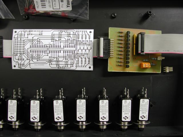

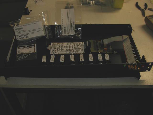

A couple of (very) quick photos.
I've split the circuit over 2 pcb's. First pcb almost assembled contains the LM3914 (under the ribbon cable), transistors, and ribbon cable connection for the leds.
Second pcb, of which I've done the layout but not yet etched the board, contains the rest of the logic. The 2 boards connect together with ribbon cable.
Across the front of the rack are the 8 x 10 amp DC circuit breakers.

« Reply #5 on: June 02, 2006, 02:08:42 AM »
The LM3914 part has been prototyped & tested using a kit from Jaycar of the circuit published in May 2006 Silicon Chip magazine. It's set with a range of 1.0 (one point zero) volts from led 1 to led 10, for a 24 volt system that's 27.0 to 28.0 float, and 28.0 to 29.0 in boost (equalize) mode. These are flooded lead acid batteries, and I'm open to suggestions on exact voltages to use.
The rest of the logic hasn't been prototyped & tested, but it's nothing I haven't done a zillion times before, so don't expect any surprises.
The first board with the LM3914, which you can see in the photos, was done with the "join the dots with a texta" method. I powered it up this afternoon with no surprises.
The second larger logic board will be done with transfer film. Print the artwork onto transfer film with a laser printer, then run the film & blank copper clad board through a laminator to transfer the ink to the copper.

Thanks for the piuctures. Could you upload the PCB pictures to make it easier to work with this? I would like to build this one and to take some experiments.
« Last Edit: June 02, 2006, 07:04:52 AM by amiklic1 »

I will upload the Autotrax pcb files, once I get the second board built & tested, fix any last minute tracking errors &/or changes, put values on all the components, and make the component numbering match up between the circuit and the pcb's.

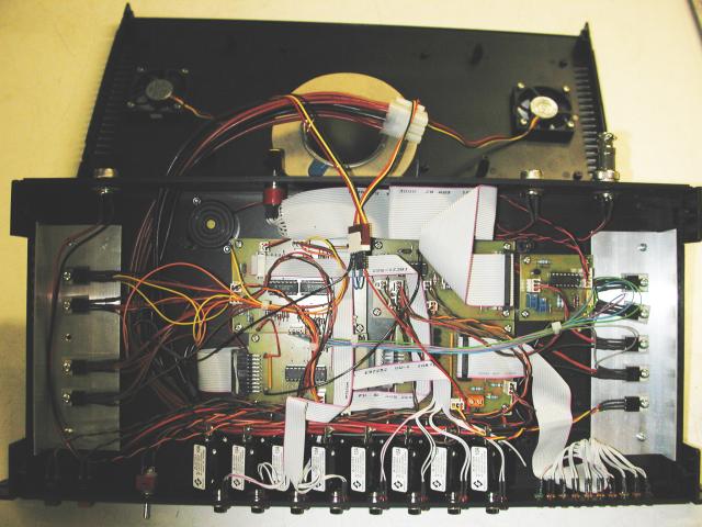

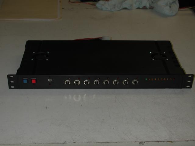

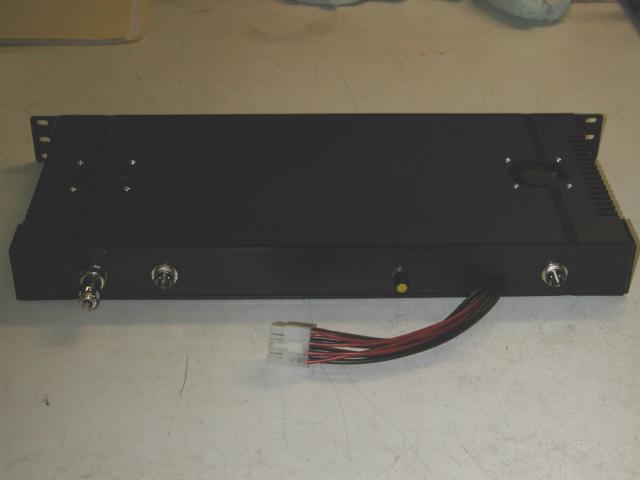

Final couple of photos before I send the front & back panels to the engravers for some labelling.
Overall, it's a bit of a rats nest, and a single unit rack enclosure is a bit of a tight squeeze. I have tried playing around with the pcb layouts, to get it a bit more tidy. I'm trying to get all the leds and switches mounted directly on the pcbs. Whilst it would certainly decrease the amount of wiring, it also cuts down on the options of exactly how to build it. I have a new board, which mounts 4 of the fets and an optional logic level translater chip, with screw terminal terminations for the heavy drain & source wires. Haven't built it yet. I will eventually upload that artwork for anyone that wants it.
I used 2 pin microphone connectors for the 24 volt dc input, the temperature sensor input, and the temperature meter itself. The cable bundle has a 12 way automotive connector on the end. 8 red wires go to the dump loads, and 4 black wires go to battery negative.
The 2 little 50mm square by 10mm deep fans in the lid still need a series dropping resistor to slow them down a little, and their own switching fet.

Re: Dump Load Controller
« Reply #15 on: July 07, 2006, 09:18:23 PM »
Funny. Was wondering today how things were going with your controller.
Looks pretty nice, despite the rat's nest. But there's definitely little space left. A bit of lacing wire and bundling of cables will make it look much better.
Am definitely interested in the new board with logic-shifter (was thinking myself, wouldn't a resistive divider be enough?) and in-built FETs. Will build one such board for the 19" rack, so I have a stand-alone dumpload unit. But should I ever have to dump much more energy, a different, stand-alone power dissipating unit will have to be built. Am already toying with the idea, but it's all still very vague.
