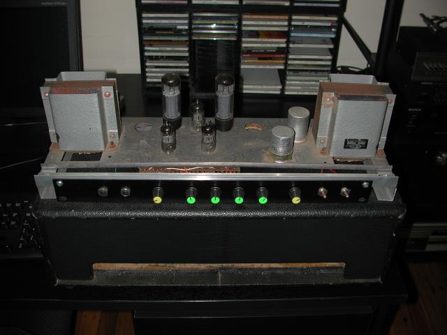

I was building some special solid state mic preamps for a costomer anyway?
This first amp is stereo 15 watts per chanel, the other started unit is about 25 watts per chanel. I've allready layed out parts and such for a 500 watt 2 channel tube type and 2 mono blocks amps using the WW2 GE 211/VT4-C these are very large 9" coke bottel size triodes. These amps will be single ended.
The finnaly will be an OTL of the Futterman design. And amist all this KAOUS I still want to build more motor conversions and dual rotor machines? Why does the clock have to go so fast? LOL
Heres a picture of the littel 15W X 2 power amp. I'll be using a 1958 stereo Leak preamp, or my Fischer 400c or one of my home built tube preamps?
This amp is using PP EL84/6BQ5 audio out, 6AN8 as first AF and phase inverter and a 5U4 as the rectifier. I really prefure a solid state rectifier for tube amps but the voltage from this transformer mached the 5U4 and SI diodes would have made to plate voltage way to high. I could have used a choke input filter with the diodes but I prefur capacitor input filltering.
If anyone wants I may post progress on the other amp projects. If not and this post gets scrubed I'll just buildem and enjoy the music.

« Reply #9 on: June 05, 2006, 11:17:51 AM »
Hi 12ax7.
Every time I see you post as 12ax7 I think I'm older so I should post as the older version (6SL7)LOL.
The speakers I use on these tube amps are very eficient. I've allways wanted to build a Futterman. So we'll see how stable it is. The thirory of OTL sounds very apealing.
I have in my collection 2 Dynaco A-441 25 LB 240 watt max output transformers. These have extra tretory cathode winding simuar to McIntosh. Also a matched pair of UTS CVP-5, 300 watt multi tap output transformers.
The Dynacos are 2200 ohms plate-to-plate to match PP parelell EL34, 6CA7, KT88 ect.
I'm goint to use the UTCs with 4 807s each at 3,000 P-to-P perelell. That amp will have 750 volts to the plates, 300 v to the screens, There will AC balance adustment and seperate bias ajustment per 807. This monsters gona be heavy and big.
As far as the 211s are concerned. They were in my collection so I'm going to use them.
I want to make the amps that I can out of the stuff I have without spending much money so  its a use what I got kinda plan.
The amp in the picture is not finished yet. No parts under the chasis yet. I'll post the #s after its been benched.
