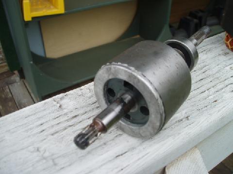

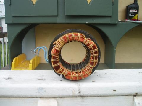

   I want to build a small wind charger from this motor and need some advise
It is small. the length of the stator is 3" and diameter of the inside is 2"
The rotor is 1.5" long by 1 7/8" dia.
It has 24 slots with 8 coils mounted on 6 slot intervals. The wires out are white, black and red, with 2 blue ones on the other side.(I think they went directly to the capaciter.}
I want to make electricity with no goals in mind. Simply to see if I can.
I plan to grind 6 flat surfaces on the rotor and mount Hard drive magnets.
Will this work?

It's hard to tell in this picture, but there probably is a bigger winding and a smaller one, the starter-winding (which should be connected to the capacitor, via blue wires). That would probably mean not all slots are the same depth? What RPMs does the motor work at? (you need that to determine # of poles).

try hookin a batt[12volt auto batt or 12v trasfomer-just for a short time] to the white and blk wires[or red and blk] and see what coils are powered up ..hold a small mag in your hand and hold it down inside the motor.you will be able to feel which mags are powered up-and which ones that are not..
if all four big coils are powered up then you have a single phase motor--just use 4 mags..do the same for the smaller starter coils..
hook up one bridged rect to the two output wires of each set of 4 coils..then hook the dc output of each rect togeather plus to plus negative to negative--those will be your two  power out leads + and -

The rotor looks a little different, where there is only steel there is usually stripes.
The wire count has me thrown too.
It sounds like a 4 pole motor to me, until Zubbly or someone says otherwise.
It takes 4 magnets. I would expect about half an amp at 12V, and higher watts at higher volts, but I don't do it as well as many others.
Did you ohm out the wires?
