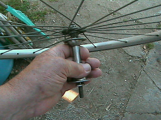

   I like bike wheel for hubs....the bearings are
ideal...but if you want to tap the power from it
its rather difficult as the shaft is stationary.
   So here's my answer......
   I unspoked a front wheel, took a large washer
copied the spoke hole pattern center punched and
drilled the holes used the exact pattern as
original when installing the spokes....except now
the hub only has one flange ! If the rim was
faily straight to begin with ...the wheel can even
be adjusted as well as when it had two flanges on
the hub.

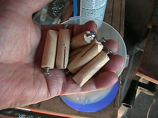

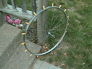

    Then I made the little blade holders from 1/2
inch dowel rod...they're just the right size to
wedge into the rim when the screw is tightened and
they remain at the angle you put them.
  I screwed them into the unused spoke holes,
adjust the angle of the slots ...insert the ...
blades/disks and .....

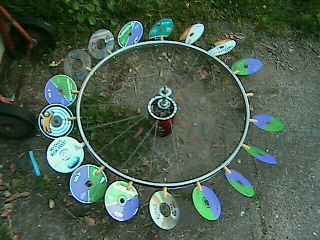

   end up with this
   of course you could use different shaped blades
but these are handy...easy to replace....and ..yes
they will have have small pins...shiskabob sticks
to keep em from flying out of the slots....
last time I thought they were so firmly wedged in place that at these low operating speeds ...they
would never come out....couple of hours..they did
.....of course....LOL.
Flying saucers
                 ( :>) Norm

Well, at least it sends a strong signal on what CDs & software you don't intend to use. AOL, Microsoft, etc. Hmmm, maybe this software will even do WORK. At least more than it ever did on a computer.
Looks a bit like a contraption that one might find at an art convention. Except this one could actually be useful. Hmmm, if the neighbours start complaining about your lawn 'ornament', say that's it made by some hot-shot, hip modern arts type and that it cost you many 1000s of $$. That might make it more acceptable (to them, of course; everyone on this board agrees it's absolutely beautiful ;)  )
Is it just my imagination, or could this be used both as a VAWT and a HAWT?
Do you plan on adding a genny? If so, what type, power, etc.etc?
Peter.

My question about stress relates to the fact that you no longer have both sides of the spokes attached.  It looks like the spokes on one side of the original bike axle have been removed.  All remaining spokes are attached on the same plane. No more triangulation for support.
« Last Edit: June 16, 2006, 12:24:05 PM by snuffy »

  Oh yes...I see what you mean...Yes that occured
to me also but once I made it and tried it ...
didn't seem to be a problem...I suppose scaling
up too much might cause a problem...but in my
case the neighbors would be complaining long
before I got that large...
  You are somewhat limited to a certain thickness
but I can make the original hub that holds the
bearings by cutting a section from the middle
which would give me an axle sticking out farther
on one end and then use two washers .....

  I plan on using it to direct drive one of those
neat cogging little stepper motors that Ghurd
gave me this thing certainly has enough torque
in a 4mph wind to crank that little cogger over!
   Anxious to get it up and spinning actually be
able to hook up a prony brake and see how much
ft. oz of torque it has.
   It's a HAWT right now unless it falls over  :)
                 ( :>)Norm

The only thing of use is the axle and bearings. So take the spokes and wheel rim off and bolt a plate on one of the flanges through the spoke holes. This is what I have done on my gutter blade posting. But if you have a hub with threaded holes for a disc brake it will be even easier. I have such a wheel, but it is a quick release, so I do not have enough thread to attach the axle to anything.
I used a hub like the one in your photo and I had weights on a plate attached to the other end to show the blades were doing some work. What I discovered was that the bearing housings are not attached to each other (the two bearing housings and shaft are not cast as one piece), after a while the blades started to spin faster than the weights. I have rectified that by bolting the two flanges together.

  Gotta get the power from the windmill using the
easiest way possible...the one flange idea
isn't working as well as I thought...gets  out of
alignment very easily....well back to the drawing
board perhaps just a swash plate bolted to a regular bicycle whee..that would give
a reciprocating motion...I'm mainly interested in
making an ornamental..but functional windmill that works in 4-6mph winds....
      Yeah I discovered the part about the hub
of a front wheel not being one piece....so long
ago that I had forgotten it....thanks for
reminding me....
