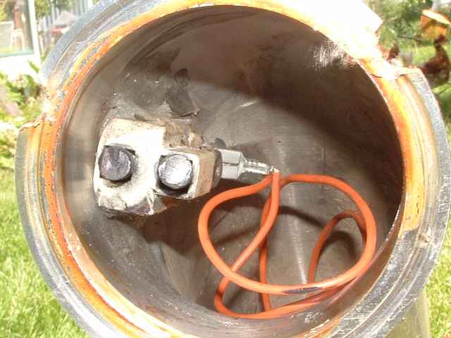

Summer has come to our home town, so technically I missed the spring cleaning of my down windmill.

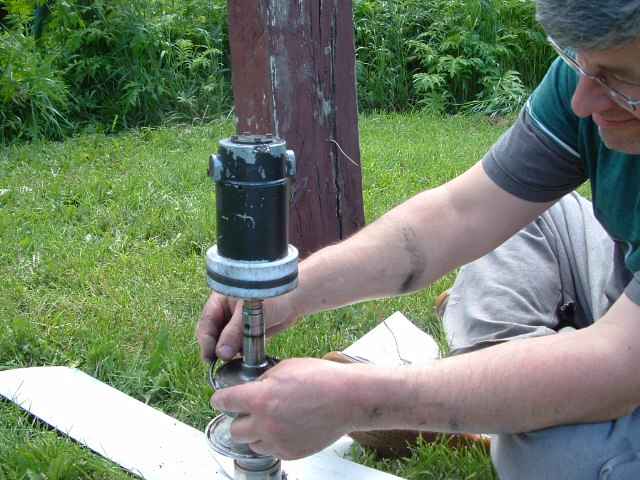

Here I'm putting it back on the tower and setting the brushes.
The brushes are from an old automotive alternator.
This slip disk sits on top of the hub and transfers the power throughout the mills 360 degrees of rotation.
This unit develops a maximum of 150watts (90 volts at 1.7amps).
The brushes and disk can easily handle this amount of power.
The genny is a DC PM motor that puts out (13.45v at .3amps) at 340 rpm.

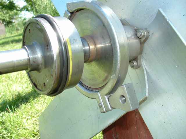

The transmission can be seen here. It came from an old mini washing machine.
A stainless steal clamping system makes maintenance easy.

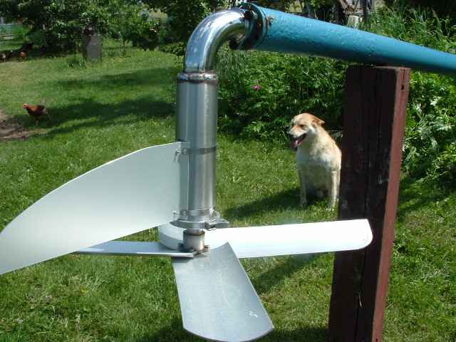

You can also see the profile of the blades and hub assembly.
The bronze seal stops water from entering the main housing.
The increase is 2.33 to 1.
If the blade is turning at 200 rpm, the genny will be turning at 466rpm.
The transmission and genny are held in place by rubber o-rings.
This also removed noise transmitted down the tower.
Complete for another year.
Cody wants his picture taken again. Joe.
