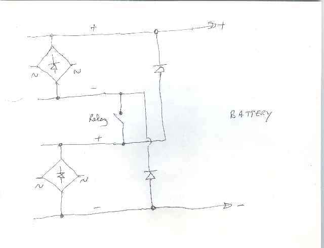

Devo
  • Posts: 175
Much bigger numbers
« Reply #12 on: June 30, 2006, 02:19:02 PM »
Ok fellas I went & got a brand new 30 amp ammeter from a farm supply store (for a tractor).
At 680 rpm on my drill press it read 22 amps 14 volts in the battery(308 watts)
I decided to wire the motor back as 2 coils in series bridge rectified as before but now I have 8 mags to see if there was much difference , it was a big difference , it has me wondering if I should rewire them all as single coils with 8 bridges because maybe I had something wired wrong.
Here are the new "split coil" Numbers
  1. rpm 53.3 open volts / 11.5 amps at 13 volts(149.9 watts wow)
  2. rpm 74.5 open volts // 17 amps  at 13 volts (238 watts)
  3. rpm 114.1 open volts/ 25 amps at 13 volts this cut out the drill press
(325 watts at 450 rpm !!)
680 rpm 181.4 volts open//drill press wouldn't drive it
These numbers are way higher , I could try it in 48 volts to see what I get , Shouldn't my open voltage for single coils be 25 volts at 210 rpm & not 12 if I get 53 with 2 coils in series?
I am thinking I need to rewire all 8 bridge rectifiers again & see what I did wrong

Re: Much bigger numbers
« Reply #14 on: June 30, 2006, 02:47:56 PM »
Check your new ammeter against your multimeter at about 10A and see how they compare.
Most of those vehicle things are indicators to show if you are charging or discharging I wouldn't vaguely trust it without checking.
Scoop does something strange with columns of figures. The first figure seems to vanish. I can't understand the speeds in your results.
Perhaps if you add another number to the front, when that disappears it will leave the rest making sense.
Your open circuit voltages look way too high for charging 12v with decent efficiency, looks as though you need more parallel circuits.
« Last Edit: June 30, 2006, 02:47:56 PM by Flux »

That makes sense now. I can see that you are not saturated with 4 magnets but it almost certainly is with 8.
You could use series parallel connection to obtain the best low and high wind results in much the same way as star delta. The switching can be done with one simple relay.
Group your bridges into 2 groups that you want to connect in series or parallel and try this circuit.
With the relay closed you have a series connection. with it open the groups go in parallel via the diodes. For least loss use schottky diodes, but you won't notice the different with ordinary diodes.

what tells the relay when to open & close?
Devo
« Last Edit: July 03, 2006, 05:42:57 PM by Devo »
Re: 1/2 hp output numbers after spliting the coils
« Reply #22 on: July 04, 2006, 08:37:12 AM »
The best thing to use is a speed signal derived from the frequency of the ac line volts.
Commanda has a circuit that uses a 2917 tacho chip to do this for star delta switching.
You can use battery current as a signal but it needs time delays and backlash to keep it stable as the current drops at first until the prop picks up speed.
If you don't like electronics it is possible to make mechanical speed switches.
