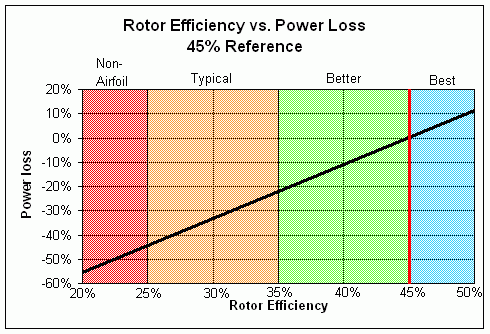

I think we need to put this rotor efficiency thing in proper perspective. I also think that we sometimes forget Mr. Betz who says the best we can do is 59.3% efficiency, not 100%.
I suspect that most of the rotors produced by people who frequent this board fall into the typical range. Increasing this to better than 40% is certainly feasable and practical with use of a proper high L/D airfoil.
Lowering the TSR will improve efficiency somewhat but most of the efficiency gain would come from a good airfoil.
Concerning alternators. Changing from a TSR of 6 to 4.5 would require a more powerful alternator of about 25% because of the lower RPM for a given wind speed. However, if we improve the rotor efficiency from a typical 30% to a better 45%, we have 50% more power to drive the alternator to a significantly higher output.
What's the bottom line? The Coefficent of Performance (Cp) could be improved from a typical 0.2 to better than 0.3.
