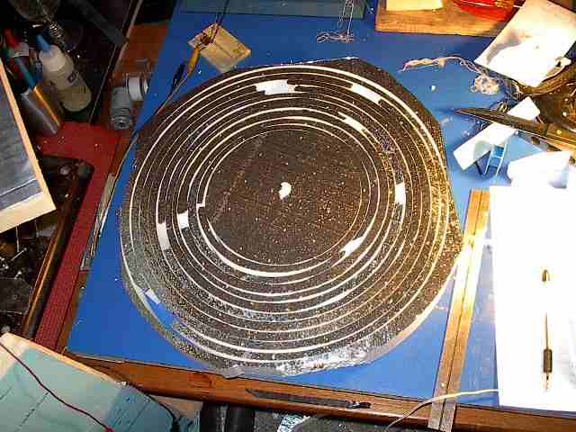

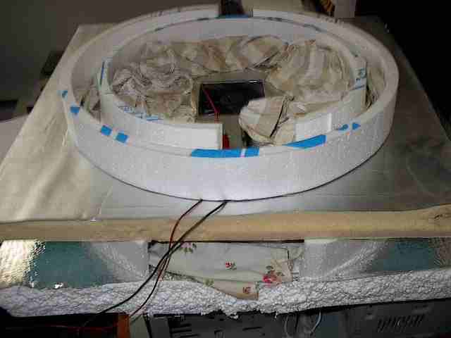

I've finished the dual two stage evaporative cooler
below is a pic of a single two stage cooler that  i came up with.
the hot air enters the top stage ,from the back  gets sucked down by the 12v muffin fan and blows the chilled air out the front on the bottom.
On top of what you are looking at goes another sheet of foam, and then another two stage cooler on top..
i just use wet rags and it goes like this all night
This may just be wet bulb temp (75.9)but it is a darn sight cooler than the ambient (91.8)temp .
the probe for the top reading actually reads 1 degree colder than it really is so the chiller temp is really 76.9F about 24.5C

the outer circles are 16" dia approx. they vary though
here  i cut them out with a hotwire..
« Last Edit: July 18, 2006, 06:00:01 PM by willib »

I don't see how that is "two stage".
I see a labarynth where the air goes through several reversals, but it's just one bunch of air soaking up one bunch of water and emerging cooler and moister than when it entered.
For "two stage" I'd have expected the moistened and cooled air to be used to cool WITHOUT moistening some OTHER air via a heat exchanger, then being exhausted as reheated and moistened waste while the OTHER air is cooled further by evaporation into it.

i'll have to work on that, that would require a small water pump , which i have , and a heat exchanger , which i also have .

i was just going with what ULR suggested with a heat exchanger , that would really complicate the whole thing though .
i would need a water resaviour insde the unit ,  that water gets cool from evaporation then i would have pump the cool water through the heat exchanger , i suppose

Don't worry about using the cool water to chill the second stage.  Use the cool air itself for an air to air exchanger.
