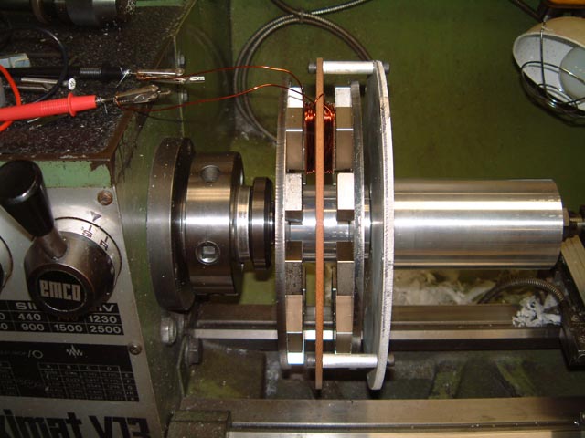

In my last post I was trying to decide on a coil design. I decided to proceed with the full coil retainer that captured the coils fully, instead of the bobbin design. In the last week I made two of these out of phenolic material, one for each side of the stator plate. I'm using 18 guage wire with a 200 C rating. Using the formula developed by Edwindstuffnow, and calculating based on a star configuration 50 turns required per coil. Of course there are two coils, one on each side so it's actually 25 per coil per side. I developed a fixture in the lathe so that I could turn both coils at the same time. There is a spacer plate in between simulating the stator plate on the fixture.
After making the coils and mounting it to the plate it was time to assemble the rotors. That was a very scary experience, not knowing what to expect with a plate full of neo's!
Luckly, I had four 1/2-20 jack screws that made the instillation a breeze.
I wanted to find out if the 50 turns per coil was enough for my targeted rpm range. I had to use the available rpm's of the lathe to do my testing.
Here are the results so far.
  1. rpm - 0.6 volts x 18 = 10.8 volts
  2. rpm - 0.9 volts x 18 = 16.2 volts
  3. rpm - 1.6 volts x 18 = 28.8 volts
  4. rpm - 3.5 volts x 18 = 63.0 volts
Based on 18 coils it looks like I will hit my 12 volt charging range at approximately 130 rpm.I hpe this is the way to calculate this? I actually was shooting for 150 rpm so not bad for a first try.
Here is a close up of the coils.
I still need to add some type of epoxy to the sides of the coils to reduce mechanical vibrations. I believe that this coil should dissipate heat efficiently.
The only other thought is that elusive star or delta. After I finish the assembly, I will wire it in both to see which one will best suite my needs.
I will finish the coil retainers this week and the the fun begins. Coils!

why the diffrent type of coils....
with those mags -and 2 in hand #14 wire 55 or 75 turns would make some great power.
  oh well...looks like you could compress those coils in a vice to make them a bit flatter..just toss them between a couple pieces of hard wood and compress the heck outa them[one at a time].... looks like a interesting alt.

Are you going to persist with this or stop now and do something better?
Considering the enormous waste of air gap and the fact that you insist on only using half the magnets you are doing very well, but the clever design and better cooling is never going to let you get anywhere near the normal output that the conventional winding achieves from those magnets.
Your method of arriving at cut in speed is wrong, but surprisingly you are not far away.
Taking your 110 rpm figure, I take it you have .6v ac from the coil so if you have a total of 18 coils you have 6 per phase.
That is 3.6v ac per phase. 1.7 x 3.6v line and the dc will be 1.4 x ac line volts
or 8.56v dc.
Cut in at 12v will be 12/8.56 x 110  = 154 rpm.
This roughly works out to a gap flux density of about 200mT. Normally the figure is around 600mT.
At the start others encouraged you to try something new and adventurous although it was obvious that your coil arrangement was far from good.
I would convert it back to 9 coils, you can keep the winding method with half of the coil on the front and half on the back and if you use a thin support disc it could be a good idea if done well.
If you insist on using 18 coils then it has to be an overlapped winding to make full use of the magnet.

what is your rotor dia
and the size and number of mags per rotor?
« Last Edit: August 03, 2006, 02:03:24 AM by willib »

Rotor Dia. is 9 inches. There are 12- 1"x1.5"x.5 N40 magnets on a 7 3/8" center.
The distance between magnets is    .935".
The target was 12 volts at 150 RPM's.
It looked like it was doing what it was suppose to do, but I guess I was wrong.

I agree that he has some good ideas, his mechanical work is excellent and there is nothing wrong with trying to produce a stator by other methods than casting in resin.
I accept that there are an infinite number of methods of winding a stator and spinning a magnet near virtually any combinations of coils will produce something, but when you get it far from optimum you need so many turns of thin wire to produce the volts that it has so much resistance that you increase the risk of burn out or you accept a tiny amount of power.
With any design, if you burn it out it is because you are greedy, have no idea of how hard you are pushing things or just don't understand furling schemes.
I have no idea what power he is expecting, but with a cut in as low as 150 rpm I assume he is thinking of a 10 ft prop, if not it will have to be very low tsr or it will stall.
Making some sort of guess at his resistance, ( which may not be desperately accurate from the details I have), with a cut in of 150 rpm, it will probably produce about 18A at 600 rpm. At which point the losses will be about 3 times the generated power. If it is well cooled, it may not burn out , but it is a miserable power for a frantic and noisy 10 ft prop running away.
If winds never get over 12 mph then in that region the high resistance will not matter a lot.
To use the magnet effectively the total flux must link the coil, When the outside of the coil fits within the area of the magnet you can't even start to approximate to reasonable use.
The surest way to prevent burn out is to make the alternator as efficient as possible, then for a given output the losses( heat) is a minimum.
I am not trying to discourage experiment or new ideas, that is why I let him get this far, I thought that now that we have figures,was the time to point out the problems and let him decide which way to proceed.
