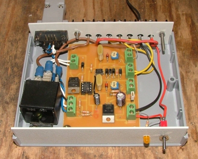

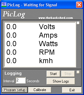

Hi All.
I built this simple data logger a few weeks ago and put the construction details on my web site. I know there are some people in the US who would like one, so here it is. I called it "PicLog".
The "PicLog" uses a 08M chip and a handfull of components. The circuit is simple and could be made on veroboard. Parts should cost less than $15, including the chip.
By itself it can work as a simple shunt regulator, but with the addition of the PC software it can record battery volts, amps, wind speed and/or windmill rpm. This data is sent from the PicLog via a 3 wire serial cable.
The PC software displays the current readings, refreashed every 3 seconds, and logs the data into text files, html page ( for viewing live data over the web ), and a Excel file.
There is also a basic graphing function.
The full details are on my web site at
http://www.thebackshed.com/Windmill/PicLog.asp
This project requires some understanding of Visual Basic, PicAxe basic and circuit board assembly. All the source code is included in the download. There is still room for improvement in the PC software, its an on going project, but as a windmill logger its been very useful. If anyone would like to improve on the PicLog, or supply circuit boards/programmed chips, please let me know.
Glenn

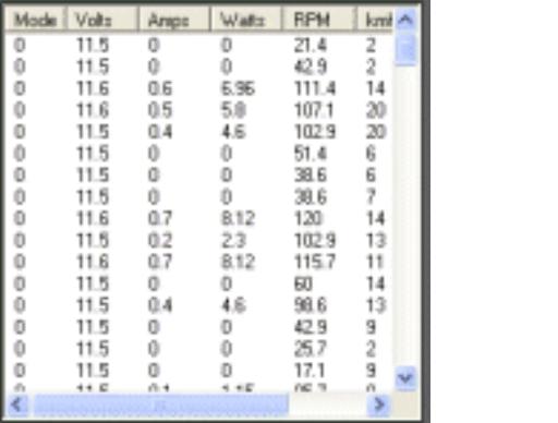

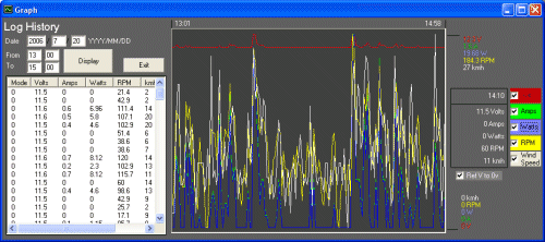

Re: Windmill Data Logger
« Reply #18 on: August 09, 2006, 09:11:46 PM »
I cant make out your data ?
Your average RPM and average KPH dont match.
what i mean is line 4 & 5 , your average max air speed for the particular data set shown (20 kph ,12.4 mph ),does not correspond with your  average max RPM line nine.
It may sound like i'm nit picking ,but not at all. i just think that the numbers should correspond , and it would bug the crap out of me till they did match.
if you sampled the wind speed more often that may help a bit.
also you need a better match between the alt and the blade set , because your mill spends most of its time not producing any power .
if it could produce power in the 6 mph range(9KPH), that would help out a lot , it may be as simple as making your blades a little smaller ( more rpm) , or adding another three coils (one per phase) , not the easier of the two choices..
have you got a photo of the blades per chance?
i am very jealous of what you have done so far , keep up the good work , some day i hope to have a similar data logger for my blades , but i need one more piece of data , torque output of the blades vs wind speed and rpm.
« Last Edit: August 09, 2006, 09:11:46 PM by willib »

gizmo
  • Posts: 370
  • Country: au
    • The Back Shed
« Reply #20 on: August 09, 2006, 09:59:30 PM »
The data files included are there for testing, and not that accurate. Wind speed and windmill rpm dont realy line up in real life, the load on the windmill is dynamic, depends on battery charge and wind speed, where wind speed is only affected by wind speed. That said, I should also mention the wind speed anomemeter is not next to the windmill where it should be, its actually next to the house about 20 meters away from the windmill.
The windmill used was a Lenz2 design on a F&P motor, and not well matched at all. Again, it was set up to get some basic data into the logger, and not a valid performance test.
The project is by no means a fully fledged data logger, but a working logger all the same. Like all the projects on my site, they are there to get people thinking, cheap to make, and used as a basis for your own designs.
You could use the Excel output to calculate blade torque. I dont know the maths but someone here might be able to help.
Glenn
« Last Edit: August 09, 2006, 09:59:30 PM by gizmo »
