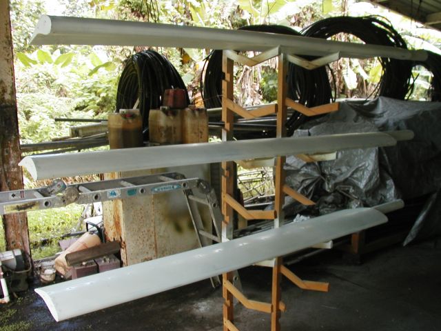

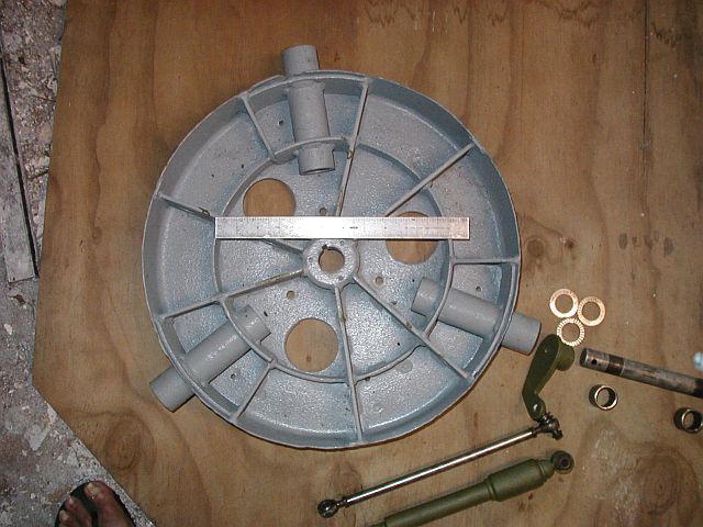

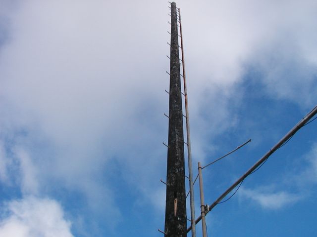

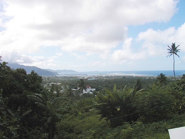

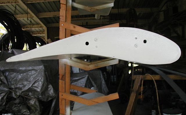

Oops, I forgot that many of you like to have pictures. These few don't have much to do with the alternator directly but they are part of what lead up to what is coming.
This is looking toward the direction of the prevailing trade winds at 450 feet MSL.
It all goes up on this at about 60 feet when done.
The 16 foot diameter rotor aluminum blades on the paint rack.
This is the airfoil used. Looking at the blade end less molded tips.
Some parts of the variable pitch hub after coming back from the galvanizing shop.

SamoaPower, real nice wings you have there. What is the weight of one. I will be following your future posts.

They're 11.1 lb each with a fresh seven-coat paint job.
These have already had four years flying time and have proved themselves well. When I stripped them down, I checked very carefully for any fatigue cracks and found nothing.
The planform is a constant 13" chord and the airfoil starts at 25% of the mounted radius. Using variable pitch lets you simplify things somewhat without much penalty.
