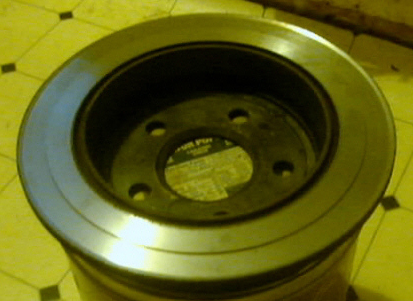

Well, I thought I would give this a try and see what I learn.  I don't have much money so everything is as close to free as I can get.  The rotor is a rear brake rotor from a Pontiac Grand Prix.  Since I work at a Pep Boys, I put the rotor on the brake lathe and cut a channel in it for the magnets.  The hub/bearing assembly came from a local boneyard for $6.  I bought a set of 29 neo magnets off e-bay for $13.50.  They are small, 1/2" by 1/8" discs.  The wood I have had laying around for some time.  Instead of buying sheet plastic, I am collecting old washer solvent bottles at work and cutting them apart.  Not the ideal size, but I will make them work.  I also bought a three pack of magnet wire from Radio Shack for $5.  I am planning on building a VAWT along the lines of the one on the bottom of the VAWT page on otherpower.com.  I am going to build it with interchangable air foils so that I can see what design performs the best.  Since my money and fabrication skills are both limited, it will be a bit on the crude side, but there will only be one direction to go from here.  LOL!  I am looking forward to the journey and also to learning and making some new friends.

Look at Willib's diagrams, concerning magnet and coil spacing. The magnets are too low on surface area.
Remember, the thickness of the coils should not be thicker than the magnets.
You need bigger magnets.
Without bigger magnets, it plain ain't gonna work.

Thanks, Ghurd.  I will have to check around and see what is available.  I will have to wait until later this week(payday).  I am extremely grateful that people such as yourself are willing to help out a newcomer.  Thank you!

 Keep those small mag's.They will work in a small
motor conversion.

Thanks, Elvin.  I am looking for larger magnets right now and I will keep the smaller magnets, even if only for fun.  LOL!
