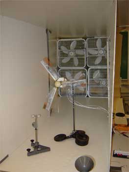

The Wind Tunnel - for low velocity and low cost
Note fans draw air through the tunnel to avoid turbulence.  Constructed of art foam board with an inverse contraction cone at exit.  No contraction cone at air supply means students need to stay away from the opening to avoid inbound turbulence and other unwanted variances.  You can also see a three prop turbine built from acetate sheets around aluminum air foils from the craft store.  Haag-Streit anemometer in left foreground, and strobotach reflector in right foreground.

Hey great.
I like that 4 box fan wind tunnel
Let us know details on everything including how the tunnel works!
I am thinking of a tunnel design myself  but since I don't plan to be home anymore than required for the next few years I am very hesitant to build anything not portable.
