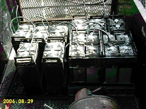

  • A 24V 800Ah nickel-iron battery bank (probably). Reasons for this cell type is given in this posting. But it's mainly for it's ability to handle regular deeeep discharges, as that's probably going to be it's main mode of operation there.

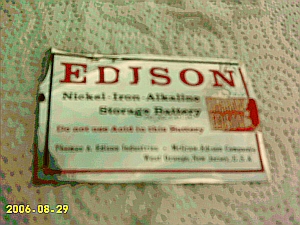

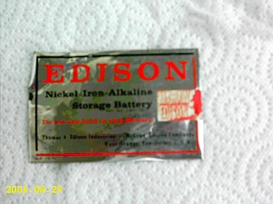

There's little info on NiFe cells around, and I intend to go and collect some decent data. All I seem to find on the internet are either just whispers, a cut and paste of a single 20 year old battery FAQ or references to the original edison battery. The logging spreadsheets I've seen on the site that sells the pentametrics look excellent - you can do a lot with that system. I'm going to try and pin down overall cycling efficiency of the NiFe cells and experiment a bit with charging regimes. For example, is it the last 20% of capacity that causes the ineffeciency when charging? What happens to overall efficiency when you only charge to 80% 6 days a week with a top-off to 100% with the genset once a week? How does a slow charge to 1.5V float voltage without boosting to 1.7V go with regards to efficiency capacity available? Stuff like that. If it all goes hideously wrong with the NiFe cells, I've enough cash/resources to go save up and get a lead-acid set to replace it in a few months.

I don't think much of the battery data for lead acid is relevant to NiFe.
Most of the effort with lead acid is directed at obtaining a reasonable life.
In the days when Nife were common they were not often floated. They were generally hammered up to gassing point when power was available and discharged until you couldn't live with the low volts.
Efficiency is low normally and probably dreadful if you mess about keeping them above 80% at all times. If you have enough power to keep them up there then efficiency doesn't matter.
If you have to run a generator I would suggest you do so when you need big loads and charge the batteries as far as you can when it is running. When running the generator it will be more sensible to run big loads direct, not via battery and inverter ( You can do it via inverter on sunny days).
At best I think the overall efficiency power wise for NiFe is below 50%. AH efficiency perhaps 60%.
