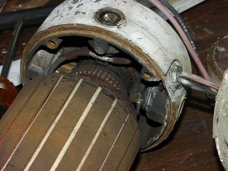

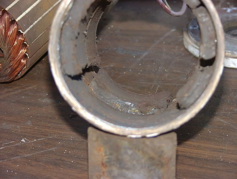

Well, I finally got the powerhead on the wind-genny torn apart. Although the bearings were indeed toast, they were still free spinning.
Turns out the problem was rust related. Specifically rust getting under the magnets and busting them loose from the housing.
Final tally:
Two busted/free floating magnets: http://i2.photobucket.com/albums/y32/Phssthpok/generator/windmill/genny031.jpg
And one free floating whole magnet (seen here propping up the housing): http://i2.photobucket.com/albums/y32/Phssthpok/generator/windmill/genny030.jpg
In addidtion, while the four brushes seemed to have a fair bit of life left in them, I'm not sure the same can be said for the commutator. Quite a bit of wear here: http://i2.photobucket.com/albums/y32/Phssthpok/generator/windmill/genny032.jpg
Top that off with two of the housing bolts shearing off when I disassembled the powerhead, and I'm not sure if this thing is worth rebuilding.

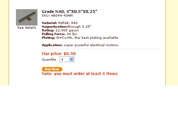

Do you think some long skinny mags will work?
these are 4" long by 1/2" wide by 1/4" , and magnetized through the 1/4" .
depending on the origional gap it might work ... and they are a little pricy for sure

Well, I decided to try and get this thing cleaned up and back together using the old magnets, so I began removing the already loose magnets tonight.
No joy. This thing is dead as hell. One of the mags that broke in half also began to de-laminate. That is to say it began flaking apart in layers.
Combined with the busted housing bolts (rust) and the thoroughly toasted bearings, I'm going to declare this unit "not worth the effort" of rebuilding. At least not right now.
