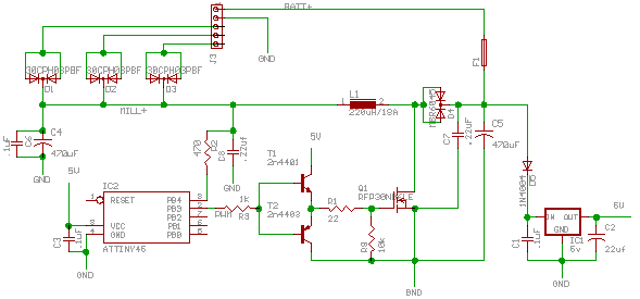

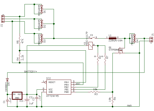

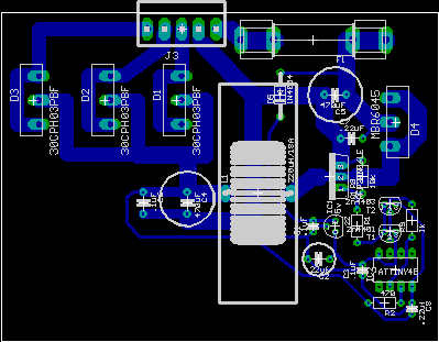

I'm going to build boost curcuit based on the ideas in Flux's post-
http://www.fieldlines.com/comments/2006/3/17/185646/194/25#25
This isn't the "all in one" curcuit that Flux has posted most recently but the one that operates in parallel with the full power rectifier that's normally connects to the battery.
... this is for a 10 foot mill with a 250 rpm, 12.5 mph cut-in for 24 volts. I expect about 175 watts, 7 amps, at 250 rpm so that's a reasonably small current to layout on a home brew pcb.
I've tried to do my homework but I'm not an analog guy. I lack at the practical matters that real engineers understand so all feedback will be greatly appreciated. (I'm willing to accept that the entire thing may be 100% wrong!)
Here's the schematic -
The little microprocessor connects to everything...
I power the processor from the battery side. A voltage regulator that take up to 30 volts input is required; not being sure how high the battery voltage might peak, I put a diode in front of it to give a little bit of voltage drop in front of it.
I'm not sure if the disconnect relay is needed or not. It's conceivable to me that the two schottkys might have less of a voltage drop than the diode in the high power rectifier and conduct higher currents than I want when the curcuit isn't boosting. (Though I suspect that the coil will add enough voltage drop to limit the current flow.)  At any rate, if the relay isn't needed, it can be left off (and the the power requirement of the processor itself is so low that it could be powered from a 5.1v zener diode.)
The relay coil needs 40ma at 5v. That's the "absolute maximum" for a single microcontroller port pin so I paralleled two ports with current leveling resistors to play it safe. The ports are capable of both sourcing and sinking voltage but the voltage level shift is about half as much when sinking as it is when sourcing higher currents.
The chips supports bipolar differential input on its analog to digital convertor. The output on one coil is run through a voltage divider to keep it within range off the adc input. The generator rpm is slow enough that the processor can compute peak to peak voltage and rpm.
Duty cycle to the FET can be computed from input voltage. I'm not sure that I understand the gate-source curves on the spec sheet but it appears to me that the FET will conduct somewhere between 20 to 40 amps with a 5 volt gate voltage so I think that it can be used without a high voltage driver.
Coil - I got some ferrite e-cores with a 1mm gap. Put together to make an EE core, that'd be a 2mm gap. I can compute the turns to make a 200uH coil but the data sheet doesn't give the info in a way that I know how to calculate saturation current. So as a fallback, I've done the math for an air core inductor and found what I think is the perfect sized bobbin in the form of a small wire spool from RadioShack. The spool is a little more than 2 inchs diameter, a little more than half an inch wide. About  8 to 10 meters of #21 wire four in hand will fit on it make a coil between 160 and 220uH.

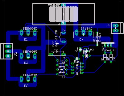

I did a test layout to see if it all fits on one side. Things are a bit loose in this layout because I don't know how large the heatsinks are or need to be. The wide trace widths should keep temp rise to 30c with 1 ounce copper, half that with 2 ounce.

Scaling the image size on the page causes some the horizontal lines in the scheamtic to disappear (in my browser.) If it looks whacky, you can view the full scale image directly in my files section (or "right click" on it if your brower supports that.) - Ed.

« Reply #2 on: October 10, 2006, 10:27:16 AM »
Sorry I can't help with the microprocessor bit, but you will have to do something about the mosfet gate drive.
You will kill it with a high impedance drive. During rapid switching, miller effect will induce spikes in the gate from the drain voltage and kill it. Keep gate drive impedance as low as possible ( 100 ohms absolute max ) . If you must use a high impedance drive then connect a 15v zener directly to the gate, but even then it will switch slowly with high losses and sometimes the zener causes ringing and the gate may still be damaged.
Add a pulse capacitor about .22uF between source of fet and cathodes of D4 as close as you can get it. You may need a few hundred uF of electrolytic across the dc out.
You probably need a few hundred uF across the output of your schottky input rectifier to ground with a .1uf across it, otherwise you will have mess all over the leads from the alternator.
Otherwise things look fine.

« Reply #3 on: October 10, 2006, 02:04:07 PM »
I'd hang a cap to ground just upstream of the relay - electrolytic plus a ceramic for high frequency bypass.  That will keep the high frequencies from showing up in the wiring to the mill.
I'd also hang another set of caps on the + "output", and bring + and - from the battery side of the bridge in on the same connector as the alternator, to keep the high frequency stuff off the battery and house wiring (unless you intend to use the booster as an impromptu desulphator).  While the battery makes a capacitor unnecessary for rectification, it has too much impedence to keep electrical noise down.
I'd also fuse the + "output" line near the connector.  Otherwise a component failure or defect on this device could pull heavy current from the battery and start a fire.  (Having a fuse here also makes it more important to have output filtering.  Otherwise the output pulses could, perhaps over months, cause fuse failure.)

« Reply #4 on: October 10, 2006, 02:04:15 PM »
Flux is right about the gate drive. The problem is that in order to keep the switching losses low, the FET has to be switched quickly. The input capacitance of the FET is substantial, typically 1-6 nF. Charging and discharging this C quickly is the issue. You have to supply and sink peak currents of 1-3 Amps to do it so low impedance drive is necessary. Higher gate voltage also helps. Here's a simple driver that will do it:
You may want to put in a few ohms between the emitters and the gate.
I don't see that you have any provision for current feedback to control PWM.
« Last Edit: October 10, 2006, 02:04:15 PM by SamoaPower »

« Reply #5 on: October 10, 2006, 02:10:39 PM »
You need a full bridge of schotkeys, to feed the negative side of the switcher (and the caps I described earlier) if you want to avoid the voltage drop of the negative side of the main bridge.  That also implies another schotkey on the negaitve side of the output, with the negative side of the switch floating about a schotkey drop above the battery, if you don't want the schotkey on THAT side bypassing the other half of your main bridge.

« Reply #6 on: October 10, 2006, 02:59:33 PM »
The low inductance high pulse capability capacitor from the mosfet source to cathode of D4 is vital. It needs to be a high pulse duty polypropylene or a ceramic.
Without it, the circuit will have so much stray inductance that when the mosfet turns off the energy in the inductor will cause a monster voltage spike across the mosfet.
The capacitor will limit the spike.  The loop consisting of the mosfet, D4 and the capacitor should be as small as possible to keep the inductance down and if you use a double sided circuit board, an earthed ground plane under this area will lower the inductance. This is the critical region, other capacitors can be placed in convenient places.
Samoa's driver circuit should be fine, but if you only have 5v drive then you will need a logic level mosfet.
I have no idea how your digital bit works, you obviously have no current feedback, I can only assume that the ac voltage fed to the processor is in some way developing a speed signal.
I used conventional diodes for the auxiliary bridge. Schottkys may make a marginal improvement but at 24v I doubt if you will see much difference. Not having Shottkys in the negative arm of the bridge will make little difference.
If you start introducing Shottkys in the converter supply bridge you may need the relay as the drop via the converter may become lower than via the main bridge, but a tiny bit of resistance would likely solve the problem with negligible loss. I personally think the relay will be a hindrance rather than a help in the long run.

hmm two diodes in parallel will not work , one will conduct before the other, so the other diode is a waste

Hi ibedonc, you wrote:
"hmm two diodes in parallel will not work , one will conduct before the other, so the other diode is a waste"
Well, that's why I wanted to put real part numbers on a circuit, to move the designed from theory to implementation. (Though I realize that Flux has been using something like this with analog control for quite some time.)
The MBR6045 data sheet says "Terminals 1 and 3 May Be Connected for Parallel Operation at Full Rating"
I think someone posted on the board why it does work during a thread on using bridge rectifiers as legs of a three phase rectifier...

Diodes have trouble in parallel because their current isn't linear, but a sharp "knee" up at the bandgap voltage.  Even a very slight difference in the bandgap (due to very small process or temperature variations) can cause a large imbalance in the division of the current among the paralleled diodes.
But if the diode are from the same lot - or better yet, on the same chip and not cut apart - and are on the same heatsink, they balance just fine.
This dual-diode is probably just such a device:  An integrated circuit composed of two diodes.  Completely balanced and capable of full rated current if the two diodes are paralleled - just as if they were the right and left half of a single diode.

Hi folks,
I really, really appreciate all the feedback. The FET drive and filtering are areas where I am particularly inexperienced. I picked components mostly because I already have them sitting on the shelf. I can see the wisdom of not using schottkys on the input rectifier so that I can get rid of the relay and I think it may be worth spending a buck on a logic level FET rather than putting a second DC supply on board. (Also think that a fuse and connectors on the sames edge of the board are pretty good ideas as well.) I'll revise and repost ...
Samoa wrote:
"I don't see that you have any provision for current feedback to control PWM."
Maybe I'm wrong but I figured that I could calculate the rectified voltage by measuring the peak to peak voltage on one of the input legs. (Perhaps something like PTV volts/2 x .9 ?) From the input voltage, the processor can calculate (or look up in a data table) the duty cycle needed to boost the input voltage to battery voltage and then to shut down the PWM when the input voltage is high enough.
I could measure RPM but then the processor would need to know how to convert RPM to volts ... seemed to me that the processor could just measure the input volts directly.
Originally I had the ADC measure the volts on the booster side of the rectifier but figured that that side would be noisy from switching. I had a low pass RC filter on the analog input but didn't have the filtering capacitors from rectifier positive to ground that folks have recommended... Maybe with the caps in there now I can switch back to measuring the rectifier output directly.
I could measure current at the battery but figured measuring input voltage saved using a shunt or other current sensor... hope that makes sense!
 - Ed.

« Reply #11 on: October 10, 2006, 09:08:47 PM »
Hello Ed,
I follow this with great interest because I am currently designing a system/battery monitor / solar charge controller w/MPPT / dump load controller using an AVR (ATmega48). After I get that done, I'll go for the wind generator controller using the same chip. I've studied the AVR pretty thoroughly now (including the ATtiny45), and have quite a bit of experience programming (though new to AVR), so if you have any questions, I'll be glad to try to help.
I really like the tiny45, it has PLL to run the PWM at up to 64MHz (8-bit resolution at 250 kHz), differential input and 20X gain on the ADC (very useful for the current input), and it's cheap, although the mega48 is pretty much just as cheap and has a lot more pins (28) and a 16-bit timer.
So, what speed are you planning on running the PWM ? Are you using C or AVR assembly ?
For your relay, I would just use a MOSFET; it has much lower drive requirements, and since you are not turning it on and off fast, the gate capacitance is of no importance. For the design that is currently in my head and partly in computer files, I originally thought it would have a relay to enable the controller, but later decided that the buck MOSFET would do just fine. Even if I were just doing a boost controller, I might just skip it.
Flux (and SamoaPower) is right about the turn-on and turn-off of the MOSFET. At the very least, follows Flux' recommendation about the parallel capacitor, and if you are ambitious, you might want to consider soft-switching (zero-voltage turn-on and zero current turn-off). This takes another MOSFET and another (quite small) coil, but it greatly reduces the stress on your primary MOSFET and increases the efficiency of the boost converter a bit.
For those that commented about feedback for the PWM, things are different here from hardware PWM chips. By inputting the battery voltage and wind genny RPM (you don't really need the wind generator voltage; you'll know that close enough from the RPM), a microcontroller can easily compute what the duty cycle needs to be and have the other 98% of it's processing time to sleep.
By the way, when I first starting investigating this, I thought it would be great to have the microcontroller update the duty cycle really fast, and feedback on the output current to get maximum power, but this is unnecessary. The inertia of the rotor also causes problems with MPPT since an increase in the duty cycle (buck or boost) will instantaneously give more power, but it is just bleeding off some energy from the rotor inertia. Now I'm thinking about 2 to 5 Hz or so, without current feedback. Since the TSR plateau is pretty broad (about +/-10% from optimum RPM), it does not have to be tracked that closely.
Keep us posted and best regards,
Dave

Take this with a pinch of salt, some digital things work when I can't see why.
The peak ac volts of the alternator off load are proportional to speed. When the diodes are conducting the peaks are bitten off first so peak voltage will be a mess.
Mean volts may be good enough to tell you the speed.
Boost converters are energy converters and the relationship between pulse width and voltage out is very load dependent. It is probably not adequate to choose pulse width to match battery volts. You need to match it to the power level at each prop speed. You will need somehow to find the pulse width at each speed to provide the power match. If you can do this then you can use the look up table.
I suspect that is the data that Windy Boy and other inverters need to have programmed into them. Once set up for an alternator it's ok.
I think this is why the current feedback works, the volts are fixed by the battery so current gives a reasonable indication of power. If you can measure current and calculate the required power for each point for your table then I think you can do it.
« Last Edit: October 11, 2006, 12:57:14 AM by Flux »

« Reply #14 on: October 11, 2006, 08:06:16 AM »
There's no magic in the digital circuit, if the approach is wrong, it won't work...
I've been referencing this online boost converter design app at coilcraft -
http://www.coilcraft.com/apps/selector/selector_1.cfm
It says that duty cycle is ((Vout+Vdiode)-Vin)/Vin .... there's no reference to current in determining duty cycle.
I don't know what's going on underneath the application but I was thinking that it's assuming a fixed output voltage because it has current ripple at the output as a design parameter, not voltage ripple.
I really think that current monitoring and voltage monitoring will product equivalent results because there is a one to one relationship between both power available at a given RPM and alternator voltage at a given RPM.
Okay. So switching currents will bugger the voltage reading. The max sample time on the analog converter is 260uS so the processor can just turn off the FET for a millisecond, take the voltage reading and then go back to switching. Since the mill can't change speed that quickly, I imagine that the sampling frequency could be quite low.
The main reason that I want to look at input voltage and not rpm or current is that I think both of those approaches require the circuit to know something about the alternator and mill in order to be "tuned." Input voltage boosted to output voltage would not; it would be "plug and play" and might be useful to other folks less technically inclined like me... the circuit would just need to be soldered together and it only takes four pins wired to the parallel port of your PC to program the chip.
As always: Nothing I've written should be taken as an indication that I know what I'm talking about! ...if all that's wrong then the circuit can be made to measure RPMs or battery current.

« Reply #15 on: October 11, 2006, 08:33:10 AM »
You seem to be basing your ideas on a boost converter power supply that is regulated at constant voltage.  The load determines the current and the pwm changes to maintain constant volts.
In this case the wind determines the available current and you need to track the pwm to maintain the available current at a voltage ( prop speed ) that lets the prop develop the current to run at the chosen speed ( top of Cp/tsr curve).
You have to know something about the machine characteristic. You can try to calculate it at each point which will be very difficult or you can learn its characteristic over a series of measurements and store the characteristic in a look up table. That seems to me to be more likely to succeed.
In theory you could use wind speed and you ought to track alternator speed with wind speed, but wind changes so rapidly that it would take weeks of data to sort out the characteristic. Once you have found the curve then wind input is not required. It is so difficult to use that wind speed is probably best avoided.
Get the converter working and try it, I am sure you will learn so much quicker from practical results.
I have used speed as a control signal so you should be able to do it from volts into the converter, but I don't see it as being a one fits all situation.

I think that I've been able to incorporate every change suggested... Thank you all very much!
I also put a low pass filter on the input of the analog to digital converter.
I changed a few part numbers - made the input diodes non-schottky (but fast) diodes to get rid of the need for a relay and I changed the power FET to a logic level FET to get rid of deriving another (higher) DC voltage from the battery input. I'm not experienced with the part numbers referenced; I pretty much just went to digikey.com and looked for parts in stock. (The diodes could be any "good" choice in a TO-247 or TO-3P package, the FET any good choice in a TO-220 package.)
The new layout is a few tenths wider (4 inches by 3 inches) but gets the switching components closer together.
Flux wrote: "I have used speed as a control signal so you should be able to do it from volts into the converter, but I don't see it as being a one fits all situation."
Sorry, I didn't mean to imply that it was universal when I said "plug and play" but I did think that it has a wider applicability than my one mill. I got the notion when I noticed that the 50 turns of #15 wire, two in hand, that I'm using is the same thing that Hugh P. recommends for the 24 volt version of his 8 foot mill. I was thinking that, perhaps, if other folks who built the 24 volt version of 8 foot mill wanted to get a little more power that they could rebuild a 10' footer with their existing alternator and use a boost circuit like this...
In any event, give or take additional feedback, I'll make a booster and see what it does.
Thanks again,
- Ed.

stephent
  • Posts: 268
Re: Building a voltage booster
« Reply #22 on: October 12, 2006, 04:47:26 PM »
Nice project and good looking artwork.
But I've been wondering if your stator winding is a star?
I can see the 3 phase wires going to the input diodes--but where is the common/ground (dc-) being developed from the genny?
« Last Edit: October 12, 2006, 04:47:26 PM by stephent »

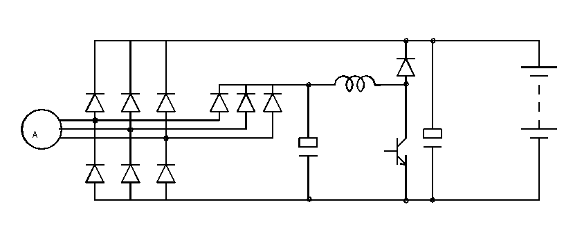

Hi Stephen,
This is a "low power" circuit that operates in parallel with the normal high current rectifier. The five inputs connect to the five terminals on the the 3-phase bridge (three input phases, and plus and minus) and it only operates when the voltage is less than the battery cut-in voltage. It uses the dc-/ground through the main rectifier and gets the path through the "ground" input.
This is seen in this diagram by flux -
 - Ed.
« Last Edit: October 12, 2006, 05:05:12 PM by elt »
« Reply #28 on: October 13, 2006, 01:09:08 AM »
Your voltage signal filter to pin 3 seems to have got mixed up, the resistor is in the wrong place.
The input diodes don't need to be fast but it will not hurt. They do need to be fast in the later version I mentioned boosting through the rectifier.
Do you have a test rig to try it on or are you going to try directly with wind?
Whatever you do, don't try the converter on a non current limited power supply, it relies on the alternator for current limit.
Look forward to results.
« Last Edit: October 13, 2006, 01:09:08 AM by Flux »
