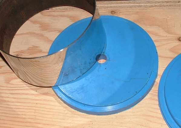

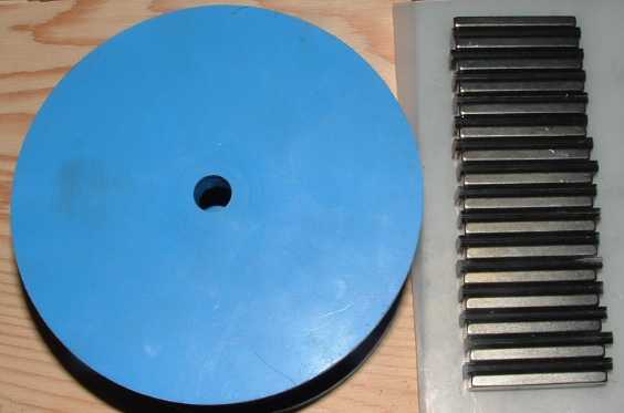

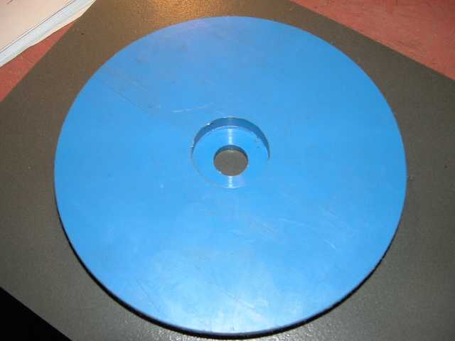

The following plate was made without a lathe yet it is very precise. The material used here is 1/2" polyethylene (Puck board).

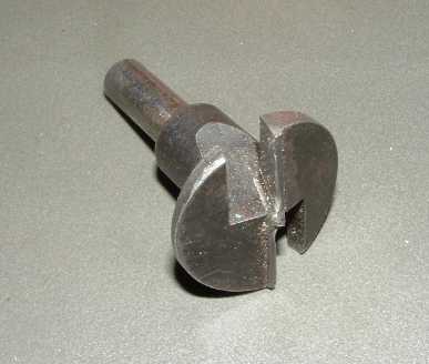

The bit pictured here is used for European style cabinet hinges. The drill press depth setting sets the shoulder thickness.

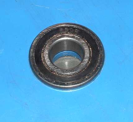

A very common 6202 sealed bearing fits snuggly into the hole.
Using the bearings accuracy I turned the outer edge. I clamped the bearing tight to the top of my table saw and slowly rotated the puck board. After each rotation I raised the blade height 1/8". Thus a precision end plate. I have also used aluminum, slower with cutting fluid but much harder.
Joseph.

Could use a router table with a straight cut bit as well.
I just gotta get me a lathe though.
Those Zubbly conversions are calling me.
That bit looks kinda like a Forstner bit.

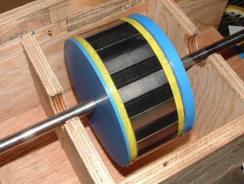

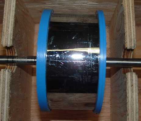

Vawtman, I am using them for end plates for the pvc stator, my RACA ( Radial Air Core Alternator) . I could have used a lathe, but not everyone has a lathe or access to one. This makes the project a challenge but not out of reach for most DIY people.
Joseph.

you could also use a dremmel on the permeter of the puck to turn its diameter , i've done that

You built a basic lathe.  =)
Rotating workpiece, with an external cutter.
A drill press is another method to make an improvised lathe.  Run a bolt through a center hole in the workpiece with a nut to lock the piece to the bolt, and then chuck the bolt in your drill press.  Clamp a cutter in a vise located for the correct diameter, and use the handwheel on your drill press to feed the part past the cutter.
Drill press bearings aren't designed for side thrusts of cutting like this, so be sure you take very small cuts.  It's not the most efficient way of turning a diameter, but it will work.
