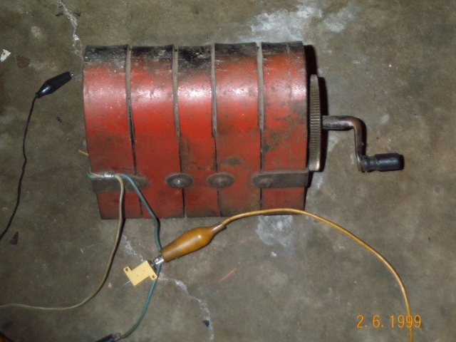

My latest generator.  It will make 60 volts with ease, a lot more and I saw 85 volts, but the best I have managed is only 45 ma. current output.  I'm wondering what blades I should use with this one.  (Actually I was back up home last week helping to clean out the barn and this was one of the treasures that followed me home. They claimed this was mine, but that was so many decades ago I really don't remember it.)

An old telephone ring generator. I got one just like it. Watch out you don't get the fingers in between the pinion and gear. It hurts .

Wow a 5 bar! those were usually only used in phones that were on very long rural lines, a great find. If you need any help, phones are my "thing" I sell, install and repair phone systems and can point you to various resources.

Stonebrain, there is a small two pole alternator geared maybe 10 to 1 to the big gear you see on the right. On mine you have to push the handle in slightly to make the contact close. When you crank the handle the alternator really spins. Like the bicycle dynos for night lights.

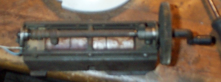

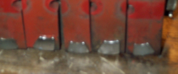

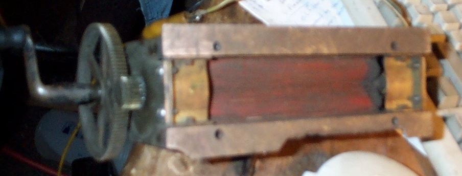

  OK, for those that wanted to see more here are the innards of this new-fangled device.  The generator has 5 U-shaped magnets that provide potential. Inside the base is a long shaft with a series of metal washers separated into four groups. Imagine the washers have a bite out of each side, leaving a gap. In this gap on each side are two coils, appear to be 30 ga. wire and about 600 turns each.  the frame provides the return path via an internal brush and the shaft provides the hot side via an insulated internal pin that contacts an external spring plate.
  The gear set provides about a 5 to 1 gear up ratio. There is noticable cogging as the metal washers pass the side plates.
  As an experiment, I placed small HD magnets on the outside of the U-shaped magnets to try to boost the magnetism. As each set was added, the cogging became more noticable.
This addition made the voltage go up at a faster rate per RPM, but the cogging was enough to make turning the shaft much harder.  I only briefly checked the current, since the 30 ga. wire is not rated for much current and I did not want to burn out a working 70 year old generator. At a glance it would make over 200 mils.  A really good spin would take the open circuit voltage over 210 volts.  As always, a compromise between flux density, coil turn count and wire gauge would have to be worked out to build a modern day replacement.
  All in all, this is still a working tool, and it is fun to see how it was done decades ago.  As a final test, I hooked it to an old dial phone, (105 volt ring, 48 volt talk circuit)and was able to ring the phone with a good spin on the crank.
