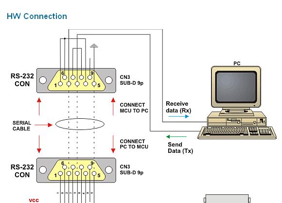

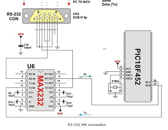

Re: Boost converter, pwm and mppt
« Reply #36 on: November 29, 2006, 11:10:09 AM »
its a pic to pc RS232 connection , which i could use my laptop to collect the data
it stores the data in a text file on the laptop
i can use the 16F877A in place of the 18F452, and use two transistors and some resistors to emulate the MAX232
« Last Edit: November 29, 2006, 11:10:09 AM by willib »

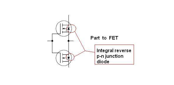

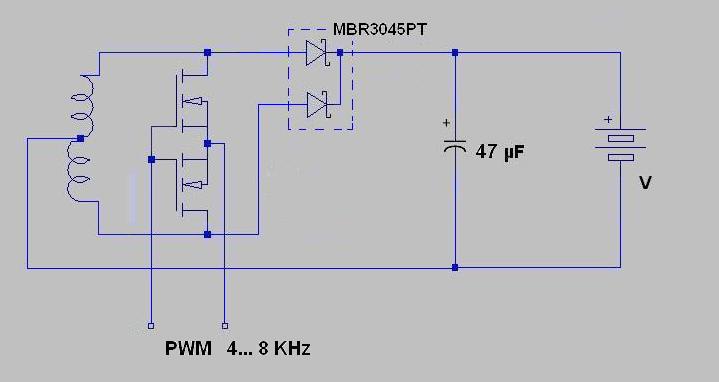

A=B ,
what happens when the upper part of the phase is negative, and the lower is positive?
the body diodes will conduct , and short the alt for that part of the cycle,i know ! i allready suggested a similar scheme  to Flux..
btw , why are you using two fets stacked like that ?
the source dosn't like being that far from ground because it is harder to turn it on
« Last Edit: November 29, 2006, 11:42:45 PM by willib »

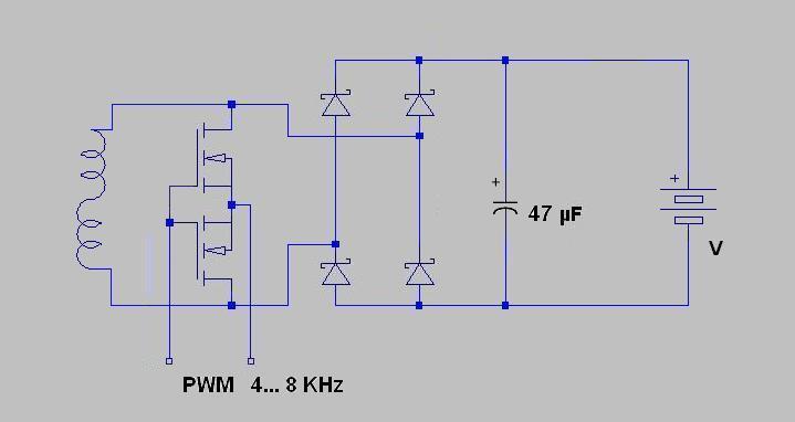

AequalB
  • Posts: 9
« Reply #42 on: November 30, 2006, 01:59:35 PM »
Why are using two fets?
It is inevitable in circuits of an alternating current.
http://www.otherpower.com/images/scimages/3237/o.JPG
« Last Edit: November 30, 2006, 01:59:35 PM by AequalB »

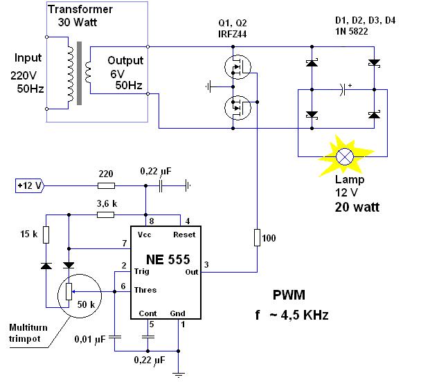

AequalB
  • Posts: 9
« Reply #43 on: November 30, 2006, 02:07:49 PM »
It`s working:
« Last Edit: November 30, 2006, 02:07:49 PM by AequalB »

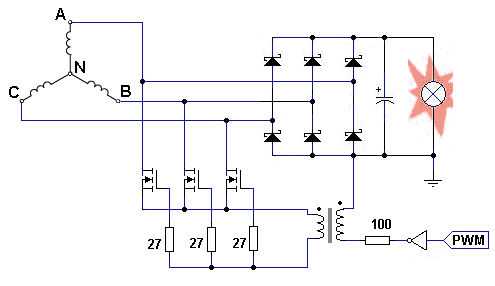

« Reply #44 on: November 30, 2006, 11:19:03 PM »
Thats an interesting circuit!
i did not know the lead between the fets was ground.
i'm wondering whether or not you could connect that lead to the center tap of a wye connected three phase alt?
that sort of looks like a sync rectified boost converter
how would that look in three phase?
« Last Edit: November 30, 2006, 11:19:03 PM by willib »
AequalB
  • Posts: 9
« Reply #45 on: December 01, 2006, 02:15:37 PM »
it`s simple...
« Last Edit: December 01, 2006, 02:15:37 PM by AequalB »
« Reply #47 on: December 01, 2006, 09:26:59 PM »
i got the RS232 connection  to work!!
it took two hours and 8 mins
this is soo cool
i can now read the data comming from the PIC16F877A at 9600 baud , i havnt tried a higher speed yet
i coppied the program from the pascal Pic USART library
loaded it into the PIC
i used two transistors and two resistors to emulate the Max 232 chip , and a little fiddling around and i'll be damed but everything i sent to the pic came back..
which is what it was supposed to do..just resend everything it recieved .
when i finish with the program ,i could read analog voltages such as battery voltage , current from the hall sensor , RPM from a hall switch , and hopefully wind speed , and log everything on the laptop.

I'm sure I pointed this out before, but I'll do it again. What do you have in the way of a driver circuit between the output pin of the Pic and the gate of the fet?
To charge and discharge the gate capacitance in a timely manner (nanoseconds, not milliseconds), you need a peak drive current capability in the order of one to two amps. Also, the pic runs off 5 volts. Unless you're using logic level input fets you'll need a level translater to get the gate drive voltage (typically 12-15 volts).
MPPT; maximum POWER point tracking. Power is volts times amps. For all practical purposes, you can treat the battery voltage as a constant. Therefore, you can use the battery current as the target variable, and increase/decrease pwm to get maximum battery current, which will also be the maximum power point. Just to repeat what was said earlier in this thread.
« Last Edit: December 31, 2006, 11:19:00 AM by commanda »
« Reply #50 on: January 17, 2007, 06:15:35 PM »
Amanda , welcome back!
i didnt see this earlier
i am using a logic level FET IRF3703 very low RDS(ON).
the PIC is driving the FET directly
i am looking for an appropriate Fet driver ckt though
any ideas?
