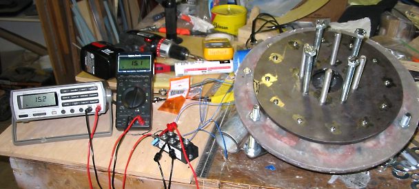

I'm slowly working on my first mill. Some advice given when I started it was to build the alternator first because it would be easier to match blades to it rather than the other way around... Okay, I've got the alternator put together and I got my two best DVMs out the measure volts and hertz so I could figure out cut-in RPMs.
When I had them both in hertz, the agreed. I put them into AC, they didn't... (They profess "true RMS".) Call the meters "A" and "B"
Hz    A     B
  1.   9.6   8.8
  2.  12.2  11.3
  3.  14.7  13.4
I also got a third meter and read higher than A or B but it didn't claim to be a true RMS meter. I stuck all three into an AC socket and got 120, 117, and 120 volts from A, B and C respectively. A and B differ by 2.5% on the mains but by 10% on the mill. C was accurate on a pure sine wave; makes we wonder what kind of wave my mill is making...
I hooked up a 3-phase rectifier and a 470uF cap. A and B now agree to within a tenth of a volt, better than .1% ... seems like I ought to be able to convert the DC back to RMS but I'm a little fuzzy on the details. Here's a picture of the setup -
By using the hertz readout, I get
  1. Hz, 17.8v DC, (A&B RMS volts were 12.2v and 11.3v)
  2. Hz, 21.9v DC, (A&B RMS volts were 14.7v and 13.4v)
By watching the clock, I get 10.2v RMS, 15.5v DC at 120 RPM with meter A (it's a 12 pole alternator).
The voltage drop across plus and minus on the rectifier is .8v
I can't get the formulas to match up the numbers and I'm wondering if that since there's no load on the cap, that it's charging to a peak to peak value from the rectifier; should I be using a correspondingly lower value as my DC volts?
Besides wanting to know which meter is correct, I'd really like to know my cut-in RPM is for a 24 volt system... as always, I really appreciate the help!

Most consumer DVMs are setup to read AC volts in the 50-60Hz range. If your HZ is lower (as all wind turbines I have seen or seen discussed here) you are probably not getting good readings.
I'm not sure there is a good way to test the accuracy of a meter without a good regulated source as a standard. But, a small capacitor to kill the DC ripple and measuring that is your best bet, IMO.

I still need to figure out the cut-in RPMs and I'm not sure what the DC volts read mean. With the cap in there, I'm concerned that it's reading  peak volts out of  the rectifier and that its a higher number than I should be using to scale RPMs to cut-in voltage.  If that's the case, I've goggled and googled but can't find a factor to convert rectified 3-phase peak to peak volts to RMS volts... I thought I saw something once that was like .9 PTV = RMS but I'm coming up with nothing now.
- Ed.

If you have all three phases connected to a rectifier (+ cap) then the output is not going to be a sine wave. For any sine wave: Vrms = 0.707 x Vpeak. Cut in is generaly the point at which the alt starts suplying current into the battery so is calculated usng peak voltage (which is what you are measuring with your rectifier + cap). I would go with 210RPM as your cut-in as it is a more direct measurement. Maybe your getting confused with folk who measure Vrms for a single phase so multiply by 1.414 to get the peak phase voltage then multiply by 1.732 (root(3))to get the peak line voltage for a 3 phase star conection.
« Last Edit: December 16, 2006, 01:35:44 AM by jimovonz »

Your speeds with the rectified output are near enough for your cut in speed.
Not a lot of point in worrying about the factor between ac and rectified dc volts because it is waveform dependent. The fact that two meters that claim to be rms don't agree is an indication that at least one is wrong. I have a feeling that the one that reads low on the mains is low everywhere. The difference between the other two is likely to be a waveform problem.
It is likely that the non true rms one is as useful for this as the the other. The cut in voltage is determined by the peak volts and average reading meters scaled rms are as likely to give you a decent answer as the true rms in this case. If you were measuring power into a resistor then the rms unit would be correct.
Anyway, back to the dc. With a sine wave, the mean dc from a 3 phase rectifier is about 1.4 times the rms volts, I have forgotten the exact figure, but it is quite close to the peak value of root 2(1.414).
I wouldn't bother with the capacitor and I would connect a small load on the dc side of the rectifier (100 ohms or so) as the rectifier waveforms totally off load can be strange.
Your battery will see cut in at the peaks of the 6 pulse ripple of the rectified waveform, but the current will be negligible until you reach the mean value. The same will be true of your converter, it may make a few mA during the ripple phase bet nothing serious until you reach the true mean.
This is quite different from the single phase case where cut in will start at peak and move down the waveform as you load it.
If you take the dc mean from the bridge with the small load it includes the diode drops.
Taking your figure at 120 rpm of 15.5v dc that would give a cut in at 24v of
24/15.5 x 120 = 186 rpm. Probably 190 without the capacitor.
The 10.2 vac is a bit low as the waveform tends to be a bit peaky and a true rms voltmeter would read low. The non rms voltmeter may be a bit nearer the 11v that I would expect.
