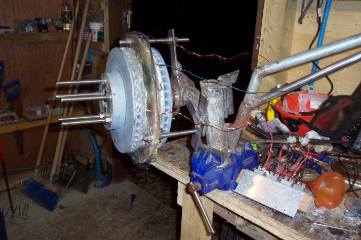

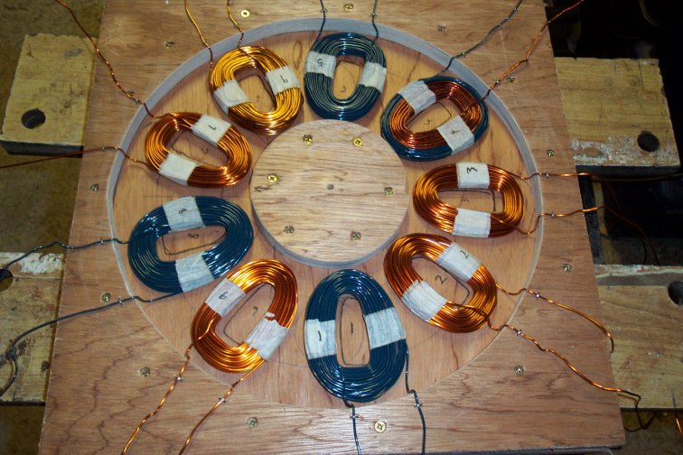

As you can see from the pics I have built a twin rotor 9 coils three phase alternator based on the earlier DanB 10 foot turbines with 2" x 1/2 circular magnets.

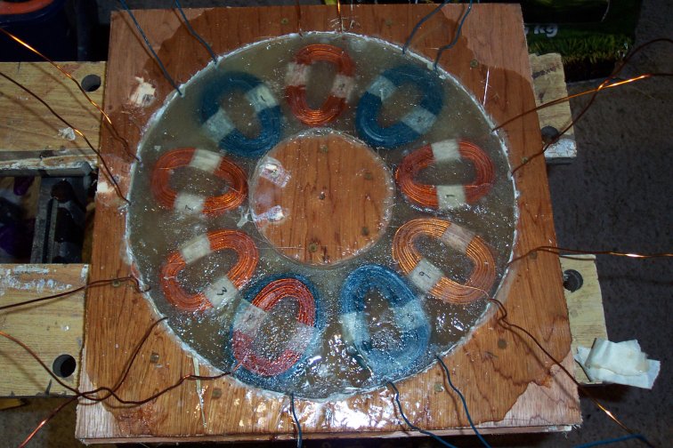

I decided to make a test stator to make sure everything fitted and the voltages worked out. You can see one of the coils is made up of two types of wire joined half way and several others have soldered joins too. I know this will probably not take much punishment but I will fly it anyway and see what happens.
To get some of the wire I broke up an old stator and unwound the coils, some of it came from a guy on ebay so I don't know the insulation properties and some came from an old transformer. I know this is not good practice but as this was only ever ment to be a test stator I'm not too worried.
Although you might not see it from this shot these coils are too tall. I made the mandrel for the coil winder a bit over two inches long thinking I would get all the flux from the magnets cutting the coil however I didn't realise until I started making the stator mould that the size of the centre hole needed to be about 5 inches diameter. This pushed the coils out so that they protruded way past the outside diameter of the magnets. For my next one I will make them smaller.
This is the stator ready to come out of the mould. I stupidly forgot to put wax or grease over the screw heads so I had quite a job getting them out.
I have 60 turns of 14# wire approx 1.5mm per coil.

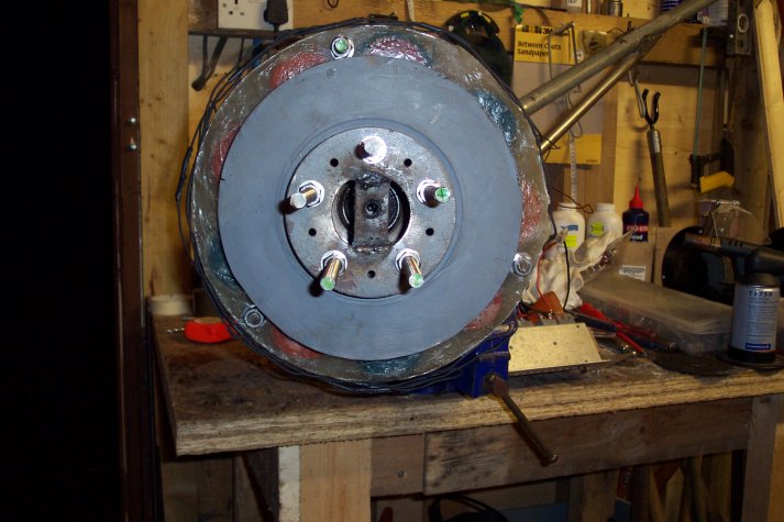

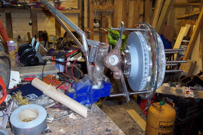

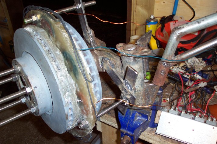

I really should tidy up my bench before taking photos. From this shot you can see the angle the tail is at. I pretty much copied the 10 footers as best I could. Due to the angle the alternator is in the vice and lack of space the tail section is not properly settled down in these shots
The piece of angle iron welded to the back of the upright is to stop the tail swinging into the rotors in a high wind.
This is a good shot from the front. You can see that because I made the coils too long they were are sticking out beyond the magnets. You can also see the jacking stud in the middle. To put the front rotor on or off I grip a length of all thread in my electric drill and it comes off or on in seconds.
I put shrink wrap around the connecting wires on the outside edge, next time I might enclose them in the resin. You can also see I got the position of the right mounting bracket a bit wrong hence the extra bit of iron welded on at right angles. I could have ground it off and rewelded it but I was too lazy.

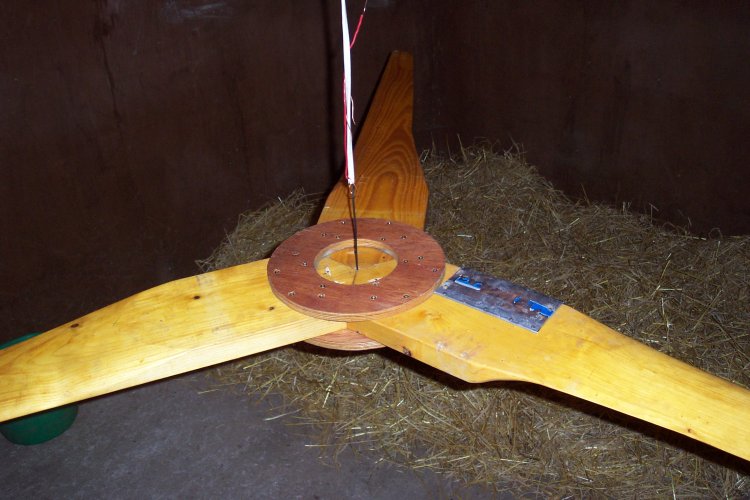

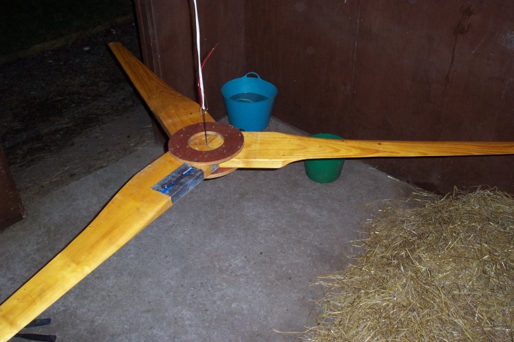

I first balanced the blades by hanging them from a thin wire. The amount of lead you can see on one blade shows how much wood can vary in weight even if all the blades come from the one plank. I guess I should have weighed them before I started carving! To rub salt in I actually made four blades from the one plank but ended up with two heavy and two light. Go figure!!!
I balanced them again when on the alternator as I was a bit concerned I might still get an imbalence when they spin but all seems ok so far.

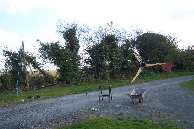

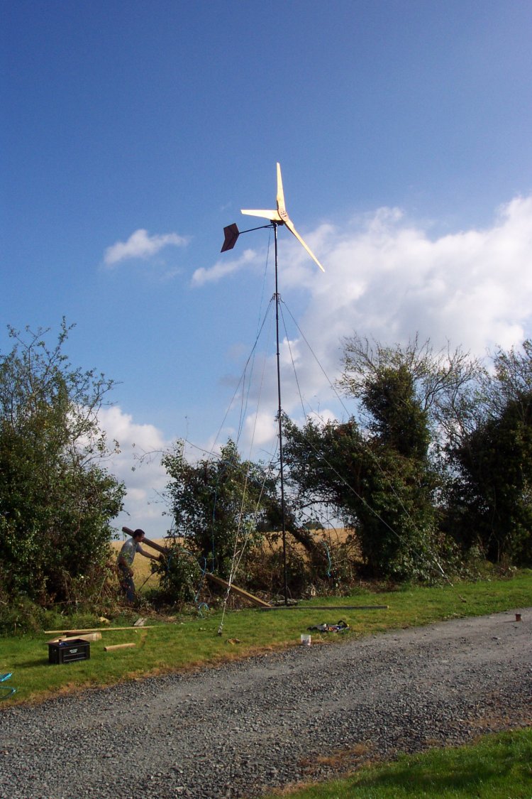

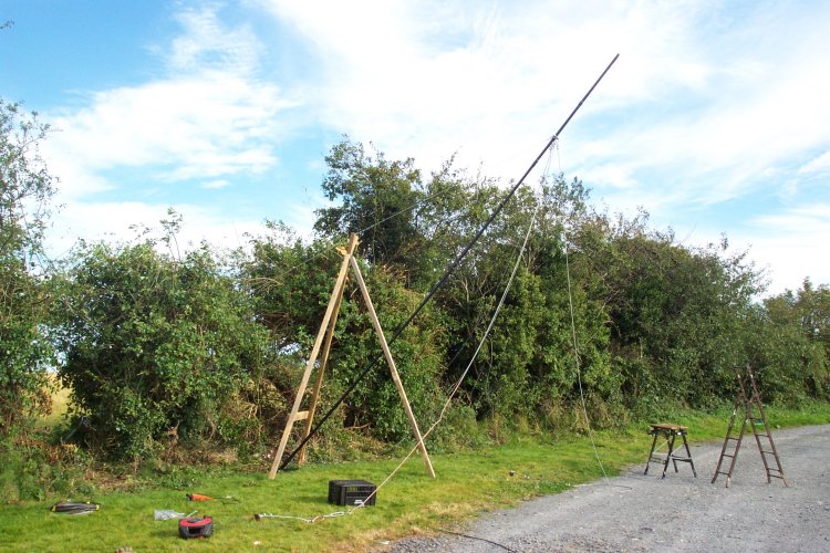

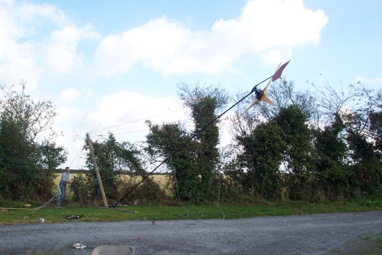

This is a test raising of the tower. As you can see I made an 'A' frame which might have worked ok with a pulley at the top but was part of the problem which caused my first attempt to fail.

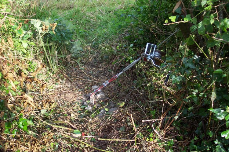

This was the other reason, the winch was not powerful enough. The cables are anchored to a piece of angle iron hammered 5 feet into the ground. Two of them are in very hard ground and are solid enough, the other two have big rocks and a weelbarrow load of concrete poured around the top couple of feet to try and strengthen things up a bit.

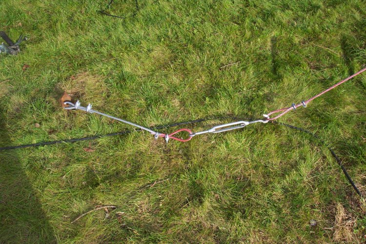

For anyone out there who has not raised a tower before these turnbuckles are not recommended. On one test raising of the tower the cable slipped out of the open ended jaw and almost caused an accident. Thankfully no harm was done and I purchased turnbuckles with a bolt at either end for the live event. I also put another cable grip on each connection.
Up
Up
And away

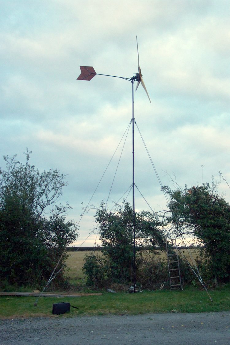

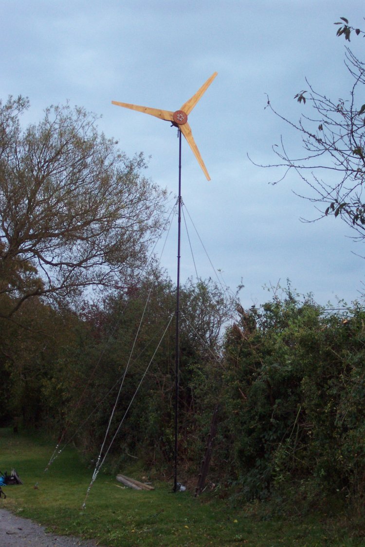

The tower is around 26 feet high and yes I will cut down the hedge around it.

At long last she's flying free!
I first posted about this project almost a year ago (and that was after several months work) so this has been over a year in the makeing, but today I set her free and watched her make good power. I will post pics later but it has been charging a small bank of sla batteries (12 15ah 12V) I found  at work. I brought them home thinking they were good. Unfortunately when I checked them they were only around 5.5V each. I think they must have been disconnected for over a year as they were not required. I figured as they were probably shot anyway I had nothing to lose so I set them up as a 24V bank and connected the turbine. Initially with light winds I saw 4-5 amps and 14V. After around 10 hours the wind picked up a little and I saw peaks of 10 amps at 22V. If my maths is correct that means it was putting out 220 watts in fairly light winds. I know these batteries are not nearly big enough for my system and I have shut the turbine down again for the night but it was great fun to see usable power coming from my own home built wind turbine.
