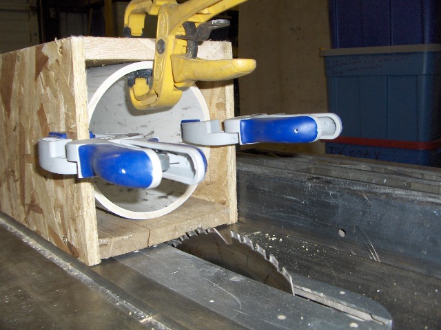

I thought I'd try my hand at the famos Zub-Woofer pipe blades.
My problem was trying to cut a straigt line down the lingth of the pipe.

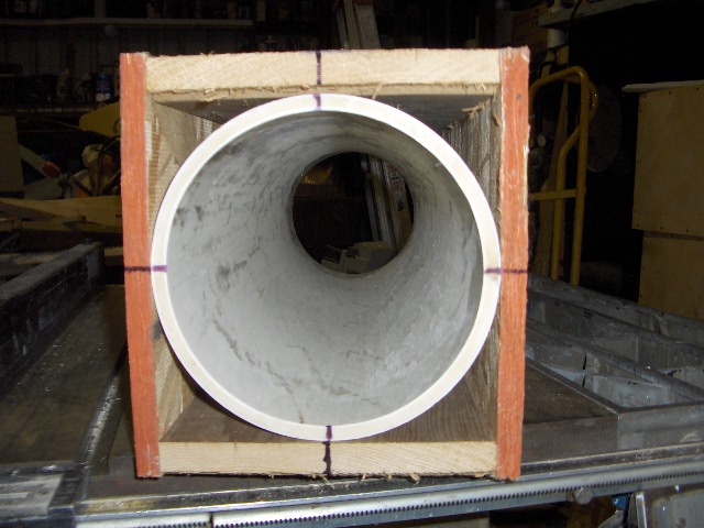

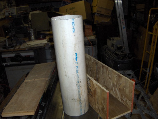

So I built a box of scrap wood that fits tighly around the pipe. Then I deturmind the center of the box and cut the box and the pipe together.
Heres the box and the 6" pipe befor the pipe went into the box.

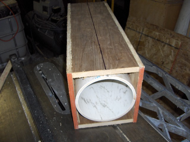

Next the pipe is in the box.

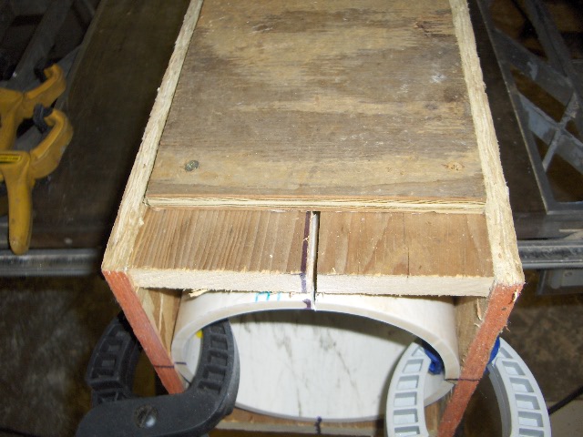

Now the box is marked for cutting although I used the saws fence to set center.

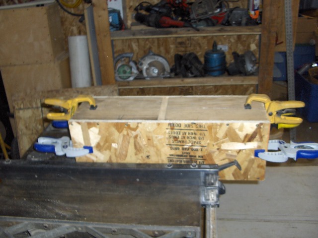

Here I clamped the pipe to the box so it could not move and scew my straight line.
This shows how the saw blade will line up and miss the clamps.
After the cut I secured the cut opening with a scrap of plywood.

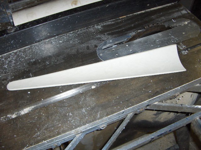

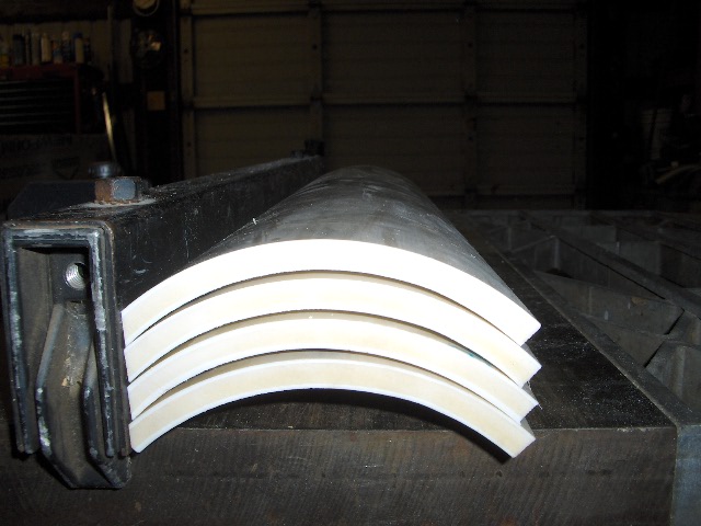

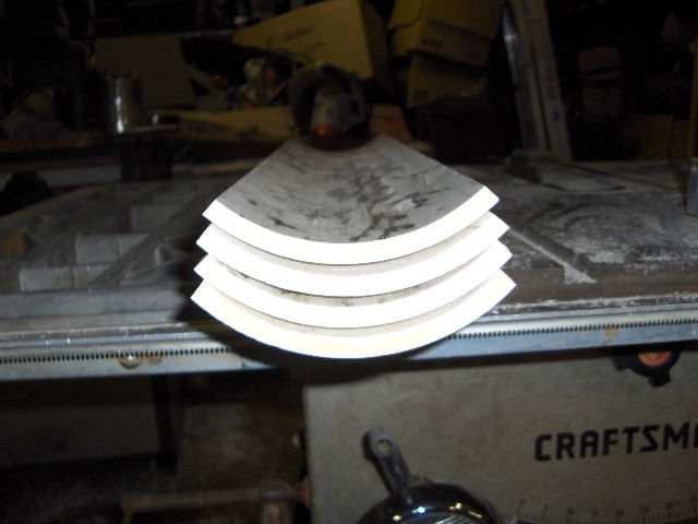

Here are the 4 slices of pipe after the ruff cut.
After the ruff cut I trued the blades to each other by 1 more  pass on the table saw using the fence guid.
Here I'm seting the root to tip tapper angle.

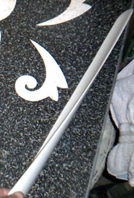

Here is a smaller version I did last week. I did this one free hand. I want this next group to come out more even and matched.

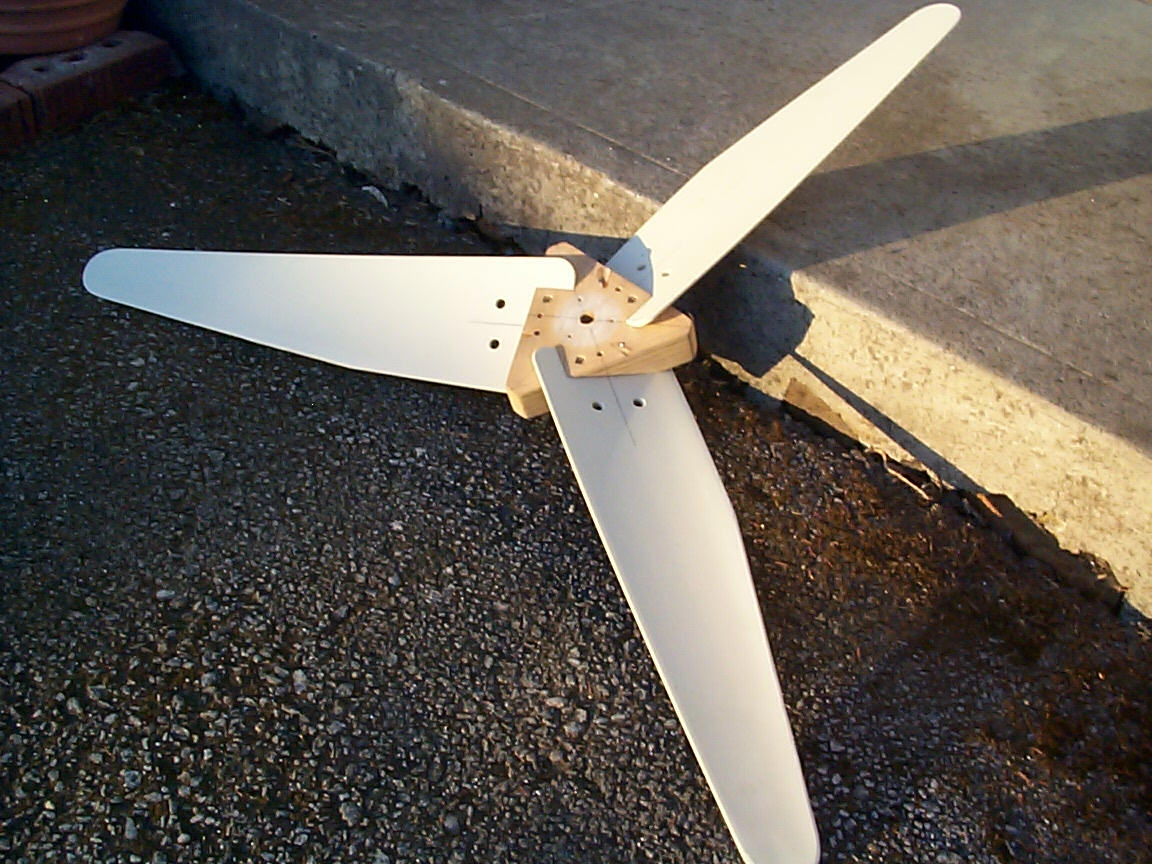

I hope to build the triangle wooden hub this comming week? The root angle looks real good and the tip is allmost flat. Good cup and twist on the blade.  I'm shooting for 48"s tip to tip.

Hi Jerry,
  It's looking good so far.
I took a piece of large packing paper and drew the outline of the blade on the paper.  I cut out the paper blade with scissors, and then used that as a pattern template when I made my blades.  By using the same pattern template for every blade, it helped to insure all the blades were consistent with each other.

  I have made a few of those blades and find that a piece of angle iron layed on the pipe will help get you straight lines and also use the saw blade turned around and spinning backwards as a better way to cut pvc.

A good way to get a straight line on round stock is with steel angle or channel that's good sized .

Never had a band saw wish I did. I cut this on a table saw. I'll be using a wood hub on this one.
I'm not sure what the root angle will be? My 1/4" steel hub I use on the "Jerry Blades" is 23 degrees at the root.

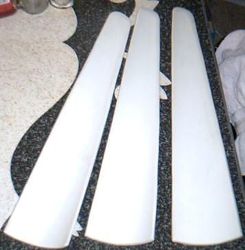

Here is a picture of a simular blade I made 3 years ago. I've been flying this on an Ametek since then. works real well.

I used carbid tip blade in the normal cutting direction. This pipe matireal is 5/16" thick and cut real smooth without chipping.

Your blades look amazingly the same as what I been making and selling on Ebay.
 20" blades in a 3 blade set.  I geuss last of November was last I made any, been busy with other stuff and holidays, but getting back into them soon.
Your pictures are much better than mine, but that last picture of yours in the first post almost looks like one of mine laying there.
