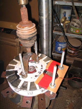

Since I still have my genny down for repairs, I thought I'd try to answer some of my own questions about differences in basic coil configurations. My first two good machines have been wired for 12 volts. This time I'm shooting for a 24 volt machine . I made a contraption to fit into my new drill press that will spin the rotors at 300 rpm. Unfortunately, that's the lowest setting.
I have one test coil of AWG #18 wire, 60 winds. It's mounted on 1/4" plywood and held on with red duck tape.
The first test was conducted with 2) 12" rotors with 12 2"X1"X0.5" magnets. The coil legs did not match the magnets exactly.
In the second test, I used 24 wedge shaped magnets, single rotor, mounted on top of the rotor as the 12 rectangular magnets. Also, I held some laminated steel from vacume motors I had on hand over the center of the coil, then doubled it to see what would occur. That's where "no steel, double steel is from in the chart. Here are the results.
rpm     winds   volts
  1.     60    5.7        no steel    double rotor    2x1x.5 rectangle
  2.     60    5.4        double steel    single rotor    3/16" wedge
  3.     60    5.3        single steel    single rotor    3/16" wedge
  4.     60    3.3        no steel    single rotor    3/16" wedge
The results are probably slightly scewed because I put the wedges on the back of the rotor with the rectangles. It still tends to say the steel laminates are making a big difference in voltage. More tests are needed. While it's down, is there any tests that you would like to see?

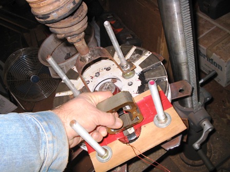

Can we get a closeup of the laminates and can you clarify the dimensions of the laminate pieces compared to the coil and magnets?  The picture seems to show the laminates not fully covering the coil leg but if they do fully cover the magnets then I suppose it might not matter.
« Last Edit: January 07, 2007, 01:02:39 PM by RP »
phil b
  • Posts: 304
Re: Coil Tests
« Reply #2 on: January 07, 2007, 02:03:48 PM »
Hi RP,
The dimensions of the laminates are 1"X3". There are 45 pieces that make up the laminate. When laid across the coil, they cover both legs from side to side and only 1/2 the length of the leg. Two of the laminates do completely cover the coil's length and width. I would have thought that the voltage would be higher with complete coverage. It seems to have little additional effect.
The coils are 1/4" thick. They are wound using a rectangular 2x1x0.5 magnet. Preey much standard.

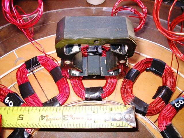

« Reply #3 on: January 07, 2007, 03:10:36 PM »
Phil,
Thanks for the new picture and dimensions.  Huh, I too would've expected it to make a more substantial difference having the laminate cover more of the coil.
I suppose one other test would be to see if the one or two laminates makes a difference in current into a resistive load.  I'm not sure why it would though since if the volts are there, the only other parameter should be the coil resistance which is constant regardless of the laminates.
