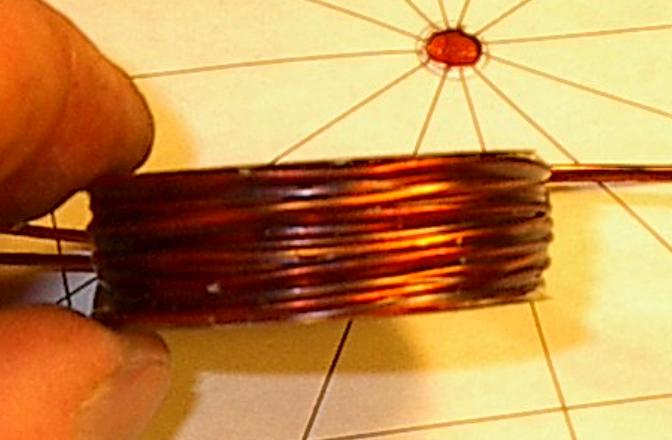

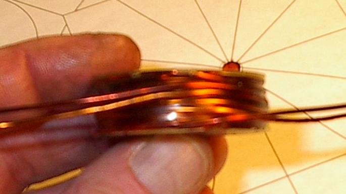

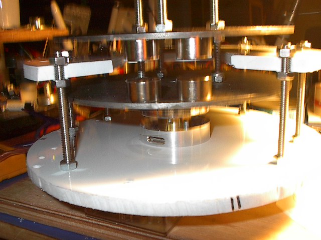

While my new coil is curing , i thought i would update you all on what i've been up to .
the new mini gen is coming along
it is 16 poles 12 coils 7/8" dia x 1/2" neos
i'm using .045"dia wire (two in hand) around 78 effective turns , stator will be 1/2" thick.
i went with two in hand because the resistance will be lower , i'm figuring 0.252 ohms per phase , roughly

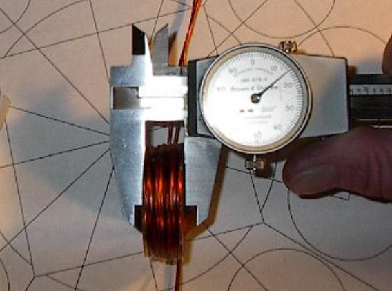

the last picture shows i was off a tad on the width,it varies from 0.507" to 0.514"
« Last Edit: January 12, 2007, 12:07:02 AM by willib »
more pics ?
« Reply #2 on: January 12, 2007, 12:27:05 AM »

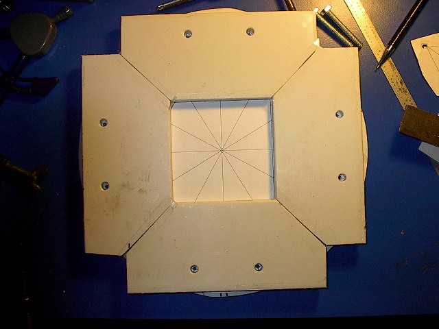

this is its present form minus a segment
the stator is in four segments
if ya want to see something in particular i've got lots of pics
« Last Edit: January 12, 2007, 12:27:05 AM by willib »

Hi Willib

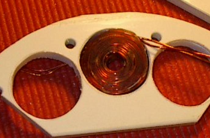

 How are the coils attached to the stator plates?
« Last Edit: January 12, 2007, 01:02:33 PM by vawtman »
Re: more pics ?
« Reply #4 on: January 12, 2007, 04:41:14 PM »
good question !
i had ideas to use the mounting bolts as tiepoints (connections to coils), but now i'm not so sure
since i put the mounts so close to the rotors i had to use stainless bolts and nuts
i've got other pics in my files , way ,way down at the bottom
« Last Edit: January 12, 2007, 04:41:14 PM by willib »

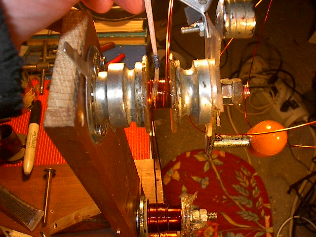

here i am applying resin to the coil , about two layers into the process , i think it was.
i cant believe that i'm still flipflopping on whether i should continue to wind two in hand or not.The resistance will be twice as much ,cuz the coil will be half as thick, 0.250" , but single strand coils are easier to wind, and i could allways double them up , besides then i could put some ferrite in between them if i wanted , i think i just answered my own question Thanks !!
this is the wiring diagram i was proposing,
http://www.otherpower.com/images/scimages/2965/wiring_diagram
this is an early view of the stator, before i cut the perimeter and drilled the last four mounting holes
« Last Edit: January 12, 2007, 09:29:17 PM by willib »

« Reply #6 on: January 12, 2007, 10:32:39 PM »
Although the stainless isn't magnetic it is succeptable to eddy
