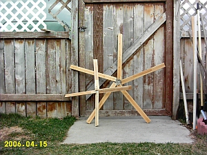

But I did get a couple of hubs done for last weekend and will be trying a set of "trim blades", (set of 4 at 18" each).
Then a set made from a HF "windmill rodent chaser" # 93666 that had the bearing fail and fall out in first half a days worth of testing in backyard before taking it up to the cabin.

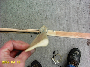

These are 18.75" each three blade pusher type simular to the ceiling fan blades I've used on my Ametek. They are unmodified other than hub to fit garbage unit, square leading and trailing edges, not like the real airfoil profile of the trimblades.

About your trim blades. When I remodeled the retail store I ended up with a PU load of that stuff. I still have it and thought many times about a small constant angle blade.
