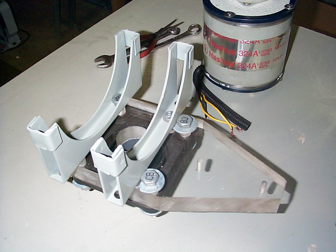

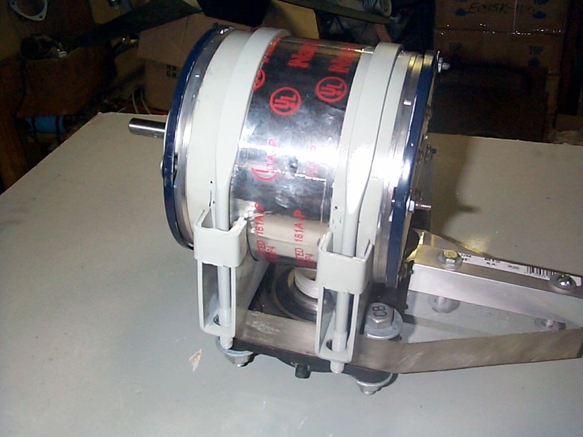

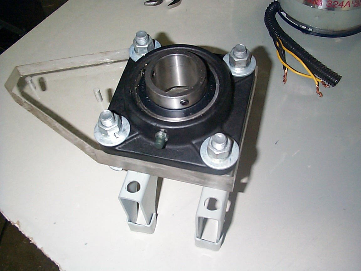

This one was an expiriment that worked very well but was expencive. My new yaw system is very simular but lighter and cheaper. The thick plexi was left over from a show car we did.
Alt in cradel.

Hi Jerry ,interresting stuff
what is the outside dia of that garbogen?
« Last Edit: January 17, 2007, 11:00:47 PM by willib »
Re: Garbogen pix sires #5.
« Reply #2 on: January 17, 2007, 11:13:11 PM »
Hi Willib.
The outside diameter is 6.25". I use the 6" mufler clamps from NAPA as the cradel.
I open them up a littel on a 6" grinder wheel. The 5.5" mufler clamps fits the furnace blower motor perfectly. BTW the stator bore on the Garbogen is 3&5/8"s.
