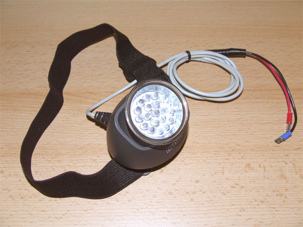

As I promised, I'll post future applications of the LED bulbs I make. Here's a headlamp.
The bulb here is a 6V one, it takes 170mA from the battery. The body of the headlamp is a old mobile phone charger base I drilled so that the bulb base would fit in and then I glued it inside with bicomponent glue. The wire is a mose wire, very flexible. It has 1.4m length and the power connectors at the end are for connecting the headlamp to a small SLA 6V battery I'll carry in my pocket. I decided the biggest battery I could carry in my pocket is a 4Ah one, so that should give me plenty of hours. The small one is a 1,3Ah so it's nothing spectacular.
