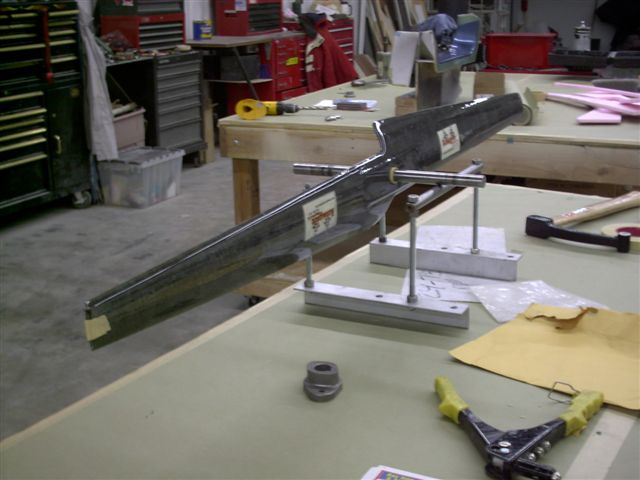

you would be better off making blades from PVC pipe
short fat blades have a lot of drag. a root chord of 6  inches and each blade 2 to 2.5 foot long. wit a tip chord of 1.5 to 2 inches
Look into my files and you will see some blades i made from fiberglass. they work very well and you can make the same thing from PVC pipe

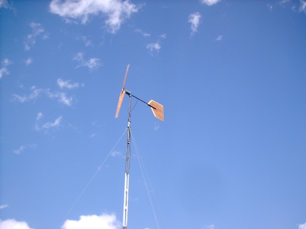

I'm in the prosess of trying my hand at the PVC pipe blades. Today I assembled a 4ft set.
This first blade set is made from 6" diameter 1/16" thin wall pipe. I'm using a hub made from 2 pices of 3/4" plywood laminated for a 1.5" thickness.
The hub is tryangle shaped. I used an 1/8" wood cutting blade on my Roto Zip with the circal cutting atachment set at 6" diameter. I cut a groove on the side faces of the tryangle to set the blades into. Then I drilled a screw through the hub and blade to secure the blade.
This is just a test blade to get the feel for this design. I'm building another the same way but with 6" diameter pipe that has a foam core and is 5/16" thick. The core stuff is very strong.
I'd say with the curve of the pipe it may be stronger then wood.
After I finished the thin blade I took it outside. At this point there no shaft hole yet, just the 1/4" hole in the center. I put a bolt through the hole.
There just a very slight wind 2 to 4 mph maybe. The blade began to spin to a point I was getting a littel nervus.
Its 28 degrees at the root and just a few degrees at the tip. I think the cup of the blade at the root makes for good startup tourque and the small tip zings through the air with the greatest of ease.
Here a couple pictures.
« Last Edit: January 31, 2007, 10:03:03 PM by Jerry »

here is a photo of the blade. the square tips are a bit noise in high winds so a round tip chord is much better
this blade was made from fiberglass foam and carbon fiber.
« Last Edit: February 01, 2007, 09:49:32 AM by luckeydog »

wrong photo here is the correct one ..... wish we could edit thees postings.

That's a really nice looking blade....  the one you made from plywood...didn't look too bad either.
        ( :>) Norm.
« Last Edit: February 01, 2007, 02:55:03 PM by Norm »

the one made from plywood ended up breaking in some 60+ mph winds. I don't recommend plywood. it was an experiment that did not pan out. but the fiberglass ones did much better than I expected. I was seeing 180 watts out of an Ametek 50 vdc motor.
 when I get my website in full swing
I will post the entire process  building a quality fiberglass carbon fiber blade.
« Last Edit: February 01, 2007, 11:28:38 PM by luckeydog »
