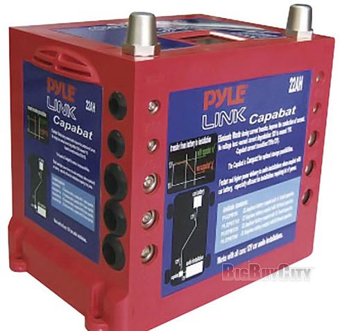

i found this on ebay
22Ah out of a supercap
truely awesome
its 10 Farads BTW
$170 ,with shipping is still a little steep for me though .
it can handle 24V surges , it says.
there are others that are built for 24V continious.
just windowshopping i suppose

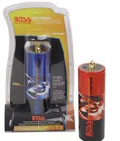

these look cool
they dont have any bells or whistles , but were just $23 apiece
two 1 Farad caps for less than the price of one at pepboys
bells and whistles can be two built in digital meters Volts and Amps , a built in relay, and miss connection protection

  It actually has a 22ah battery inside with a bank of small capacitors making up something like 3-6 farad depending on the model.  Their counting the battery as part of the capacitance.   Kind of pricey for what it is... battery in a fancy case.
« Last Edit: February 03, 2007, 07:37:14 AM by windstuffnow »
Re: Pyle capacitor
« Reply #3 on: February 03, 2007, 08:31:41 AM »
thanks Ed for setting me right , i would have been real dissappointed , i was wondering why their 6F, 10F, and 25F battery caps were all 22AH.
